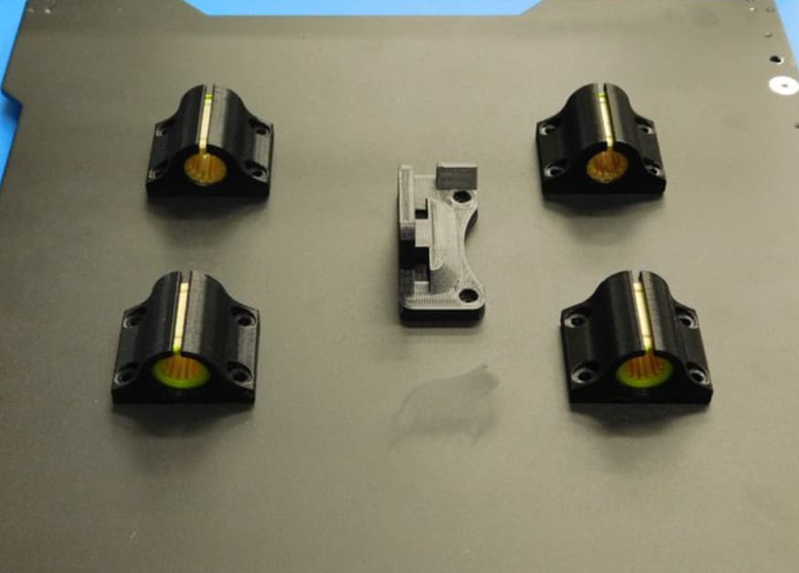

If I were to say there’s any worthwhile place to shim, it would be between the metal Y axis bearing holders and the plate:
Those are printed pieces, and there’s likely some variation in them. Shimming at that location will actually tilt the bed instead of trying to fake the numbers by changing the washer-to-surface distance.
I can tell you from experience, it’s super fiddly to get 4 or 8 washer/shims in between the printed part and the bottom of the build plate frame. And that was with a much smaller Mini 2.
Definitely tough to try and get it near mechanical zero on a machine that wasn’t really designed to be mechanically zeroed. Lulzbot definitely put their trust in the four-washer leveling and assembly quality to make up for any variations.
Handling during shipping and the realities of plastic on nozzles and how bad that affects electrical connections really should have been seen and better dealt with.
