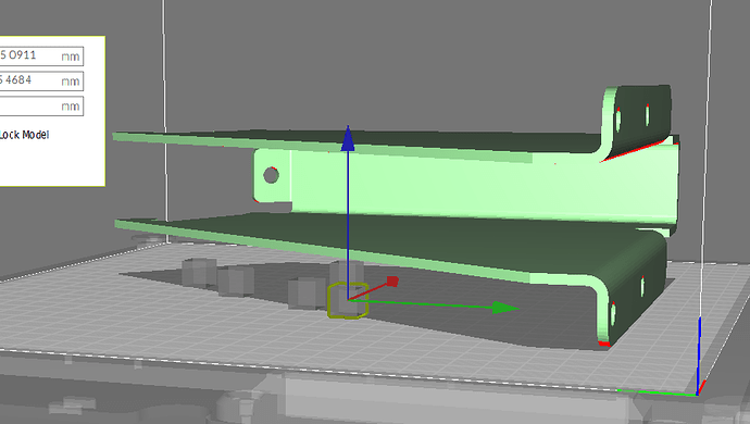

I just updated from 3.2.27 to 3.6.8 and tried to use Support Blocker/Custom Supports, but it doesn’t seem to work at all.
When I click an area of the model to add a block to, the block just falls to the buildplate and doesn’t do anything.
Turn off the option that automatically lowers the model to the build plate:
Preferences > Configure Cura > Viewport Behavior > Automatically drop models…
That did the trick, thanks!
