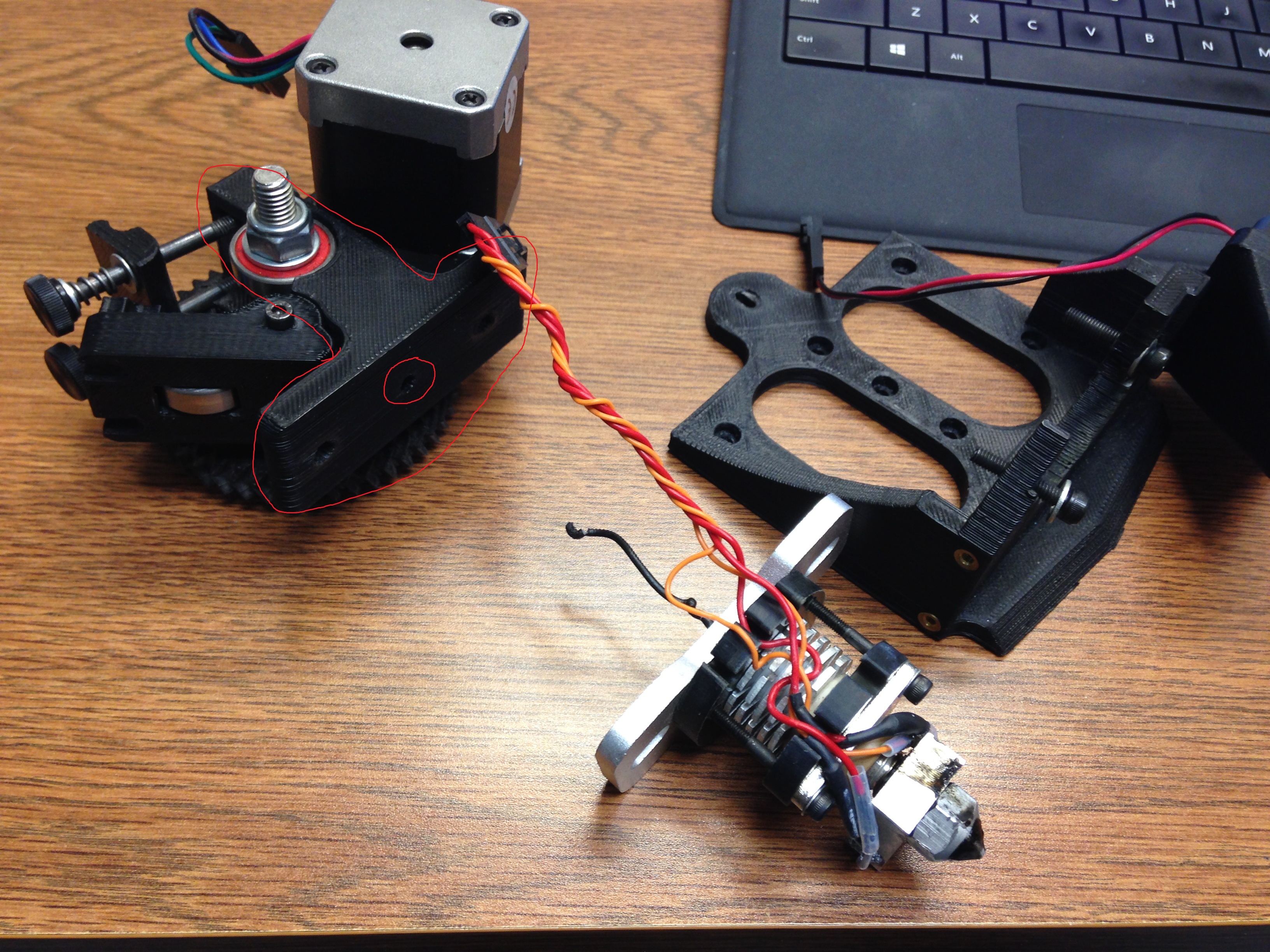

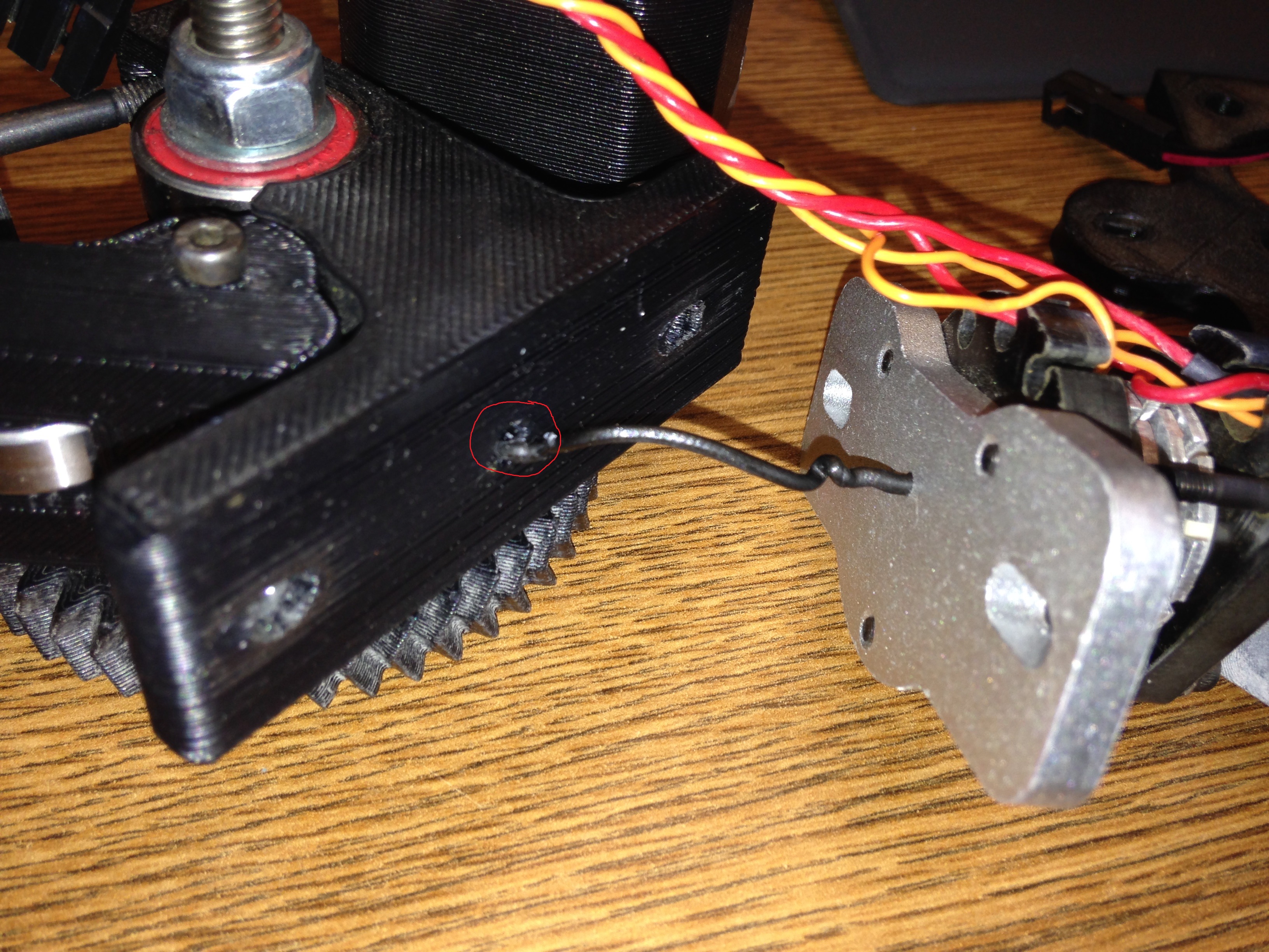

If I may suggest the true nature of the problem is the Direct Drive mount. This plastic piece has a hollow tube that is wide enough for a 3mm filament to pass through. So even if you replace your hot end with a 1.75mm one you still have a tube that is wide enough to allow the filament to bend and kink. Please look at the pictures I uploaded. The first image shows the piece I am referring to. The second image demonstrates the problem.
So what we need to do is modify this piece and print a replacement.
