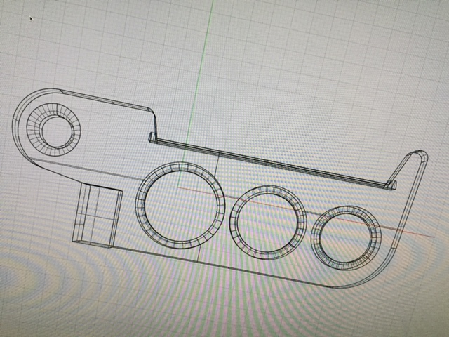

Not another boring filament spool holder design. Not sure if i should be, but I’m kinda proud of this one

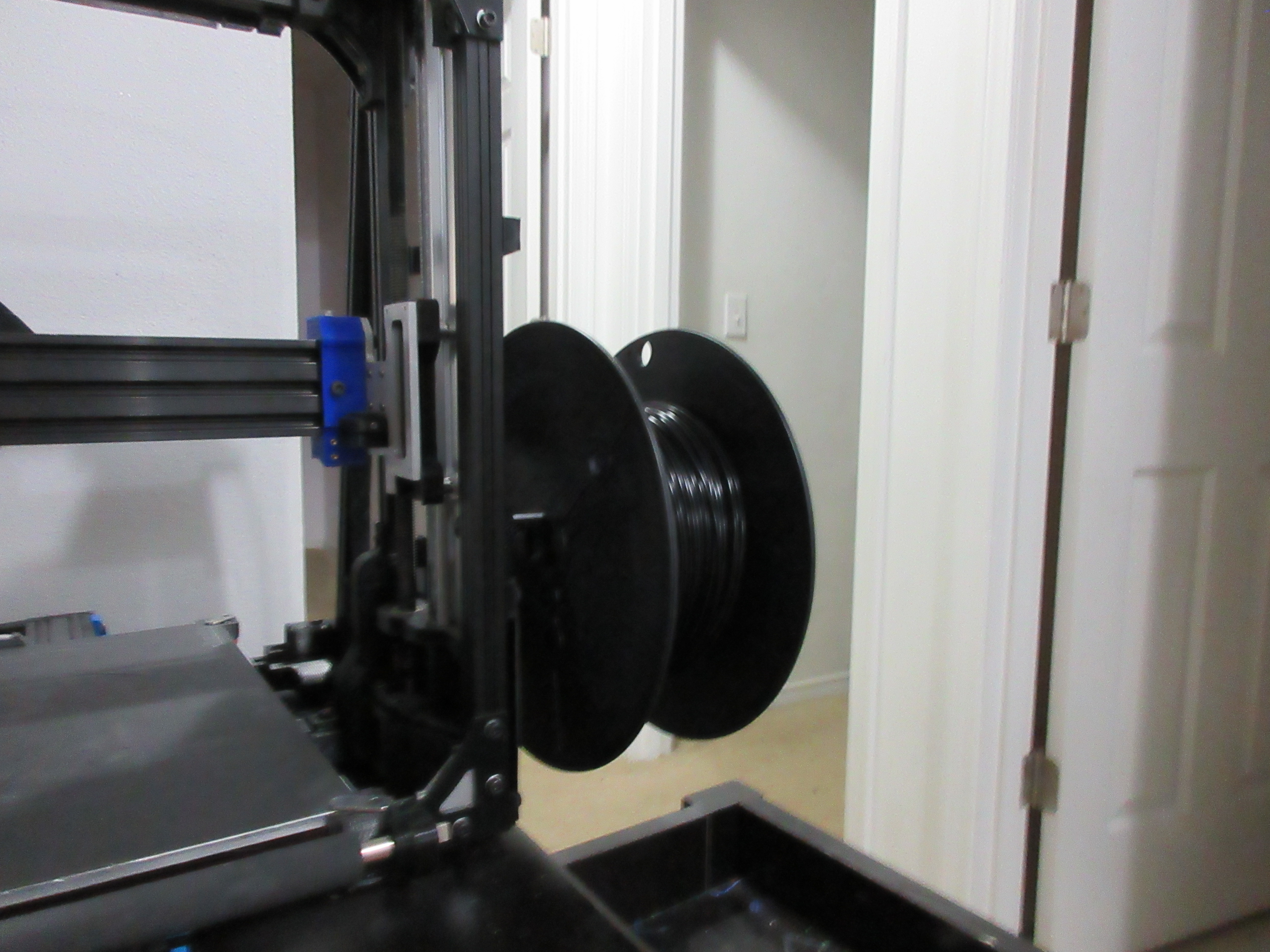

I took the stock Lulzbot arm design and shortened it for NGen spools. I added a groove on the top edge and a little indention on either vertical so that a 1/2 round of teflon could sit on the top of the arm. So… without bearings… it’s super slippery… and works like a dream.
You can find the .STL on thingiverse under Monsterequipped

They really do work well… no more jerky pulling or squeaking from the stock arm.
Anyone want to make one I have the short and long arm STL file posted here https://www.thingiverse.com/thing:2707372

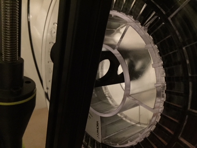

think i have improved the large spool arm so it can hold the 5 pound spool without being nervous about it. comparison shot.
