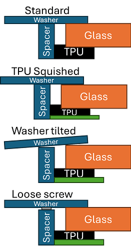

Follow up question. Is there a way to change the Taz 6 bed so it has some adjustment capability for leveling? If I level my Y axis rods to the bed the Z threads squeal when going up and down which makes me think they are not at 90° to one another. So then the bed would need to be leveled some.
Could be the entire frame is out of square from not being on a level surface.
You can do a little bit of adjusting by shimming under the bed, but the way the washers are designed, the bed rests on the TPU pads, then the washers are tensioned down upon the spacers, which squishes the bed into the TPU. Adding shims will either be small enough that the TPU just absorbs the height increase, resulting in no change in height, or may be big enough that the washer no longer sits flat on the glass, or if you leave the screw loose (not recommended) you can get the washer flat, leading to a physical change at the expense of losing tension over time.
To do actual physical height change, you need a shim that goes under the TPU and the spacer. I had one that I used for a little while, but just ended up going with BLTouch.

So if you’re running BLTouch now, you don’t need to worry about the washer calibration. You can loosen the washers, slip a shim between the TPU and glass. Since looseness of the washers won’t affect the Z offset between corners, you only need to check that the screws aren’t getting too loose occasionally. It’s what I did to level out my bed after moving to BLTouch.
Thanks again. I will give that a try.
