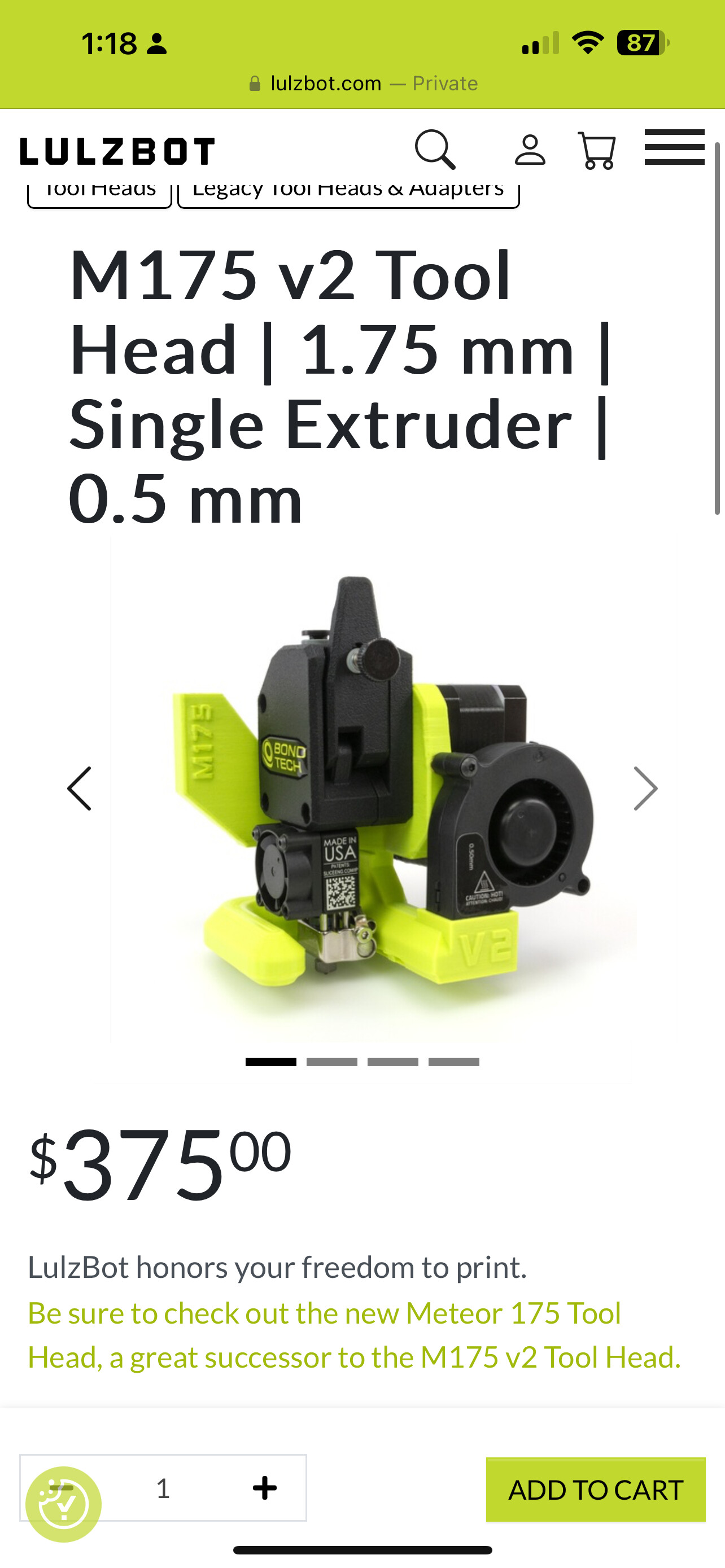

(Updated) Correct me if I am wrong but this looks like M175 V2 toolhead just for reference in case anyone had that same experience so to the best of my knowledge to help you & others that’s one of the few things I personally confuse with a h175 which I was corrected about the h175
Consider yourself corrected. There’s one photo and it’s of a Titan Aero’s tension adjustment knob.
The hemera extruder used in the H175 adjusts with a knob on the top, and has no indicator nut. It has a spring perpendicular to the tension arm, not an inline spring like the Aero uses. The Hemera is not used in the pro dual extruder.
There’s some vague resemblance in that they both have knobs and springs, but no, it’s not an M175v2. I would have no reason to use a picture of it when the discussion is about the Pro Dual extruder.

I only meant the tension set is similar correct me if I’m wrong

Kind sir please update your reply
That’s where I got confused
