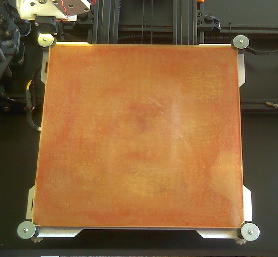

And here is a digital picture of the assembly

It’s obvious that the glass performs quite poorly with regard to the heat surface distribution, especially with the center, the top-left quadrant and all the corners.

A void where the power cord is going into the bed is normal, but your upper left corner should be more or less even with the others I would think.
