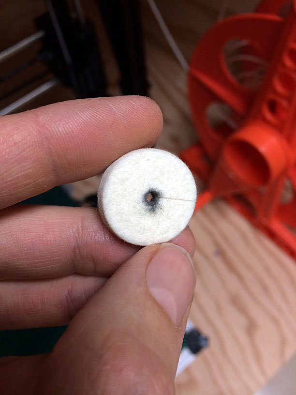

During my first attempt earlier this month of transferring ABS to the orange reel I only got about 25% of it transferred before the unreeled part started to get too tangled. Some of the abs came in contact with the floor and couches, etc. I noticed some small pieces of hair and dust stuck to it. So I put this small felt punching around the filament to wipe it as it goes into the printer. I was surprised how much it cleaned off, and it was only 25% of the full roll. I am also guessing not all that dirt was from me. I am curious what a new roll looks like that has not come in contact with much. If any of you have a piano technician, the small felt piece is called a “felt front rail punching.” They sometimes have some extra on hand, they come in different colors, though I would go for the white ones so you can see how much dirt it removes.
