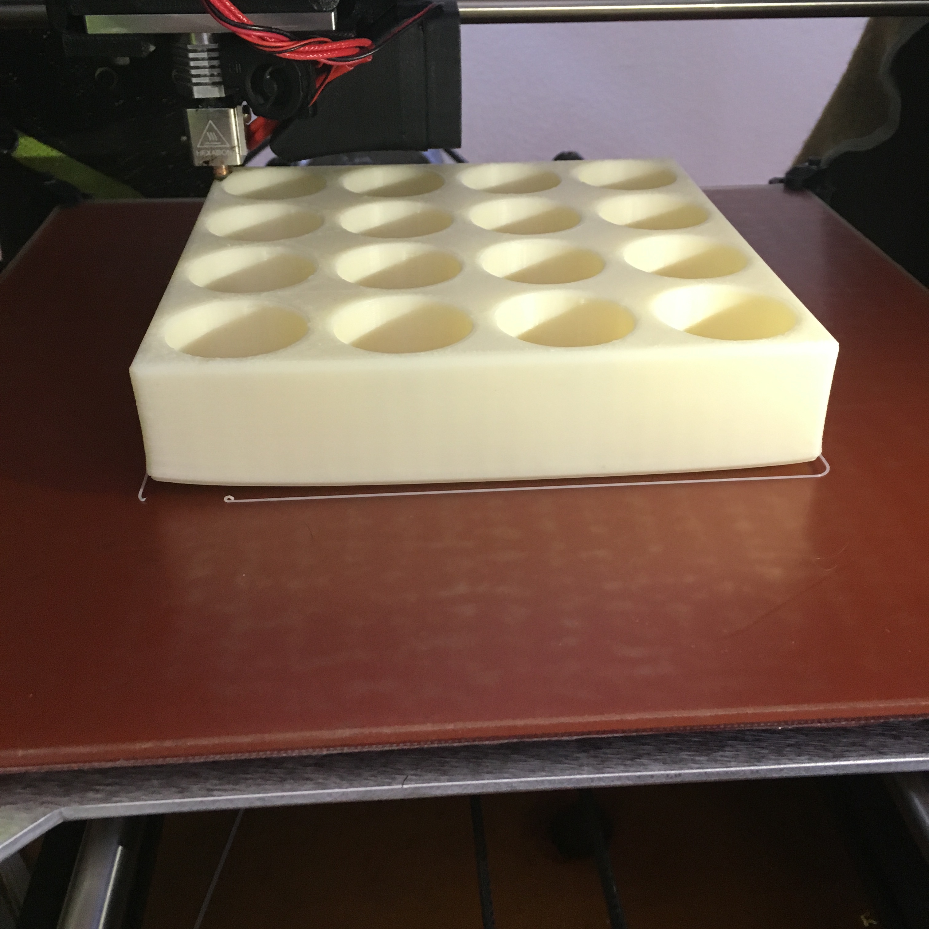

However, I’ve been trying to print a 6x6 piece - and I just can’t keep the ends from eventually coming up sometime during the print. I’ve tried Abs and pla - still same results.
I have a Taz5 with the pei bed - i’ve been using the Cura stock setting for standard definition print for each filament. I have leveled the bed using a dial indicator - however with all 4 corners zero’d there seems to be bow in the center of the bed that goes from front to back. The bow pops up by about .010-.012". or .25-.30mm (i’m still trying to get the metric lingo down). - I put a straight edge on the bed, and can’t really see it, though this should be easy to see. So maybe it’s the X axis bowing in the middle or the slop that I do have in the x axis bearings.
I set my z height off the center of the bed, which is the highest height. It’s set about .005" or .13mm. I ran the dial indicator around what would roughly be the 4 outer corners of the 6" square to see the bed height difference and it’s about .005" or .13mm lower than the center of the bed at all 4 corners of the 6".
I’m kind of at a loss, I’d like to figure it out, as I have a ton of things I would like to make that will even be bigger than the 6" square I am making now with poor results. Any help or guidance would be appreciated!
I’ll post a pic.

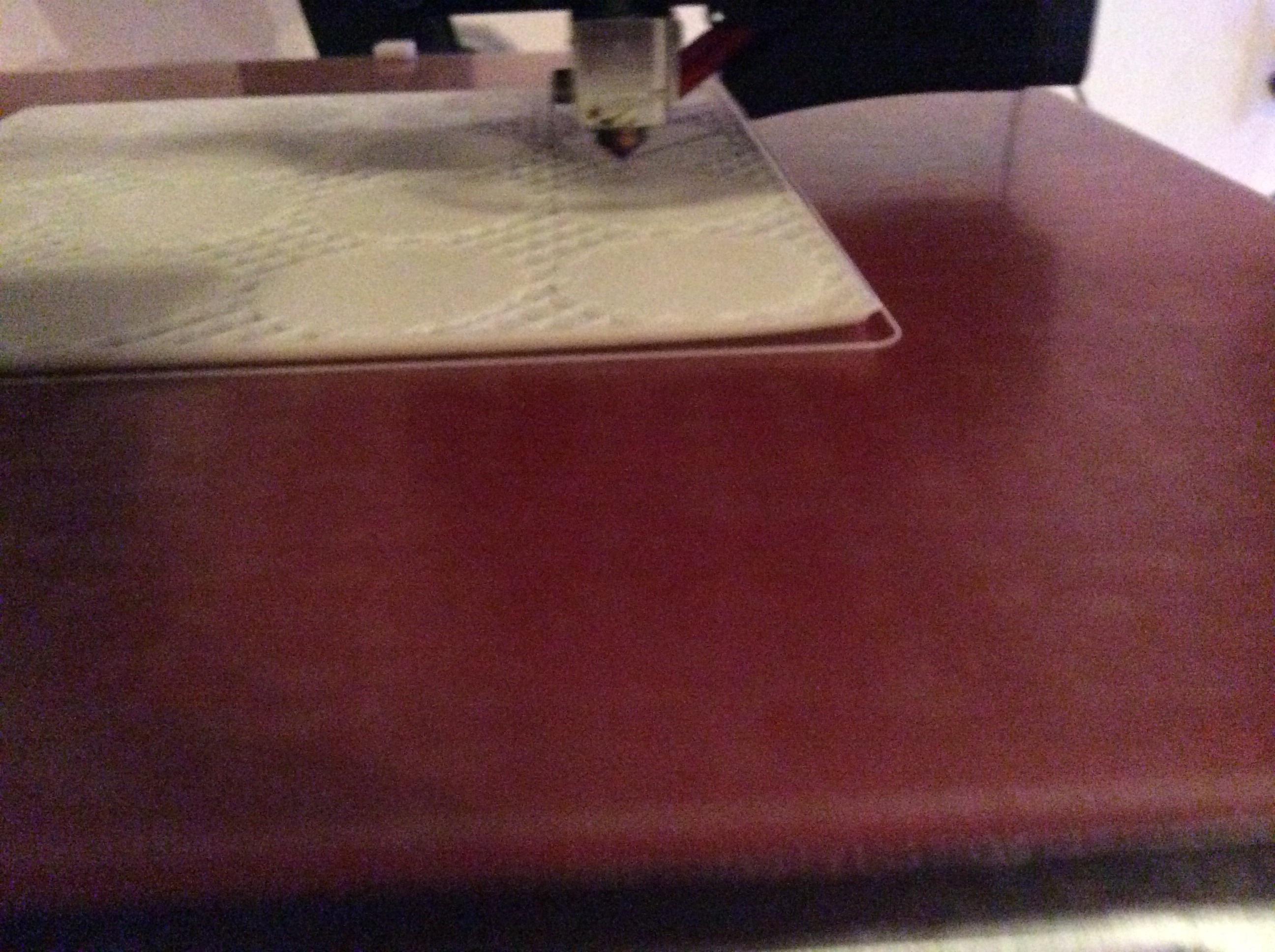

Here is a pic of the print starting to lift. This corner is always the first to lift, and the worst.
This is the part I’m trying to make - I let it run overnight, didnt catch it lifting until it was done in the morning.

There “IS” an apparent bow with the taz, but it isn’t due to the bed flatness. Its actually caused by rod flex. The bed is heavier, but supported at wider points. The carriage is lighter, but acts as a point load, which leads to a .010 ish deflection from midpoint to edge that shows up as an apparent hump. There are modifications you can do to alleviate that later. For now, you want to concentrate on getting a good contact pattern and first layer. For abs in particular, start with 240c for the nozzle temp and. 110c for the bed. You want a 0.40mm or thicker starting layer. If you are too close to the bed, the abs will not bind as well to the pei sheet and it will lift. I am not sure why. The thicker starting layer works better. Bed leveling is key. If a corner is lifting, lower it if the starting layer looks too thin, raise it if it isn’t adhered well.
Run the bedcalibration Gcode multiple times until you get a good contact pattern across the entire print area.
Printing with a 5mm wide brim layer also is a good idea.
In my experience, using less cooling fan will reduce warping.
And lowering your infill percentage should also help, but you may need a few more top layers to bridge the gaps and get a smooth top surface.
I’d expect PLA would give you less warping than ABS. I don’t think I’d even try that size part in ABS without having a heated enclosure (which I don’t have).
But piercet’s certainly right – the very first thing to do is get the first layer stuck down as well as you can.

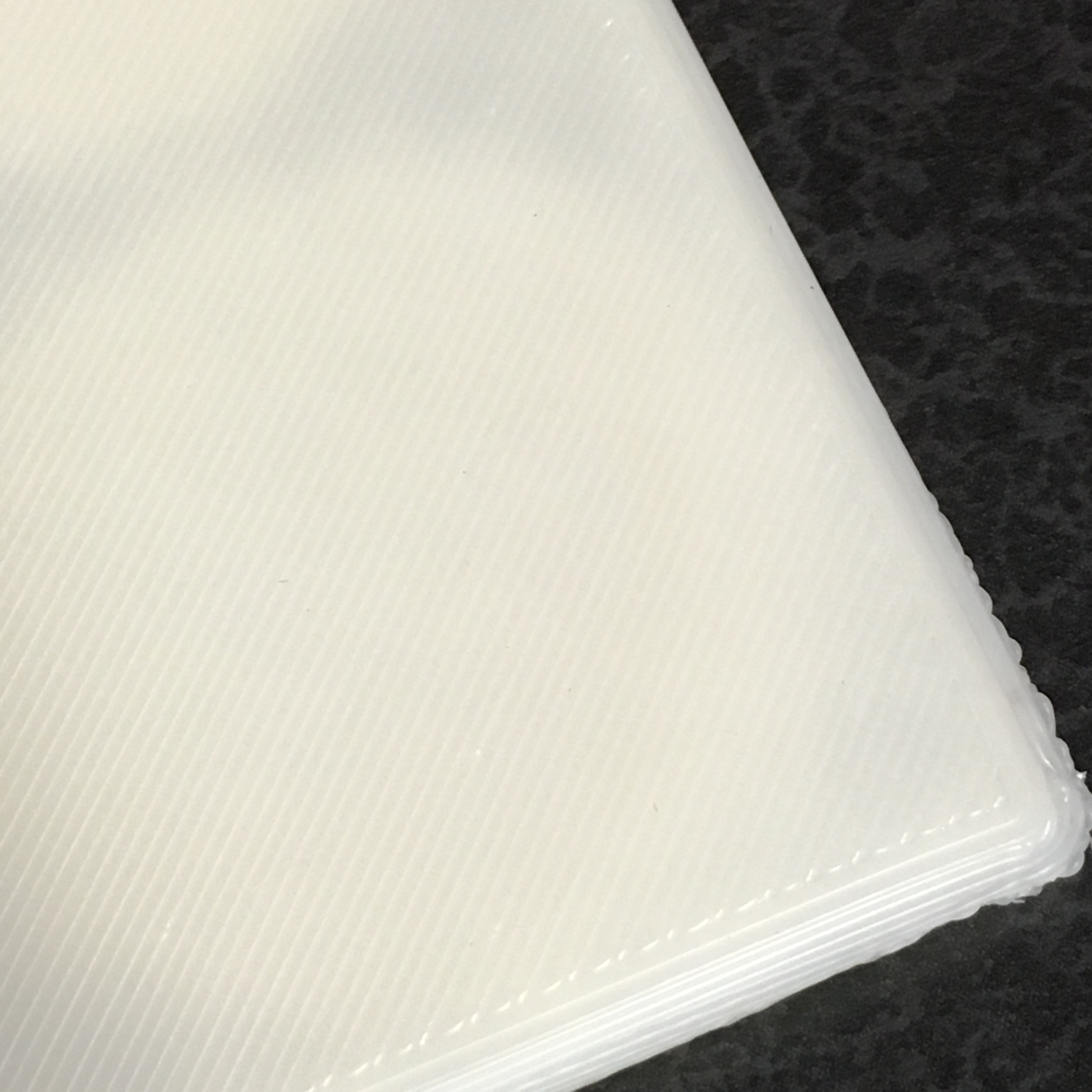

Can you post a pic of the bottom of the print?
Lastly, it could be the PEI. Exhaust the suggestions everyone has provided then call LB support. Another user on the forum had a similar issue, and a replacement bed was “night and day”.

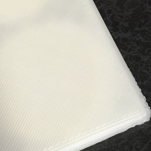

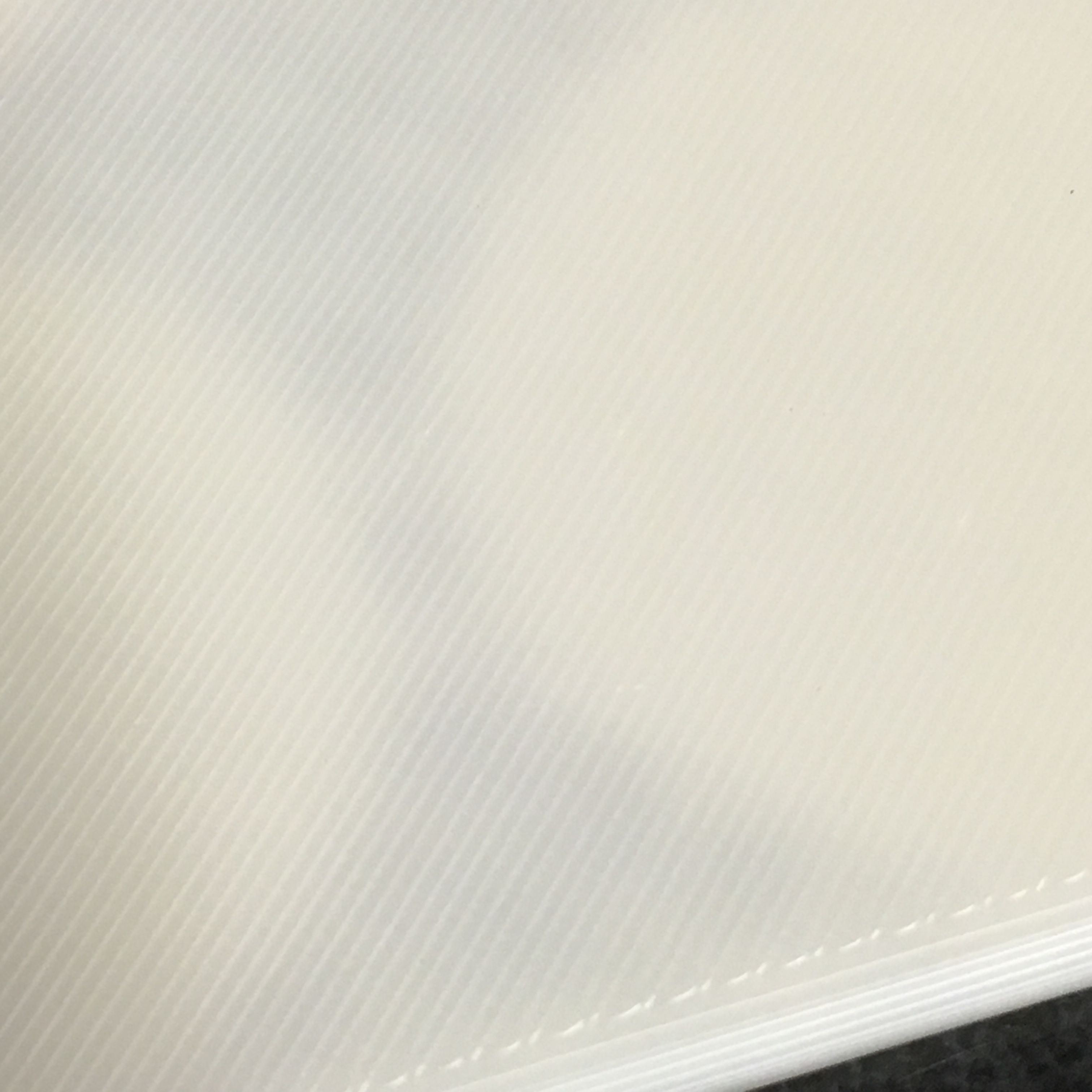

Here are a couple pictures of the underside - this is the abs part that was shown lifting in the first picture.
