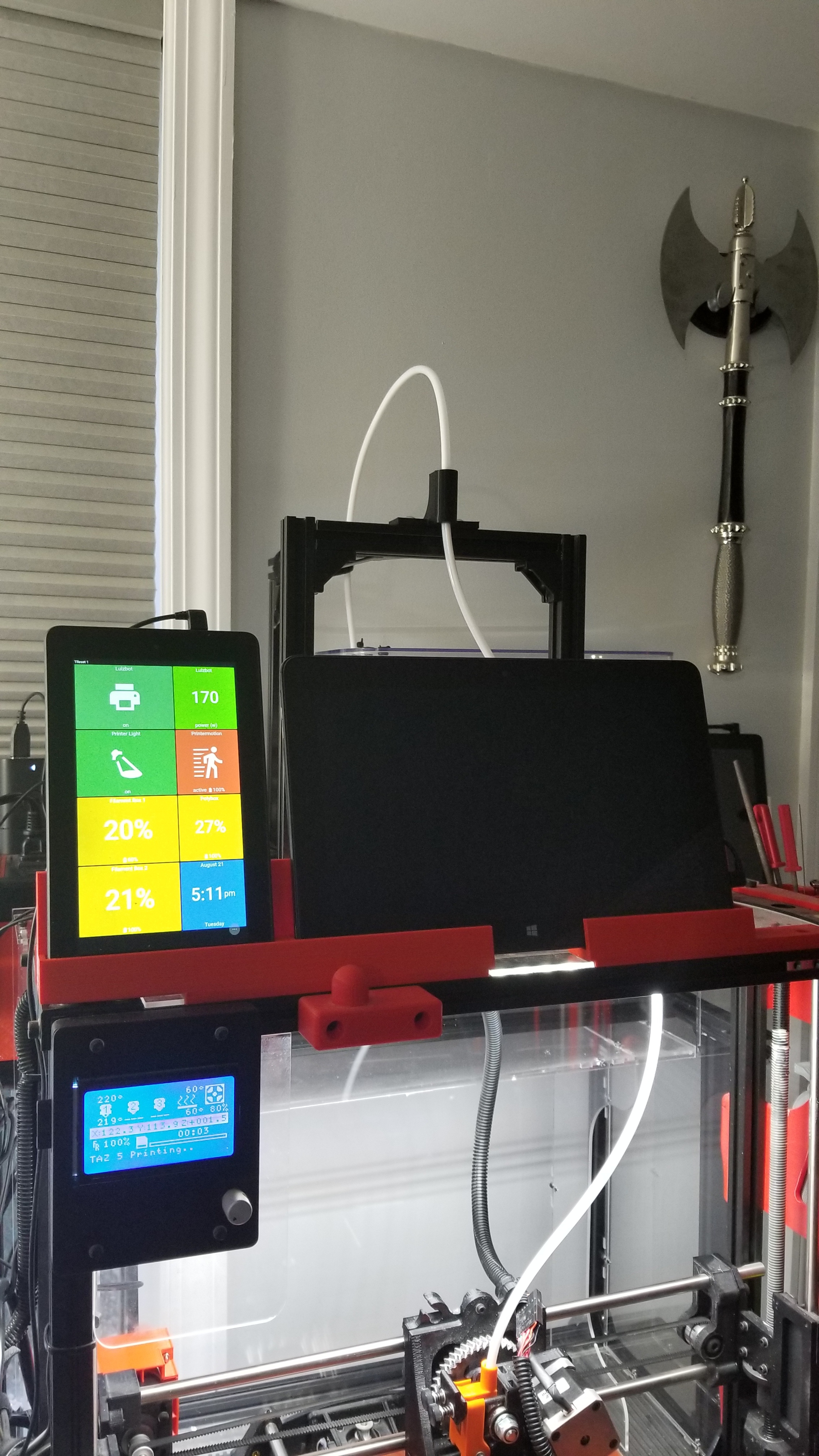

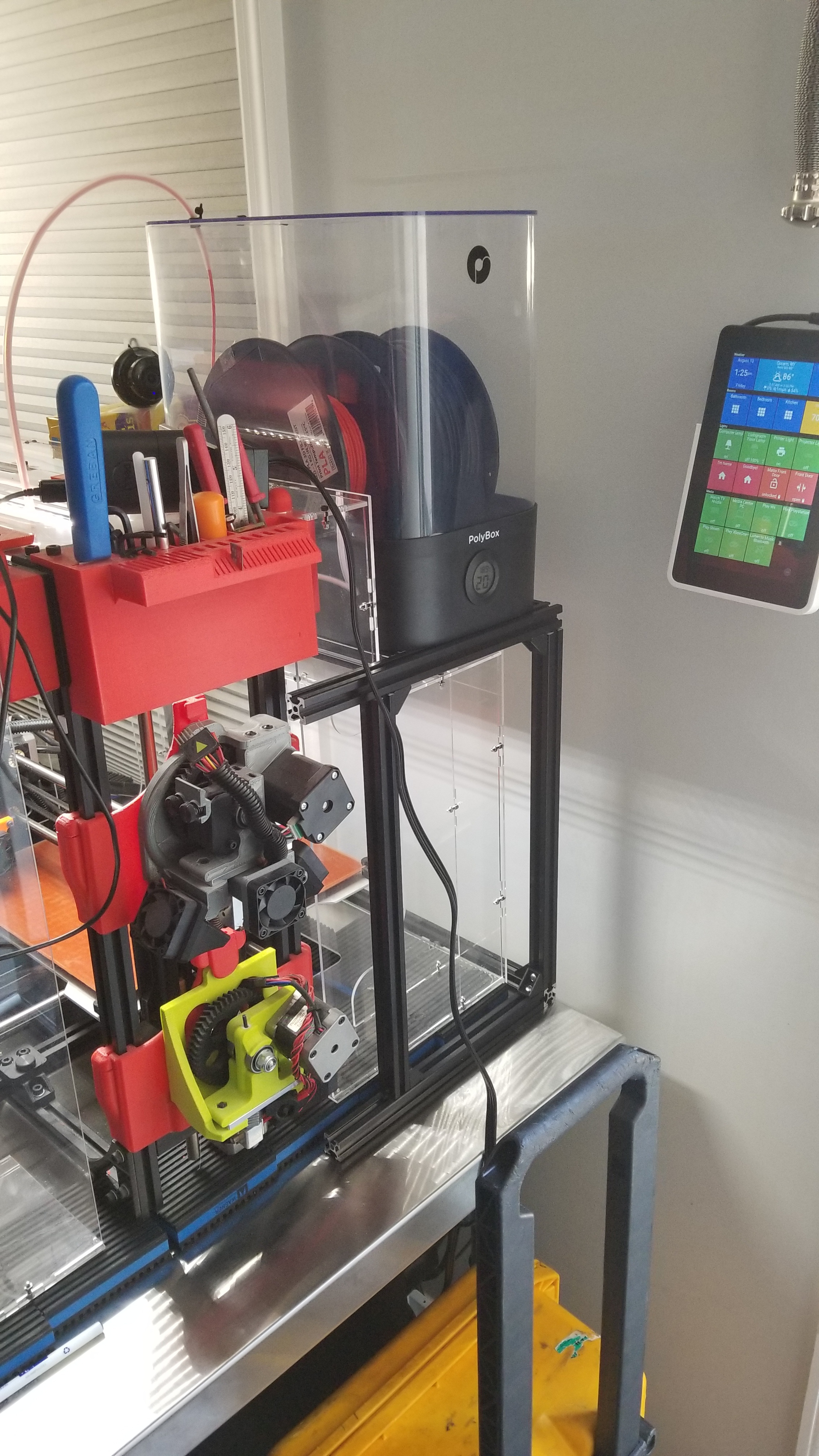

  2. I added a PC tablet mount to the top of the machine. This is for bigger jobs that cant be accomplished thru printdroid. I also added to the left an android tablet. This is for touch screen controls and monitoring. I control printer on/off, printer light on/off. It monitors printer wattage, bed movement, humidity in storage containers, filament humidity with rolls Im printing with. I am happy with this upgrade.

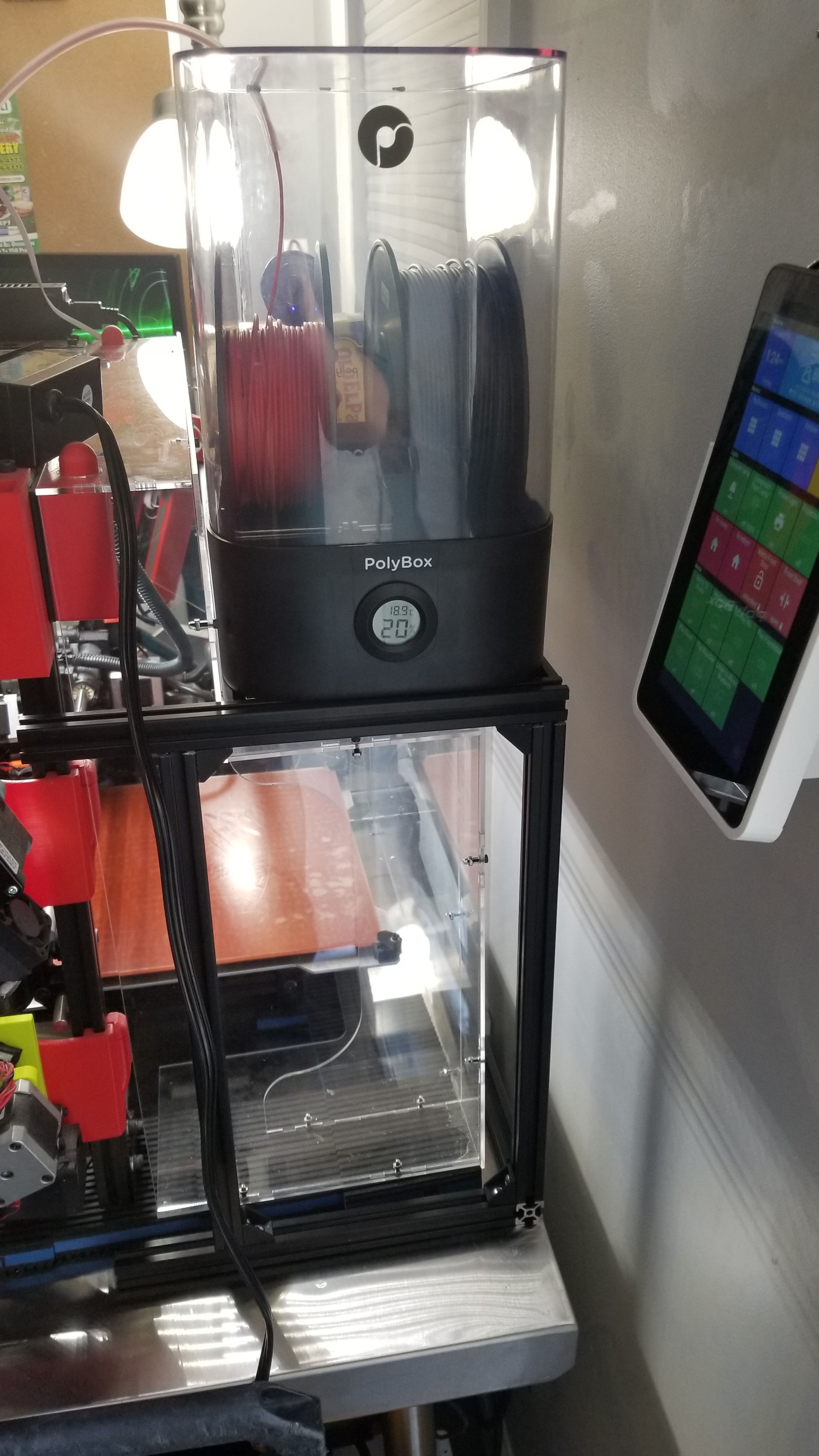

  3. I was having PLA issues with humidity this summer. I built some storage boxes. I purchased a polybox. These have resolved my issues. I have printed solids enclosure so my printers foot print is large already. I didnt want the polybox just on the side taking up more room. I am building a stand to go over the rear enclosure out of 2020. I will also build a box to the left of the polybox for outlets, USB power outlets, raspberry pi.

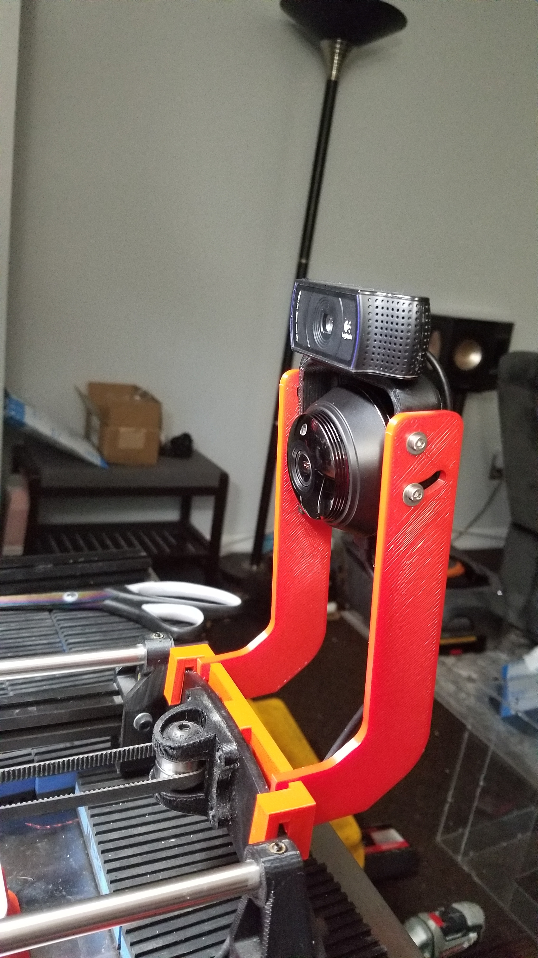

  4. Cameras I monitor my printer via printdroid/octoprint via wifi or vpn. I wanted something fast and not have to be on the VPN I added two IP cameras. One for the Bed the second for filament. I will add a filament sensor to octoprint but I like to see the roll before it gets super low.

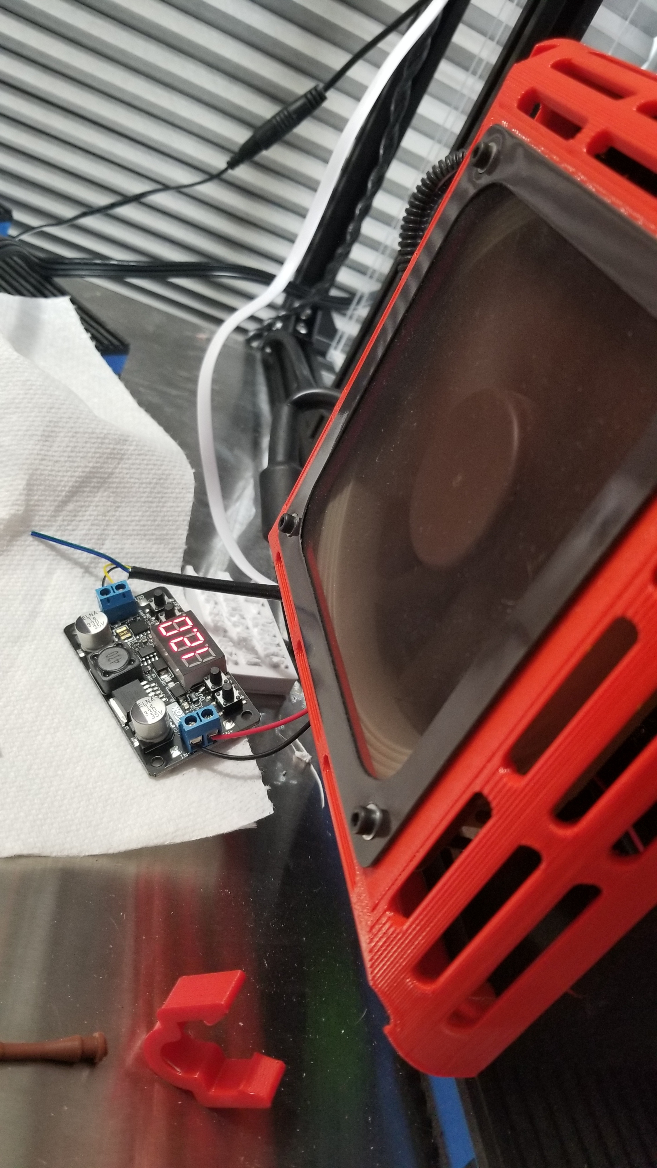

Few more updates. I got rid of the 24v fan and went the buck converter route like others but with a 120 instead of the 80mm. Now the 40mm on the hotend is louder. It seems to still push a decent amount of air.

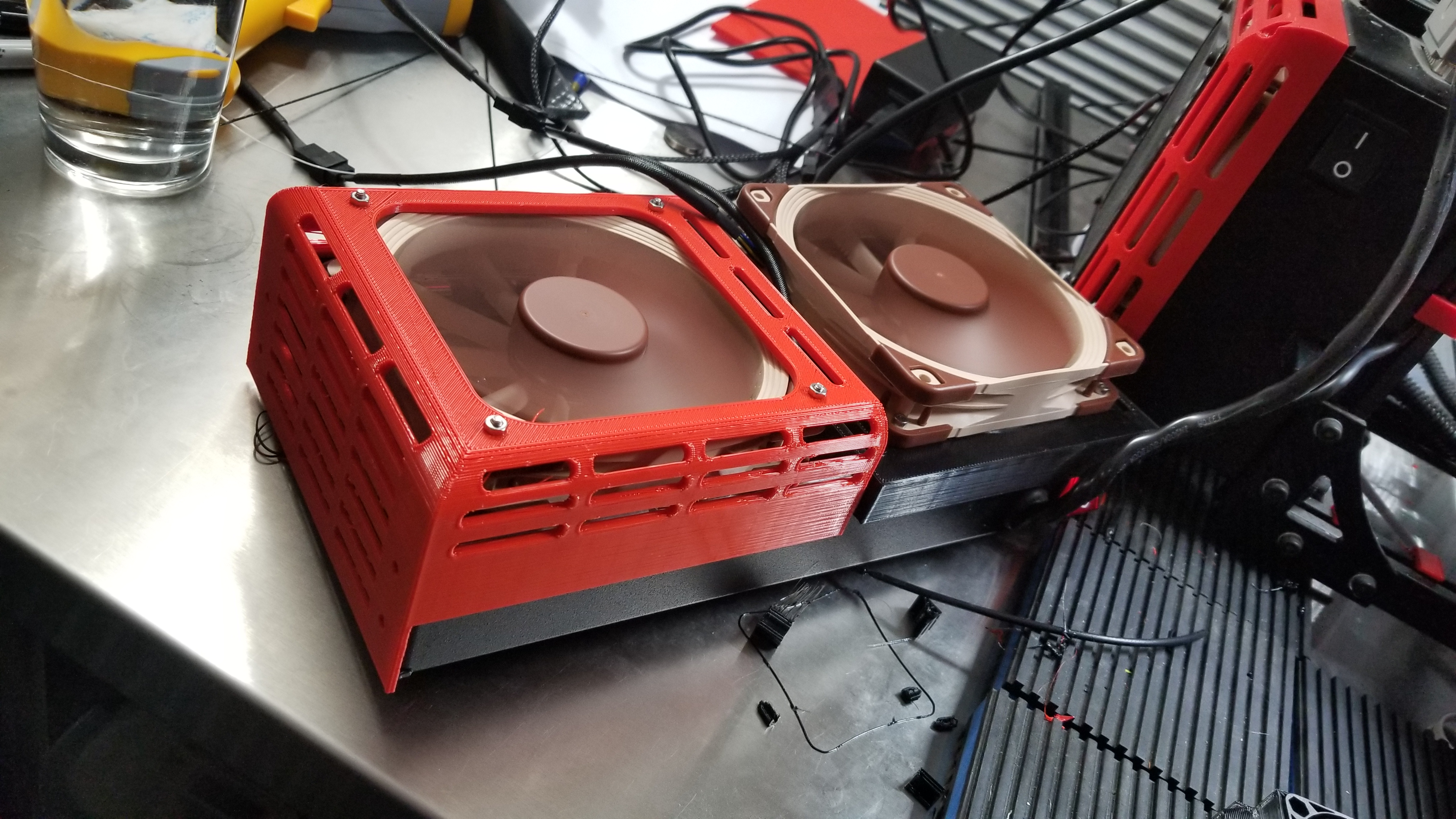

I do have a question hoping someone can chime in. The 500 watt power supply is the loudest thing on my machine now. I have seen that some switch it out for the noctua 40mm. The stock pushes quite a bit of air though way more then the noctua would. I dont think id trust that swap. What about this idea of making a new shroud and mounting two 120mms? I would externally power them. I already have that setup from a tuner build I dont use anymore. Does anyone have any info on the PS? where it gets its readings from/ temps to turn on and off?

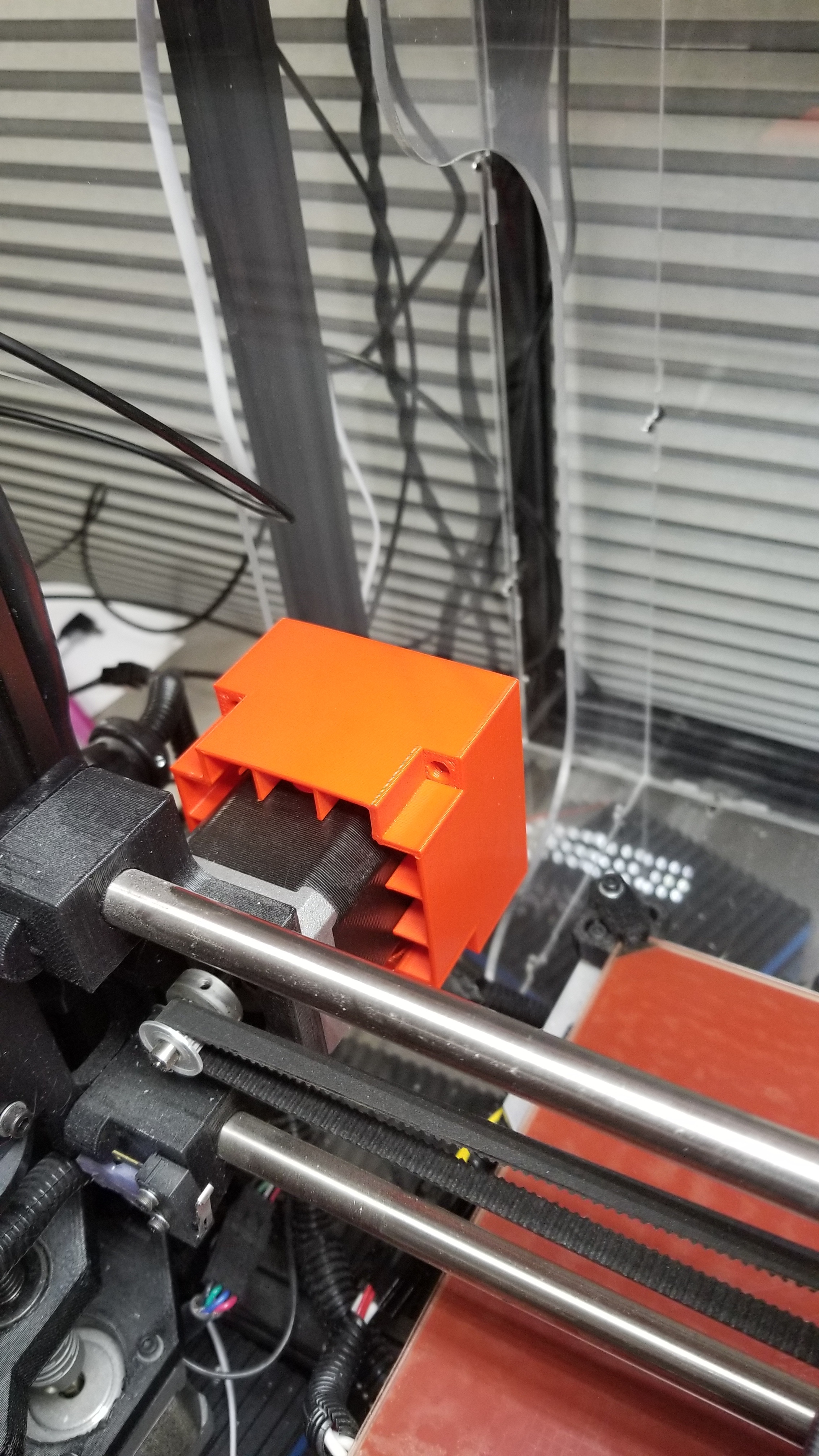

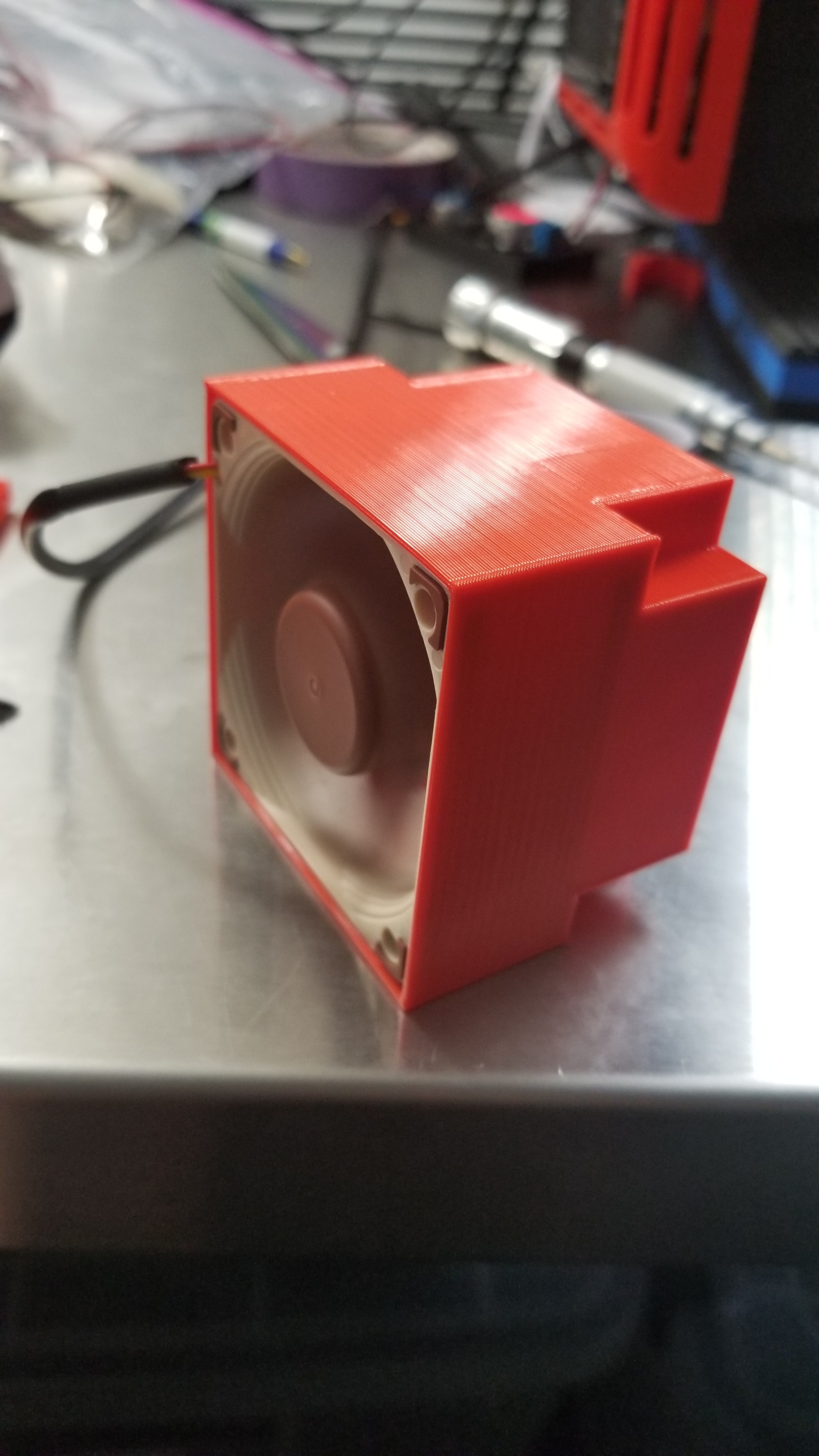

In my quest for cooling and silence though is now the main story. I started to monitor my temps on the stepper motors. X,Y and extruder. My X and Y can hit up to 59c. I know this is within specs but why not get it better. I added a 60mm noctua. Now there cool to the touch. I was actually amazed by this its like there not even on. I did a 9 hr print yesterday success. Proof is below I gotta change my last name to BUNDY

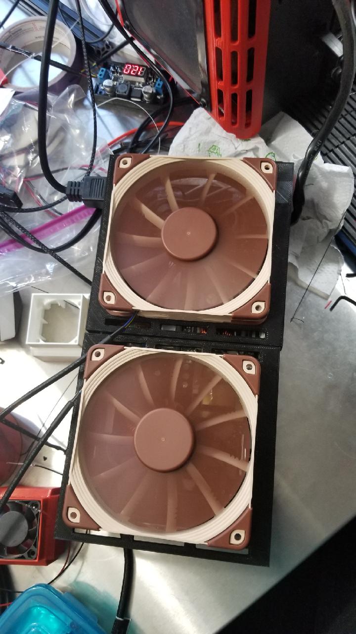

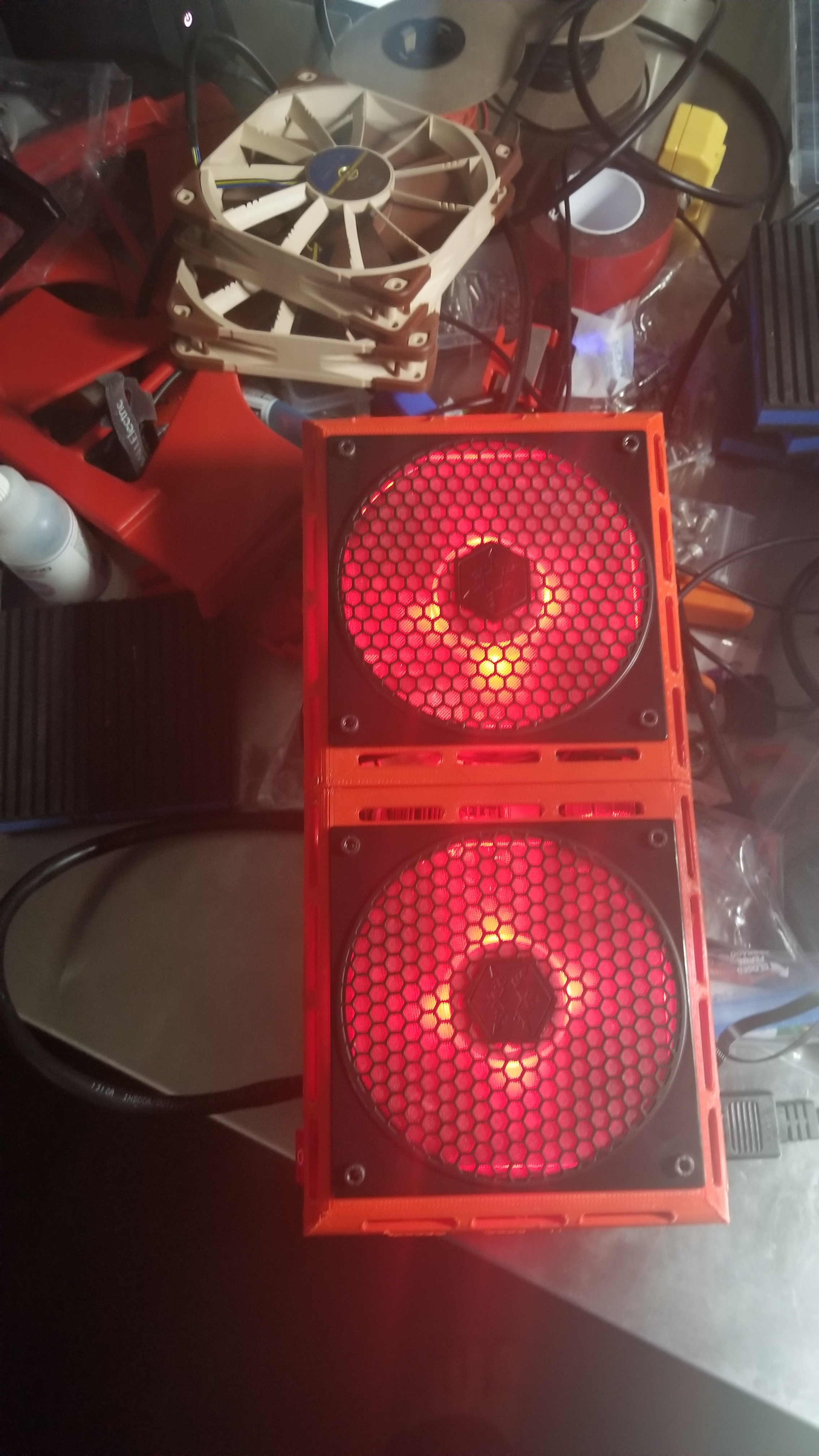

I also started today my dual 120mm power supply mod. I left the original 40mm in there. It still hasnt turned on once. I might be very pleased with this also to early to tell its only been 25 min.

Ive decided to get rid of the buck converter. I will be externally powering my new 5 fans. I will have the fans turn on via touchscreen with the printer. I will also set up notifications if there not on.
Getting further well over 24hrs stock fan hasn’t come on. I am reading 25c-29c at power supply heat sink. I think it should be fine in the vertical position cause thats the way the fins point anyway.

ok it works! silent… I need to do some serious wiring but first gotta install my stepper dampeners. I will have to reprint the PS cover. I did it in a bad orientation for speed.
