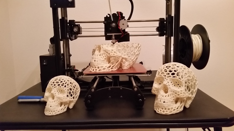

Since Halloween is coming up I’m cutting using glow-in-the-dark White ABS
for printing scaled up versions of the Voronoi skull lamps found on Thing-averse - everyone I’ve shown them to love them
I bought the ABS direct from Lulzbot but other places have it as well
I started with the ABS profile and then lowered the bed temp to 90c. This is producing good strong prints but there is a bit of excess spiderwebbing. I would love to see someone work out the exact profile and if no one else does, perhaps I’ll get to it one day.
