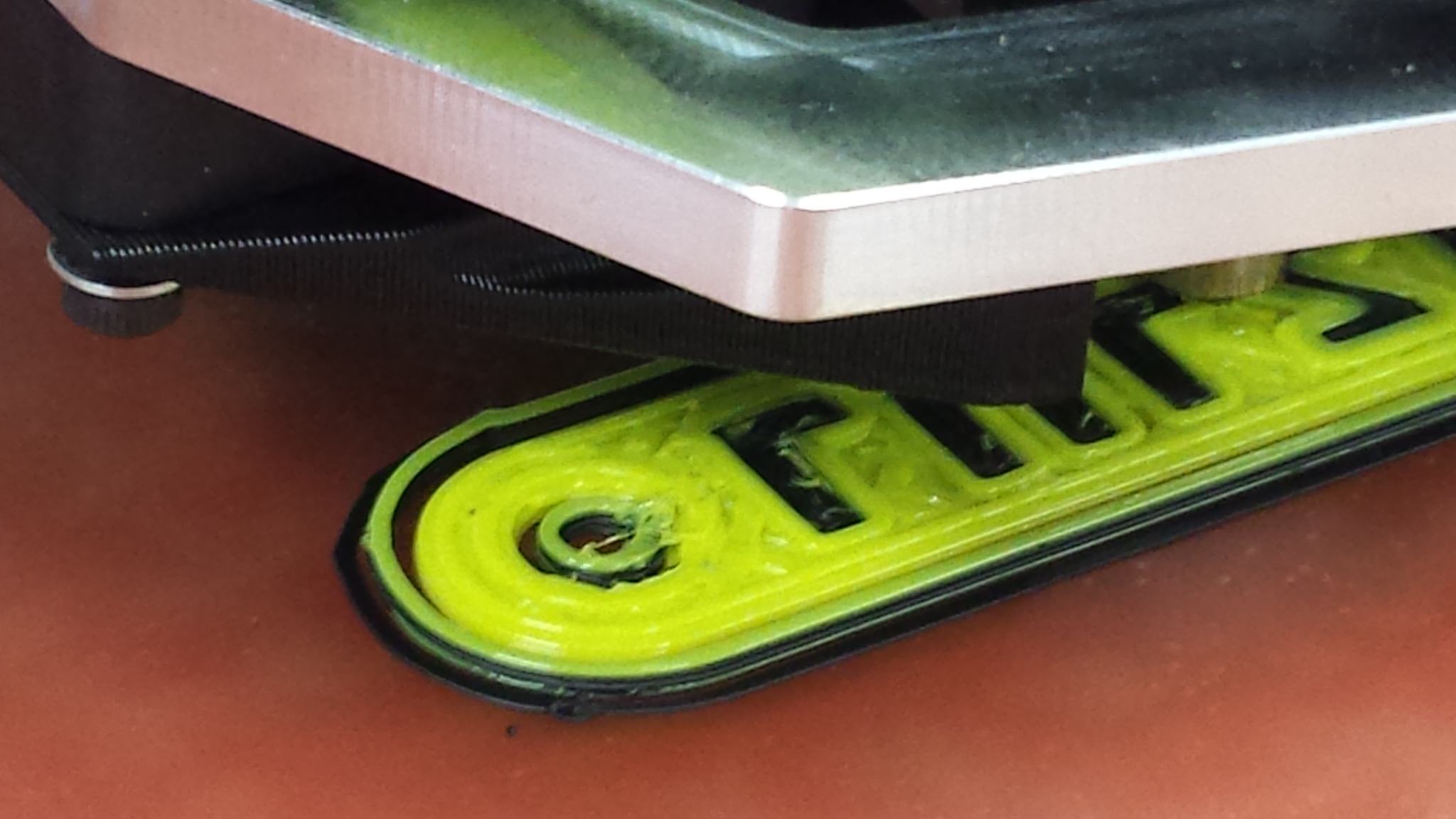

The sample filament ngen green with the single extrunder was very easy to use. We went out and bought the dually and duallyflex. The ninjaflex green seems to pour out and leave a puddle when it starts to print, also its very stringy.
Any suggestions on what I may do to help this?
Try a few degrees lower for the extrusion, more fan and a bit more retraction…
