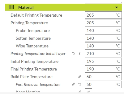

Initially I got some really great prints with the bed leveling failing about 30% of the time. The problem, from what I can tell, is the wipe happening at 140C when the filament isn’t molten. So even if there is a tiny bit of material there, it doesn’t wipe away. If anything, it accumulates fuzzy material which makes the washer contact process worse. In many cases, I see the bed deflect down a great deal on the left side, not so much on the others and it will attempt to print. And fail. Or it will do the left front washer softly but mash the right side down hard and as before, eventually fail the print.
So perhaps that wipe temp should be adjustable based on material type?

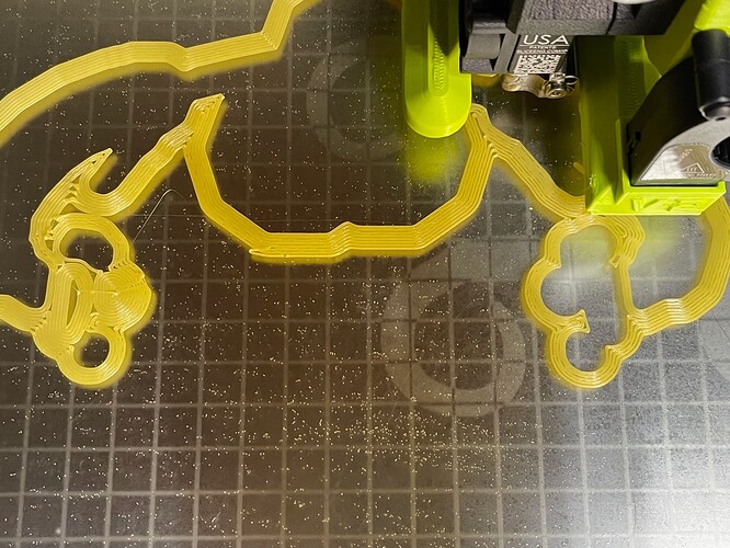

After several tries, a brass brush to clean the nozzle to make sure it is truly clean, I finally have a 25 hour print underway. It took some PVA (hairspray) to help keep the problem size adhered to the print surface.
Here you can see the left side looks good. The right side is a bit high as the gaps in the brim are further apart.
The Wipe temperature is one of the temperatures that can be adjusted in CuraLE.

This still looks a little far on the Z offset to me.

I had to search for the Wipe temp inthe Beta Cura (4.x )…I’ll see if 190 helps
Turning up the wipe temp too high will lead to oozing from the nozzle after the wipe, ruining the leveling accuracy.
You can tweak the wipe temp by just slowly increasing the temp on the nozzle a couple degrees at a time, then manually wiping it with a wipe pad. Once the plastic on the nozzle can be wiped with a little effort, that’s as hot as you want it. If you let it sit at the wipe temp, and anything oozes out, it’s too high. Having wipe as low as possible can also help so that the plastic gets wiped off on the pad, instead of being hot enough that it melts in and embeds.
