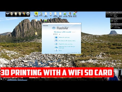

I looked at the Raspberry Pi option, which seemed nice and I may still peruse (my Raspberry Pi 3 has built in WiFi!!), but also discovered a neat workaround that makes my goals so much simpler. Wi-Fi SD Card! Toshiba makes a 16GB unit that can be had for $35 on Amazon, which also allows for network mapping allowing a user to send gcode files directly to the card. I figured that I could load up Cura, define a print, send the resulting gcode to the Wi-Fi SD Card, and go over to the printer and execute it.

It is possible. Here is a general configuration guide for marlin printers. http://microfabricator.com/blogs/view/id/54e438e56983c5316480205e/using-a-flashair-wifi-enabled-sdcard-with-your-3d-printer

This guy also points out that you can create a mapped network drive to these devices operating in client mode:
You simply copy gcode files to the drive. No need for a CGI web interface or third party software. Just Windows Explorer, which is nice.
