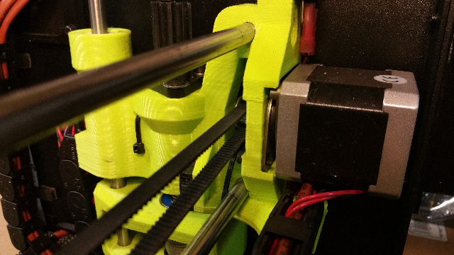

The X axis is also noisy, but unfortunately there isn’t enough clearance for an Astrosyn damper. Anyone have luck with the really thin cork dampers?
I put Nema stepper dampers on both the X and Y axis motors (you’re right that the Z axis doesn’t move enough to be worth it). To get one on the X-Axis, I had to grind off where a screw hole poked inward using a Dremel.
The Y-Axis is all but silent now. The X-Axis noise has been reduced by about half. Putting it inside an old (2D) printer cabinet/shelf (on foam) has reduced it maybe another 50 percent, but the damn thing is still loud enough that I need noise-canceling headphones if I want to work while I print. I’ve got some noise-reducing foam on the way to line the cabinet with.

Installing a damper on the x axis of a mini is doable, but requires a modification of the model…
