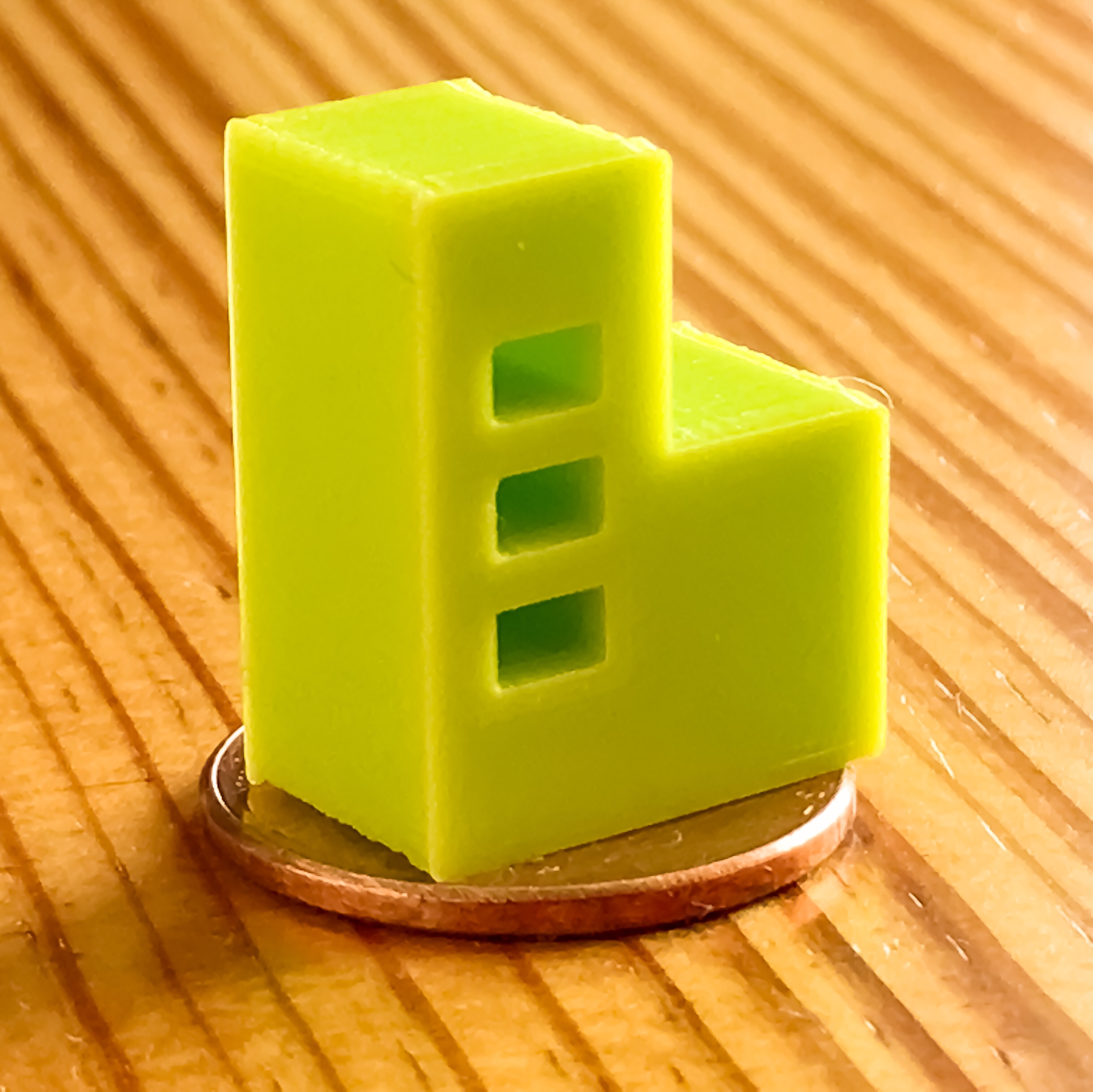

Have yet to try the mini 2 micro profiles but here’s what I got last night just fumbling around:

FWIW - A print using the Mini 2 Micro Standard profile (top) and a print using the Mini 2 High Detail profile modified for a .25 nozzle (bottom)
modification notes:
