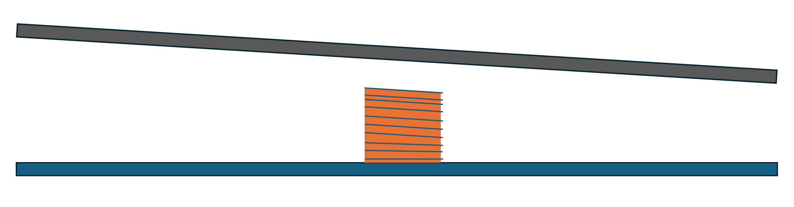

The Z motors are not driven independently on a Taz 6, so it can’t adjust the tramming automatically. Because there is a tendency for (usually) the right side of the gantry to lose steps vs the left, manual intervention is required to bring the gantry co-planar with the bed. The software has a limit on how much adjustment it will allow based on the probing measurements before throwing an error and refusing to print. Additionally, the firmware is, by default, set to fade the adjustment over 10mm, so if you’re off mechanically, a (greatly exaggerated) example of what your layers would look like is this:
Mechanically leveling the gantry, despite having firmware compensate is highly recommended
