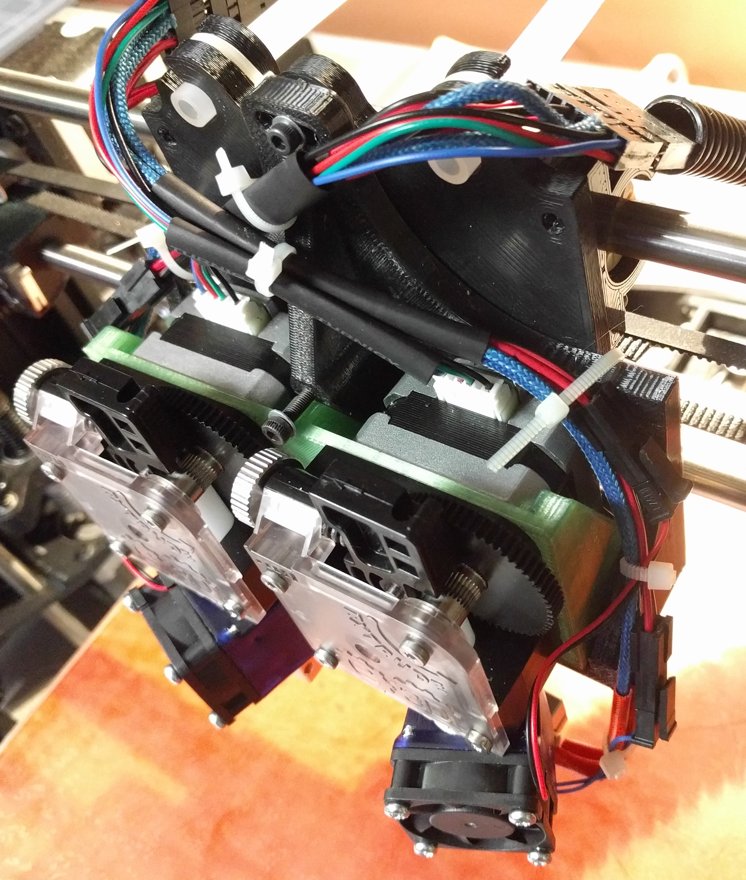

I bought dual Titan’s and dual E3D v6 hot ends. I also got the smaller (shorter height) stepper motors that were recommended by Tom (Review: E3D Titan as a super light extruder! – Tom's 3D printing guides and reviews) and by the support person at Filastruder where I bought the extruders and hot ends.
I developed a custom extruder mount that takes advantage of the smaller steppers to keep everything as close to the x-axis rail as possible. I will post the stl files once I have tested everything out. I created a pivot point in the mount so that the print heads can be easily leveled with respect to the print bed.

Just a quick thought, but the Taz 5 & 6 appears to be optimized as far as axis travel goes by having one extruder in front of the other instead of side-by-side to use the whole bed area. Did your side-by-side layout constrict your bed area usage?
It’s a Taz 5. I really poured over the design and this one more or less represents v3. I had to make a few compromises, but it achieved all of my goals. The left nozzle tip has complete coverage of the print bed. The distance between the left and right nozzle tips is 2.481 in. That’s how much I will loose on the right side of the bed for dual printing. I can certainly envision other designs that get the nozzles closer together but they would require a Bowden type setup where the extruder is not on the carriage. The nice thing about the components is that I could break everything apart and reconfigure it that way if print area becomes an issue. It seems like everything is going to work, I just need to modify the settings so I can test it out. So that’s where I’m at now - information gathering. I’m the slow, steady, perfectionist type.
