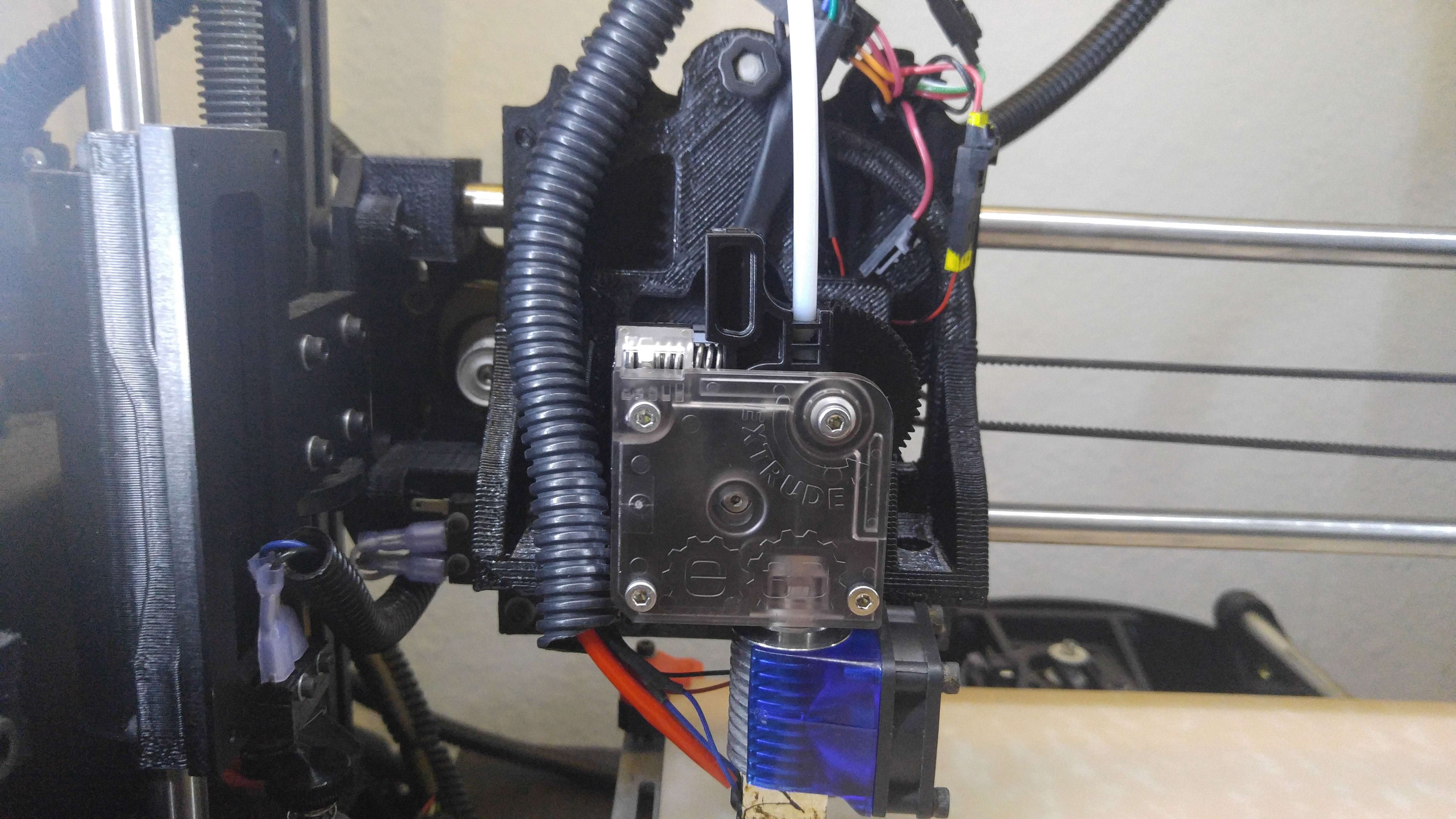

Could you post some pictures of your installation?
Here you go! Can’t figure out how to make them rotate properly on the forum sorry.

Update!!! made a new mount for the half height motor! Didn’t have too much time to clean it up…Its a remake of someone else’s model. I had the Step file but it would not load the history in Solid works. I merged together the mount and the motor bracket to make it one piece. It works great and sits right up against the back plate. Now just need to re-position the bed to line up with the off set of the extruder. If any one has questions let me know and If any one has better ideas or better results please post!
Here are some pics of it on the printer…Also here is STL file for the mount.
