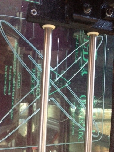

Got the unit running today and have done a few prints, pretty sure i have an issue somewhere in regard to levelling, which i will work through… am i suppose to hear the nozzle rub over the print in a cross direction?
Anyone see any problems with this bed level print? should those lines double over like that? , i fixed the height since this pic.

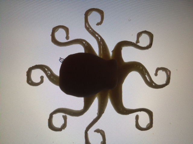

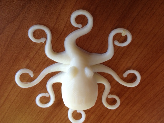

using std nozzle 3mm_pt5-nzl_pt3-lyr.ini … got that octopuss? end tenticles not nice … body seemed ok

Looks like your nozzle is too high off the bed. Adjust the z axis limit switch screw so that a piece of paper slips tightly through between the nozzle and glass, but do that at normal running temp for the bed.
After i did that octopuss, I did those parts in the bottom shot… have a look at that perimeter line, pretty flat right?
