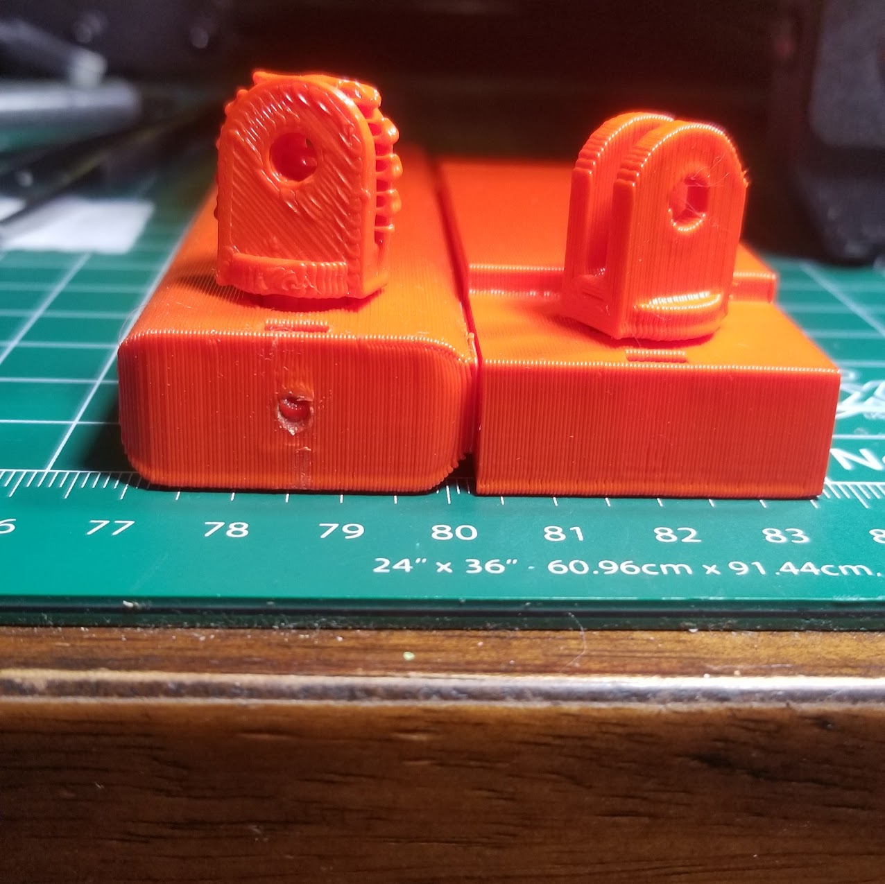

v15b:
Fits perfectly on the clamp :smiley:
Is slightly longer than v15, so print head will pass freely :smiley:
I need to find a M3 hex nut, but that is great solution. :smiley:
Does Not clear big screw, to tall.
v14c: cleared screw nice <---- best height over big screw
v12: barely cleared screw

Had to go back to the rectangular shape.
Took 2mm off the bottom. Give it a shot.
TAZ5 RPi_Cam_GoPro_v16.stl (468 KB)
We are the closest we have ever been.
Overall length → good
Clamp fits → good
Metric nut and screw to hold swivel head works perfectly. (picked some up from hardware store)
If printed vertical no supports to remove between clamp or swivel arms.
I think in v16 you forget to put the little hole back for the screw that goes to the nut to hold swivel head.

Swivel is fine, causes no issue with big screw.
Im saying v16 is missing the hole on the plastic the allows the m3 screw to make connect with the swivel lock nut.
v16 hits the big screw, without the cam attached. Needs more clearance.
But also if locking screws are used on the bottom they will stick out unless you taper or fillet, or hollow out the screw holes on the bottom.

v17 printed fine.
Clamp fits on metal sheet snugly - GO
Clearance above Y axis pulley screw - GO
Swivel lock nut, holds swivel mount securely - GO

Had a very hard time getting the hex nut into clamp cut out. I tried so hard I ended up deforming the plastic. Once the plastic deformed the nut would spin as I tried to turn the screw.
After work I’ll print another and try heating the nut up, and or lowering flow rate.
Also even though in my android slicer and lulzbot cura I see there are cuts outs on opposite sides of the clamp section. Only one side printed with a cut out for the hex nut in clamp. The other side touching the bed printed missing the cut out, im puzzled because the both slicers rendered both cut outs.

EDIT: Here’s 17C. There were some issues with the holes after adding the slots for the hex nuts. The plugin I use to check for manifold was filling in the screw holes on one side. S3D slices the model ok. Still a little worried that there’s not much material to provide a good clamping affect. Also made the new hex nut slots a little bigger (2.8mm)

17C
Slightly bigger cut outs for hex nuts helped a lot. Clamp section nuts only need a little push in, but that helps to lock nut in place while screwing the screws in.
Clearance under mount is good. The big screw passes between the screws on the mount. Zero sag in mount even with gopro and arm.
