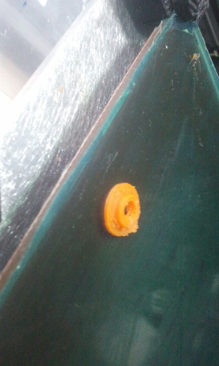

Hello,
I am trying to print a small object with my kittaz but the results are quite bad. I believe that I have a really big error in my setup. Can one of you please print and post a picture of this http://www.thingiverse.com/thing:1276815 this way I can continue tweaking my settings.

below is what I should (in theory) get (the original piece) and this is what I get (okey I got some improvements in my last trials but there is still a huge difference)
Your images are not working.
Your part seems to be quite small, around 1cm in diameter? Printing at least two at a time will prevent the part from overheating, if thats your problem.

Hard to say whats going on, the quality of the picture is not the best. It looks a little bit oval?
Which slicer do you use? If it’s Cura, I would check the e-steps calibration first, see here. The part should print well with the default profiles.
If it’s Slic3r, you will run into an issue due to a bug in the latest version. In this case, use Cura for this one.
What material are you using?
Okey, I’ll get more detailed pictures at first oppurtunity. I am using Cura Lulzbot edition and my material is ABS.
I have also checked e-steps calibration but aside from the Z height section, didn’t understand much :slight_smile:

Got new pictures of my print. You can see them below. I used the high detail ABS 0.35mm nozzle Cura profile.
many thanks for your inputs :slight_smile:
rifo
Does the KITTAZ has a 0.35mm nozzle?
I think you are definitly over extruding. If the calibration guide is too complicated, try this one from Lulzbot. The pictures should clarify the process.

there is a huge difference. I use the default toolhead that came with kittaz. Isn’t it 3.5mm?
thanks a lot for your help again :slight_smile: I 'll try out the calibration procedure that you’ve linked and will report back the outcome
thanks again!
I have no idea what nozzle was shipped with the kittaz, but 0.35mm is possible. It seems as the first TAZ5 had a 0.35mm nozzle, later and now they have a 0.5mm nozzle.
After a short search, I think you are right. The default nozzle should be 0.35mm
The Kittaz came with the .35mm nozzle with the Buda extruder. It does look like some over extruding. Be sure to measure the diameter of your filament with some calipers at a number of places over about a meter of filament. Take the average reading and enter that into your slicer.
Download the PLA fine profile from Lulzbot and try again. In time, as you learn all the settings in the slicer, you can get good results. I’ve upgraded my Kittaz with the Hexagon hotend and a .25mm nozzle. With it, I can print .08mm layer height with great results. It’s taken a lot of experimenting and tweaking of the settings, but small fine prints are doable.
