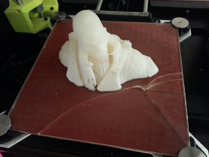

Can't get print off of bed (lulzbot mini)
I have tried everything including the suggestions here to heat the bed to 50C and tap it. I even bought air spray to try and cool it down… nothing seems to work. :frowning: I feel like I’m tearing up the bed itself now trying to get this off. The bed now moves back and forth when I pull/push on the print.
I’ve only printed 3 things (2 of them were the rocktopus). I could get the knife under the rocktopus but with my own model (a character bust) it seems to be impossible. This is very frustrating.
What did you print with?
Can you attach a photo that still shows the skirt? Wondering if your nozzle was too close to the bed.
I was just tapping the model trying to loosen it and cracked the glass bed. I’ve had this thing less than 24 hours and it’s broken.
I’m going to return it with my print stuck to the bed.
I printed with 3mm ABS from IC3D.
Ugh, that sucks. So bizarre. I have black ABS by IC3D and it comes off just fine. What did your skirt look like? Was it a very, very flat, very wide line, almost translucent?
On my Mini I’ve had to add about 0.05mm additional Z-offset (in Cura) and on my TAZ6 it was 0.1mm off (adjusted through the control panel discussion saved to the printer).

Well… I guess its too late now. In the future, use a tool with a thin blade to get under the print. I like an artists knife (particularly number 2) or . Manually get the edge under the print, then slide the blade around the print. For stubborn prints, lightly tap the tool handle. Don’t pry up, that will contribute to the PEI lifting from the bed… slide the tool around the object.
A little IPA (isopropyl alcohol) around the edges can help to get the blade under the print.

It is supposed to be calibrated before being shipped. I’ve had to adjust both of my machines, the TAZ 6 more than the Mini. When I printed the first Rocktopus on the TAZ 6 the skirt was so flat and stuck to the bed I questioned whether it was going to come off. So I immediately adjusted it via the control panel (added .2) the tried again. It was much better but almost too much. I’ve settled in .1 difference than what came from the factory.
For the Mini you set the z-offset in Cura. I have 0.05 on mine and when I measure my skirts they come out perfect, the height measures almost exactly. I will eventually write the change to firmware so that it stays with the machine.

You need to add a z offset. Measure your skirt with calipers. If the skirt thickness isn’t equal to the first layer thickness in cuts, you need to add a z offset in machine settings. Fixed part removal for me.
The “skirt” is the outline extruded around the print at the very beginning. It is used to prime the extruder to ensure a steady flow of plastic by the time it starts to print the actual part. The height of the skirt should be the same as (or as close as possible to) the layer height you chose to print at.

I like to print tiny test pieces with new filament or any bed changes until I get things like the Z-offset dialed in. It makes it less likely I’ll get something really stuck to the bed. I also start a little high off the bed intentionally. I’d rather have it “air-print” for a test than dig into the bed. Then move things down a little at a time to get where I want to be.
For stuck prints, I find it helpful to tap the top a bit with the handle of the knife of a similar tool. Just a few light taps, you’re not trying to pound it off, just the vibration can help loosen it up a bit. I use a putty knife for most removal. It has a nice flexible metal blade that I sharpened a bit with a file. The idea is to get under the print without using a lot of force. Push down with the blade, then tap lightly on the handle. The impacts will help push it under the print. Once you get under it, just push and/or tap a little more to pop the print off. No need to pry, that can damage the bed. Once you get something under it, it doesn’t take much to separate the print.
