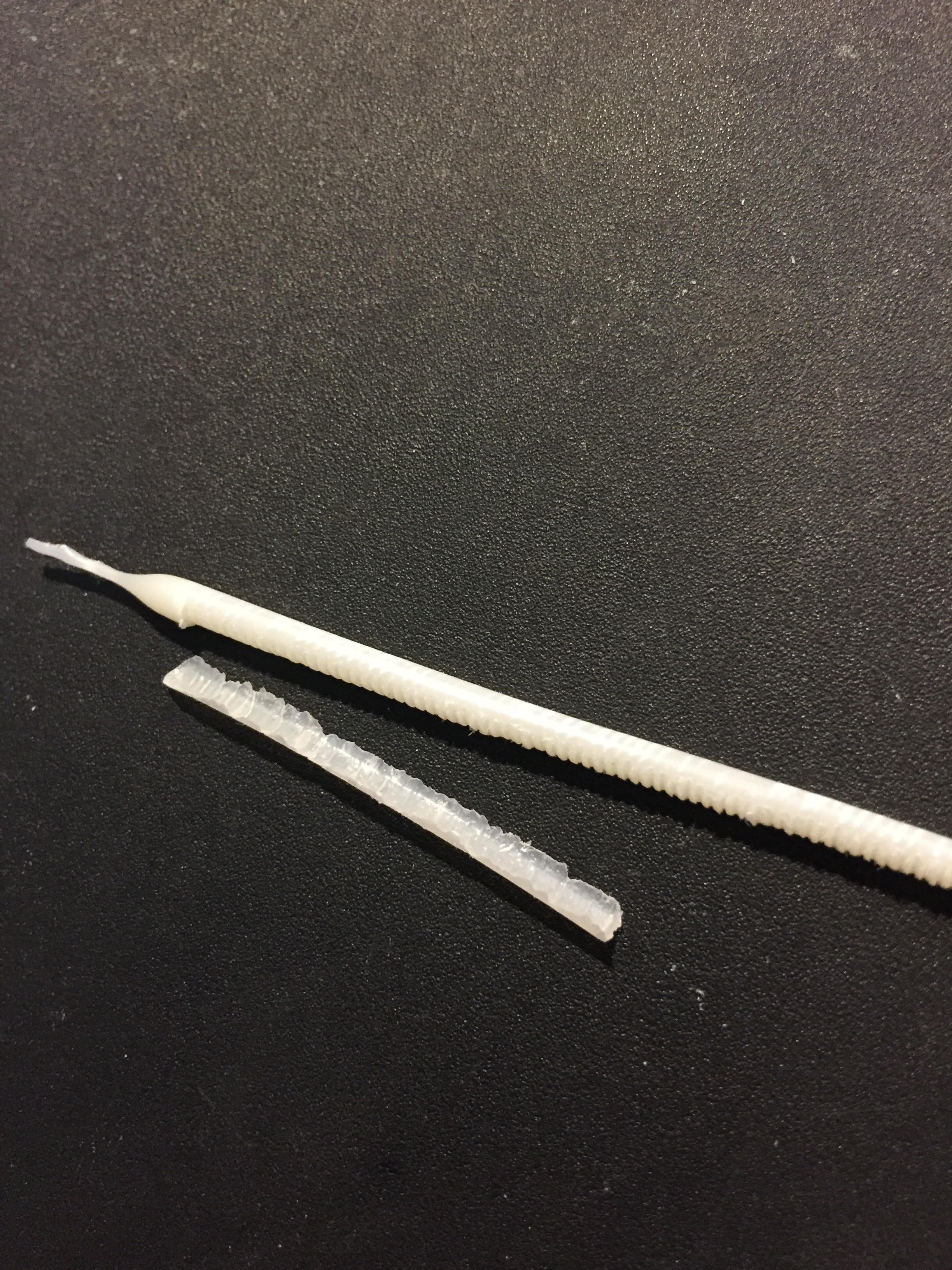

I’ve had an on-and-off problem with clogs and stripped filament with my TAZ 4 for quite a while. I’m using a hexagon hot end. One of the more recent things I’ve run into is what seems to be shreds of filament collecting in the hot end and gumming it up. I’ve attached a picture of what comes out of the hot end when I do a cold pull. Has anybody else seen this? What might be causing it? Seems like it accumulates over time, and after quite a few prints (usually I can print for a couple weeks before things start failing). Any ideas on how to prevent it? Thanks!
The jagged edges on the cold pull look like the normal teeth marked left by the hobbed bolt; however, the picture shows 2 pieces of filament. What is the second piece from?
As the teeth of the extruder grab the filament they do cause small shreds to come off the filament but those usually stay out of the extruder and make a mess around the hobbed both and idler.
When you experience a clog, how tight are the idler adjustment screws? If they feel loose, they have probably backed off over time and allowed the hobbed bolt to slip, causing more of those little shreds and terminating in a “clog” caused by the filament not being pressed into the liquifier.
The other piece is a thin bit that was jammed in the extruder next to the filament. It positioned over the normal teeth marks on the filalment. Not sure how better to explain this, but I’ve attached another picture that might help. Basically, it seems like this is building up inside the extruder to the point where it jams.

What type of filament? Check that the hotend and extruder are aligned… a bend in the path may introduce friction that could require more force to push the filament through.
Could also try a drop of olive oil to help the filament pass through the hotend. Search “seasoning hotend” for more information.
That looks like you are skinning the outside of your filament off inside the extruder somehow? Or the roll has an issue with coming apart.
This is ABS filament. I think alignment of the hotend and extruder could be part of the issue. I’ve realigned them, so will see if that helps.
I don’t think the filament is coming apart or being skinned. I think there are shreds of filament from the hobbed bolt biting it that are getting worked down into the extruder. Over time they are building up.
My guess would be the spool of filament. ABS is pretty durable. Try a different spool if you have some handy. IC3D stuff should be pretty good… hopefully they stand behind their filament and offer to replace the spool.
The teeth marks are pretty visible on the filament. They should show, but not to that extent. Hopefully the re-alignment of extruder and hotend should help relieve any bends in the path…and allow you to lessen the idler tension. Basically, the idler just needs to provide enough tension to keep the filament clamped… the tension shouldn’t be so great that it can’t adjust to varying diameters of the filament.

The problem is that liquidized plastic is working its way back up the extruder. This may be due to several causes:
- Is your heat sink fan operating correctly? If it has stopped functioning the heat break will not function correctly.
What temperature are you extruding the ABS at? The hotter the plastic, the easier it is to flow somewhere besides the nozzle.
Have you correctly set the diameter of the filament in your slicer? If the diameter of the filament is larger than the slicer is set, you may be creating excessive pressure in the liquifier, causing it to find other means of escape.

I want to say I doubt the heat break tube is actually 3MM, otherwise a 3.01MM filament would not get through.
Plus the heat break continues about halfway into the heat block so the filament is already expanding before it exits the tube and is now bigger from heat swell. (taken apart/built a ‘few’ hotends to know this.)
Also remember retraction pulls the viscous end back up into the tube. I fixed a Makerbot Gen 5 for a customer a few months ago due to melted filament narrowing the heat break tube and plugging it due to retracting of the filament.
Hadn’t occurred to me that this might be caused by plastic flowing back up from the hot end. That actually makes a lot of sense.
I’ve had a periodic problems over the past year with clogs and the hobbed bolt stripping through the filament. That is why I’ve had the idler tension knobs tightened down pretty hard, hence the deep teeth marks. But maybe my problems are primarily a heat creep issue. I’m using the squirrel cage fan that came with the hot end, so maybe using something beefier will help.

Thought I’d post an update on this issue, in case anybody else has these problems and runs across this thread. I have one model I’ve been trying to print that kept failing repeatedly, in the same manner as I described earlier. I was noticing while trying a print that the extruder was retracting the filiament repeatedly, and it finally clicked that this was chewing up the filament to the point where the extruder could no longer grab it. Once that happens, the hobbed bolt just chews the rest of the way through the filament.
I fiddled with retraction settings, lowered the retraction length to 1mm (it was 1.75) and raised the minimum travel to 5mm (it was 2). That immediately seems to have solved the problem with chewing through the filament … the print is almost completed successfully.
So it seems that retraction settings can have a significant effect if you run into problems with chewing through the filament.
I’m not sure if this is also related to the pictures of filament I posted earlier in this thread, but I’m wondering if the excessive retraction was just pulling molten plastic from the heat block up into the heat break.
