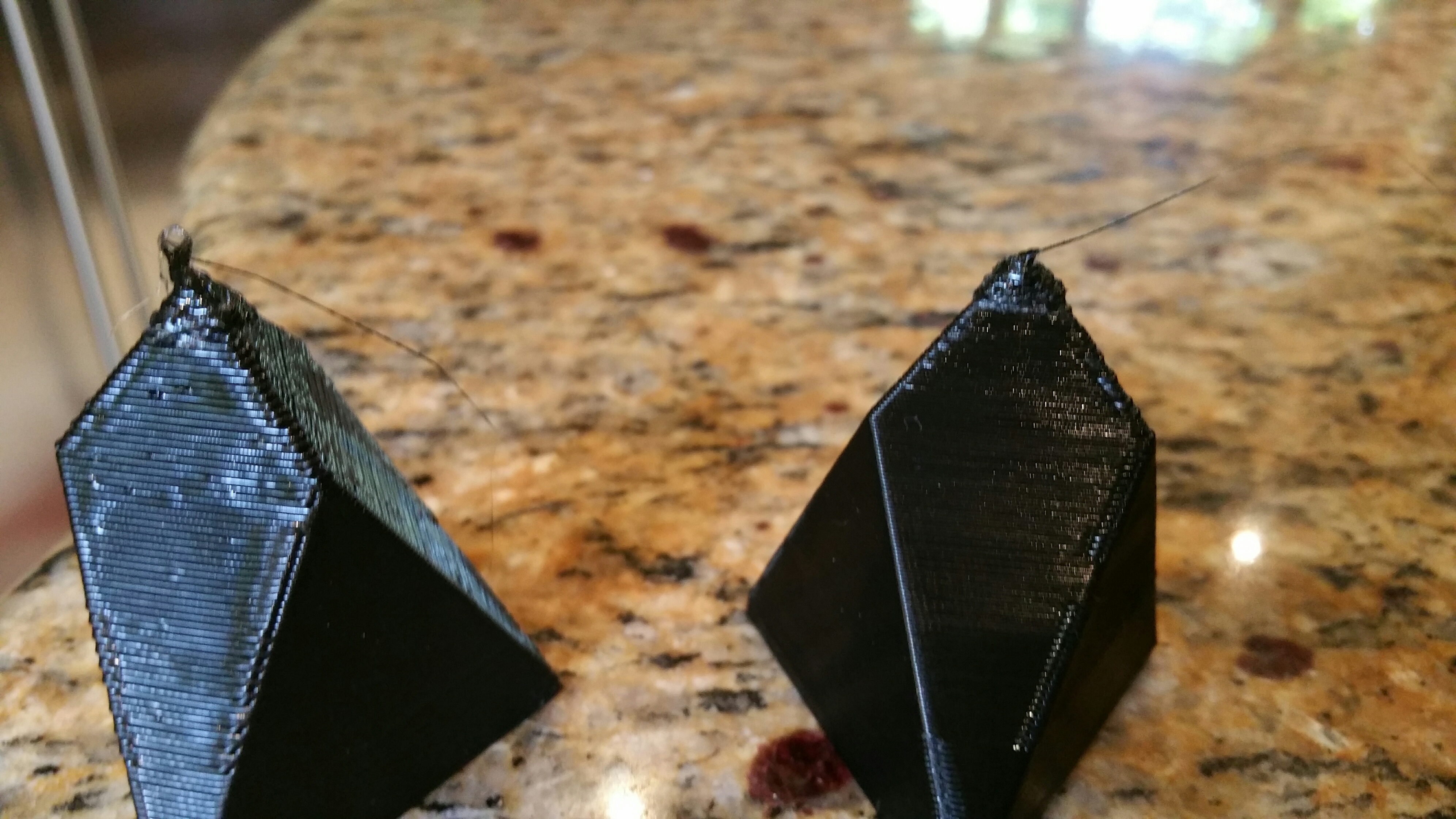

Okay I was able to load the Inova-1800 profile to use on the Colorfabb XT and here are my results depicted in the images. Not too bad, my only questions are 1. How do I get the filament to finish the top “points” properly this was two different profiles including the high detail profile but it still could not print the tip properly. 2. These stuck to the PEI very strong, they were small so they where not too difficult to remove but I could image it may be very difficult with a larger part, is there anyway to resolve this. 3. Is there anything that you can notice that needs top be changed in the settings to make the print better? Thanks in advance.
This is due to the small are at the top of your print. Essentially, there is not enough time for the previous layer to cool before trying to lay down the next layer. You can increase cooling settings and/or change minimum layer time to help fix this up. However, it is much easier to print two pieces positioned apart on the bed. This will allow the part time to cool while the tool head moves back and forth between the two pieces.
We have found the PEI sticks really well, sometimes too well! We have certain materials we recommend using a glue stick on (Inova 1800 is one of them) in order to help part release post print. I would recommend printing out the temperature table included in the manual, and keep it near your printer.
