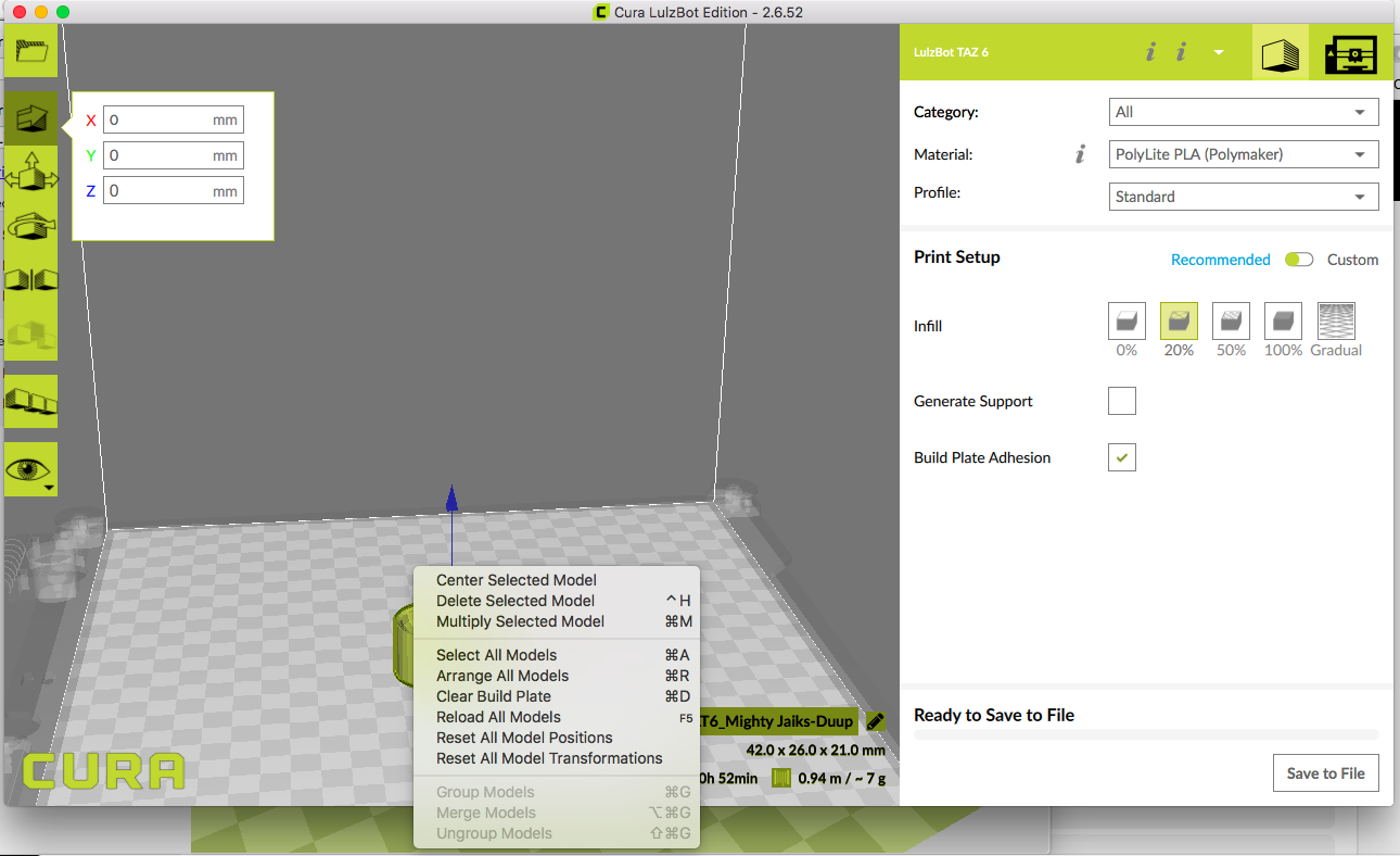

Cura 2.6.52 Can't split objects into parts?
Have some models I’d like to split up and the option is grayed out for me.
On the old Lulzbot Cura the split object option works fine.
Is this the place to report bugs?

Unfortunately, Cura isn’t able to split a single STL file. It can only split STL files such as the one linked below that are two files that have already been combined.
It was possible in the previous version of CURA. Why did that feature get removed? I really depended on that for being able to separate objects out and fit them on the build plate. I’m really very confused… surely I’m not the only one that utilized this?

Cura2 was a complete re-engineering of Cura… And the “Split objects into parts” feature hasn’t been implemented yet. It is listed as a “future enhancement” on the primary GitHub repository. No timeline on it – but I am guessing it will be quite a while.
I’ve heard MeshMixer mentioned as a way to split STLs. Haven’t tried that myself, but it may provide a workaround.

Happened to already have a copy of Meshmixer installed, and after fumbling around a little in the dark, it’s a first-class operation:
[Edit] > “Separate Shells”
Worked as desired, without any additional guidance. Then I saved each separated body to their own .STL file in turn. Can now fit onto a Lulzbot Mini bed.
