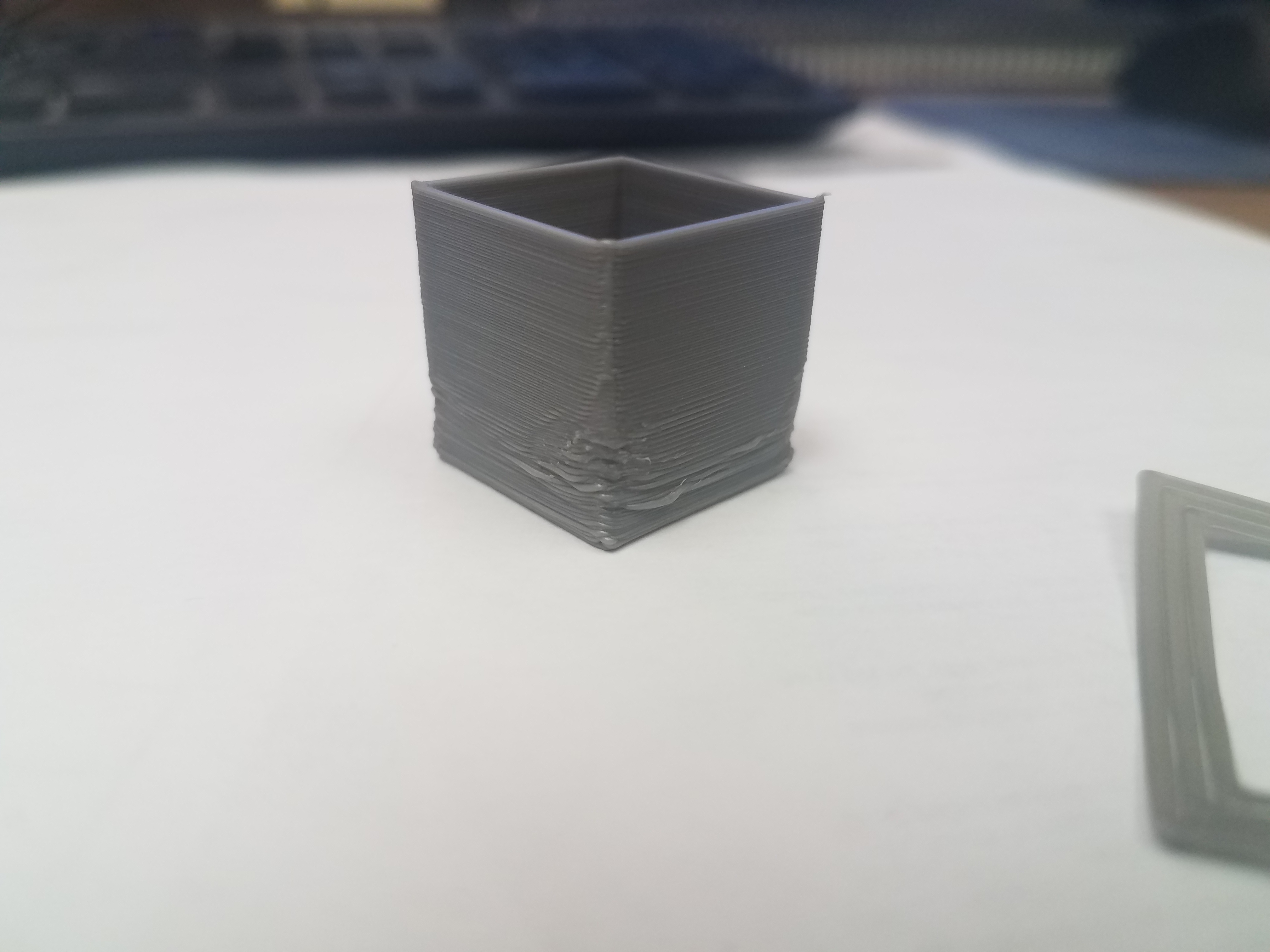

I have been having issues getting my Taz 5 printer to print a 20 mm x 20 mm test cube to print uniformly. I am using a v1 dual head extruder printing ABS. The issue that I’m having with the E-step is that when I do the calibration I can get the head to extrude 100 mm, but as soon as I run a second feed to verify that it is correct, it only feeds 95. This happens consistently and I end up with a very high e-step, right now im at 914.2 and still is reading 95 mm feed that should be 100 mm. The second issue that I’m having is the test cube that I have been printing over and over looks horrible on one side (see pictures). I have checked and leveled the bed several time so I dont think that is the issue. The hot end seems to be dragging through the print, and I’m not sure what would be causing this. Any help would be greatly appreciated.
How much space is there between the washers on either side of the idler arm tension bolts tension spring? I would try tightening that up and then reprinting. It looks to me like you are getting inconsistant feed. Every other layer is thicker than the last once it gets over the goobered part, and it’s not offiset side to side, so it is unlikely to be Z wobble that is most of the issue.

I’d start at about 6mm between the two washers for ABS.
That helped alot thank you so much for the input. Now I have to figure out what is going on with the e-steps. tightening the idler seemed to help a little, but it still wont consistently feed 100 mm.
