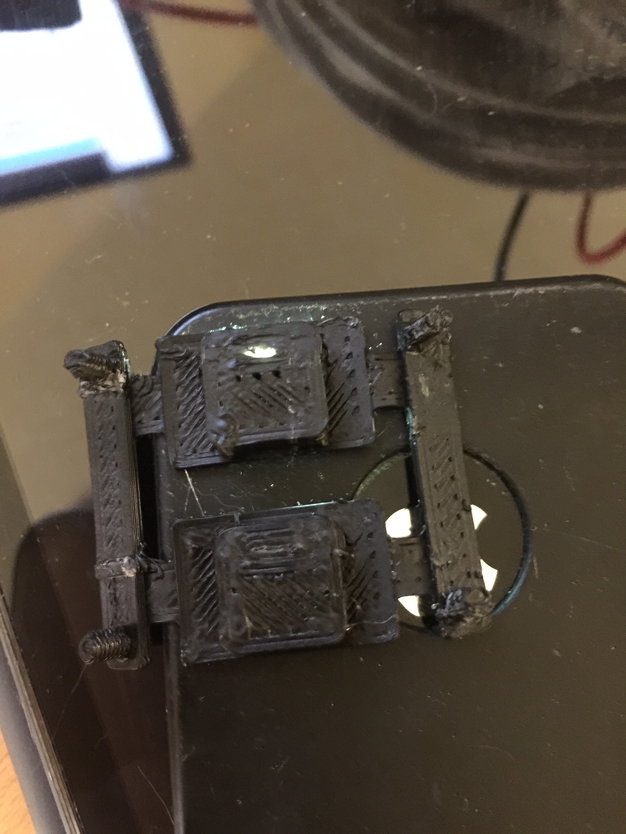

I’ve got this running with an (admittedly janky) bowden setup for now. Oddly enough, I can run Soft PLA through the bowden with no problems - I just have to make a poor-mans flexistruder out of one of my extruders, using a length of PTFE with a notch cut into it to keep the filament constrained. The only reason I can do that is because the Chimera is 1.75mm filament ONLY, so the 1.75 PTFE actually fits nice and snug inside my 3mm extruder. I have a feeling I may NOT be able to run Soft PLA with the D3D extruder, which is a shame.
I also had to liberally ‘season’ the hotends (two Volcanos at .6mm for now) or else tons of problems! Yay PLA.
But, on to the good news. This thing is rigid as hell, extremely light (I’ll be power-testing it later, probably once I need to go up to 1.2mm Volcanos), and because the two nozzles are hard-mounted in the same body the tool offsets are very easy (M218 T1 X-18 Y0), and VERY precise. Since both nozzles are housed in the same body, there’s no worries about making sure they’re level, either - if they’re both in the cold end as far as they can go, they’re level. SO MUCH EASIER to deal with than the Dually.
Man, bowden systems are annoying. Print turned out relatively well, but so oozy. I’m worried too much retraction will cause a jam (it’s already at 5mm on tool changes - maybe I’ll go up to about 8). Other than the ooze, part turned out pretty well. I’m probably overextruding a bunch, too.
It’s hard to tell, but there’s a clear PLA core embedded in the part - the ooziness has muddied it up fiercely though.
Anyway, I’ll try and post up STLs for the various parts that make this (it’s really just two parts, 3 if you want to make the bowden mount I used). One note, the Z-min endstop screw on the TAZ is too short to use with this - I jury rigged a stopper with another screw but it’s the wrong size, and a bit wobbly.
Pictures!
Not a terrible first run though. I’ve done worse with a single nozzle.
