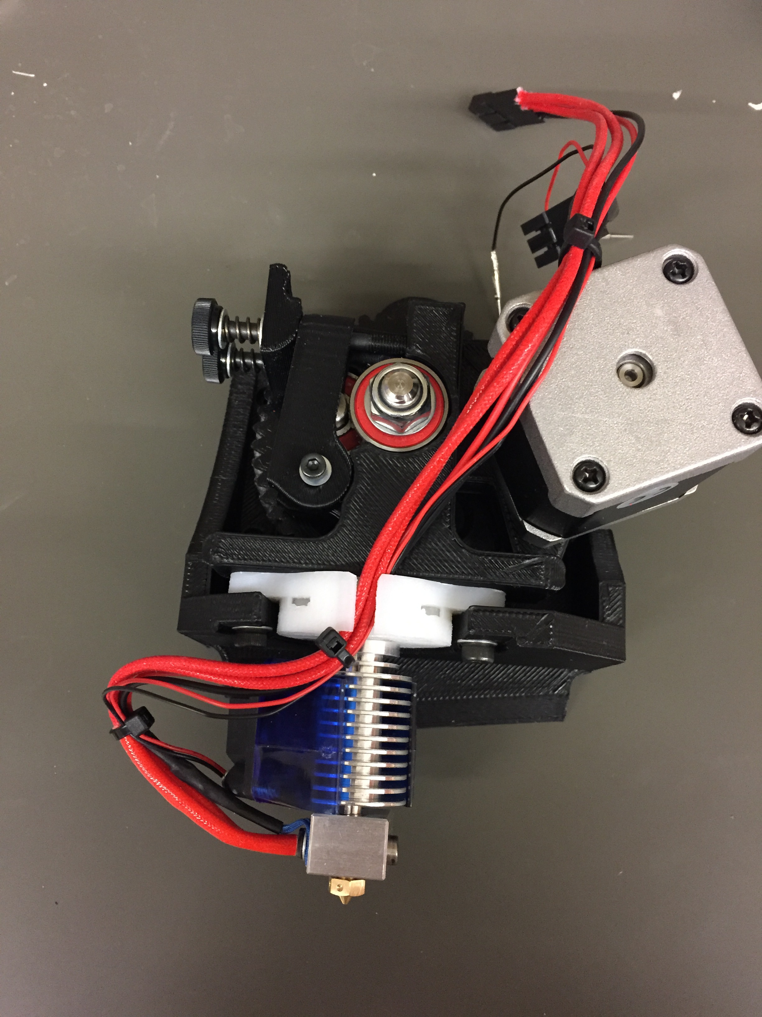

Here it is mounted up doing its thing. It is working well so far.
Has anyone else noticed the need to greatly reduce esteps when moving to this hot end? I went from 832 to 800 and I am still over extruding a bit. This is running with a 0.4mm nozzle.

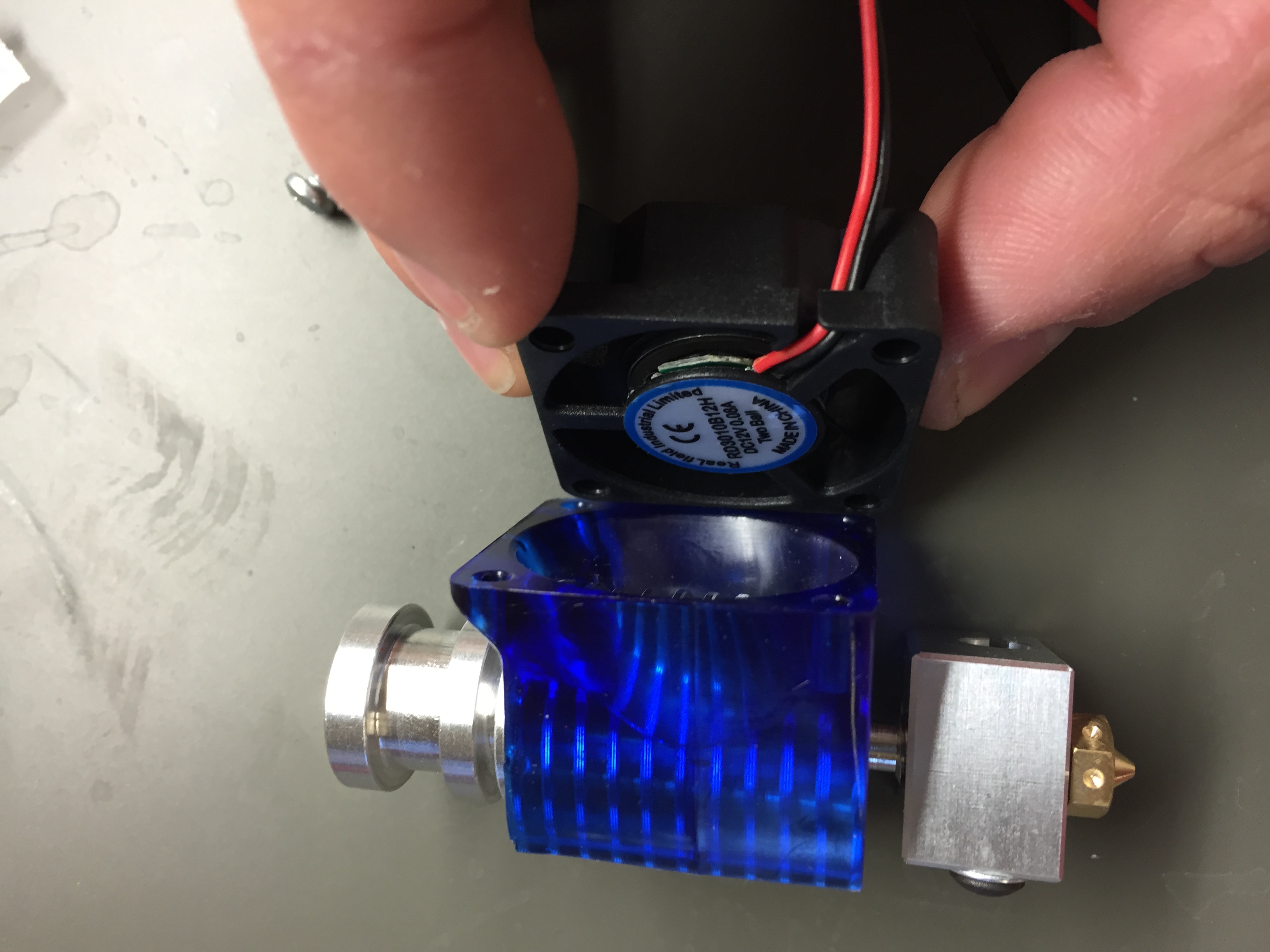

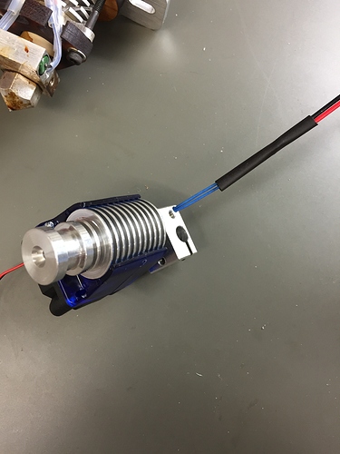

So I just got my E3D-v6 in and I’ll just give a picture install guide. I haven’t had the chance to try it out yet but stay tuned because I will soon do a print comparison between the E3D-V6 and the new Hexagon nozzle.
Extra parts needed: I got everything from mouser
2 circuit molex connector for fan PN 70107-0001
http://www.mouser.com/ProductDetail/Molex/70107-0001/?qs=%2fha2pyFadujg8xhC%2fc04ORrunkoadaHfxgejHoWXvSA%3d
4 circuit molex connector for heater and thermistor PN 70107-0003
http://www.mouser.com/ProductDetail/Molex/70107-0003/?qs=%2fha2pyFadujg8xhC%2fc04OUT%252b6AX9P%2fVSo7WOigWw8Ng%3d
6+ male pins for the connectors (don’t buy just 6, if you’re like me you’ll wreck at least one) PN 16-02-0108
http://www.mouser.com/ProductDetail/Molex/16-02-0108/?qs=sGAEpiMZZMs%252bGHln7q6pm%252bS0pk2Wo0Xxct7Y2jnn8Gg%3d
a piece of 1/16th inch shrink wrap
little bit of solder
If you don’t have a solder iron you can use a crimping butt connector molex PN 19164-0013
http://www.mouser.com/ProductDetail/Molex/19164-0013/?qs=sGAEpiMZZMvz8LftK4jerio%252bkylGcUPeJbzrneYvIu0%3d
few zip ties
some zinc chloride flux helps with soldering wires together
tools:
wire stripper
diagonal cutter
solder iron (optional)
What mounting plate are you using for mating the E3d with the extruder? It looks sorta like one I designed, but I can’t remember if I put that one up on here somewhere or not. I’ve moved a bit away from using it as it seems to eventually loosen up, which can be frustrating in dual-extruder land. Having a millimeter or so of jitter makes it tough to align the print heads nicely.
I actually printed up one of the hexagon extruders, and the E3D’s fit nicely (though snugly!) into them. Not sure if the metal brace-plate that comes with the hexagon hotend will work, however (I don’t have one to test with). I used a plate I found on thingiverse, and then had to shave down a touch with an exacto.

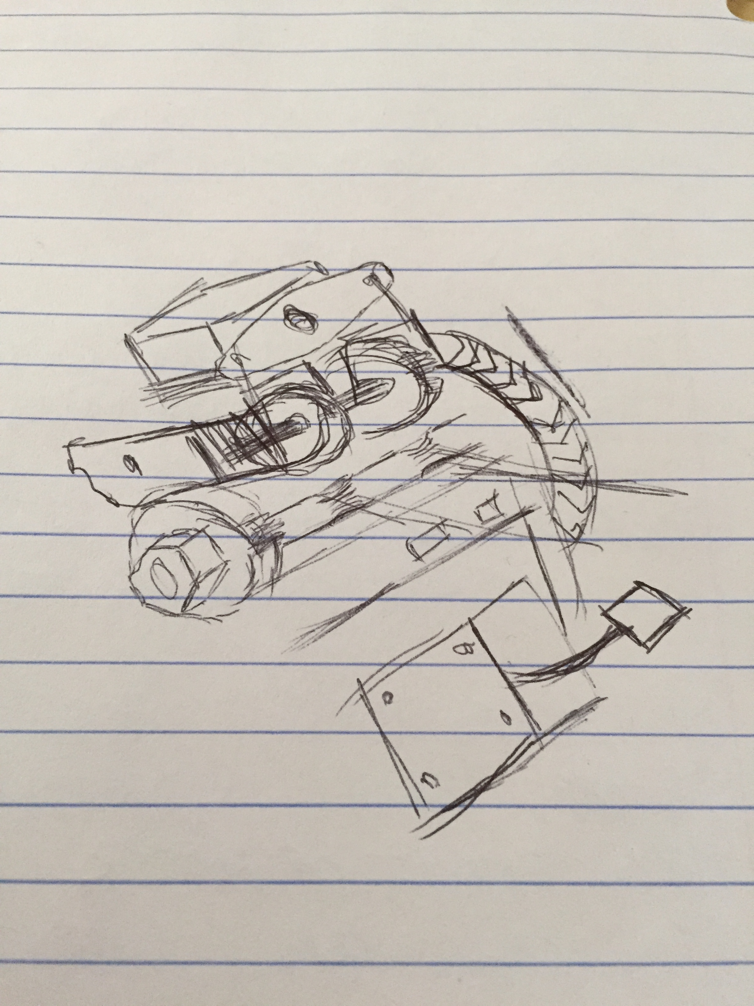

It’s why I’m looking into that HPX2-MAX - annoyingly closed source, but it’s two extruders from a single motor, easily converted to a bowden setup if needed. I’m hoping that I can get ninjaflex working with it too. But the goal in mind is being able to move that x-carriage a lot faster than I currently can. It weighs all of 275g! I think you were the one that posted the weights on the stock extruders - I sadly don’t have a scale, but I expect the Lulz dual extruder chassis, when fully populated, weighs at least double the hexagon hotend. So… really, really heavy.
Dude, depending on how much gumption you have you could do something really cool like this.
If you base the dimensions off of using a Chimera nozzle from MatterHackers you have the extrusion tube spacing for a two point hobbed bolt.
Then if you mount a servo motor with a proper horn it could easily control the idler pressures–one idler would be applying pressure while the other idler would be retracted. If you used a servo with analog feedback you could actually control the amount of idler pressure applied in software.
To control oozing you could go through these steps when switching between filaments; idler pressure high on extruder 1, retract extruder 1 filament, switch idler pressure–extruder 1 low extruder 0 high, move filament 0 forward retraction length, start printing.
This setup would strip a bunch of weight off of the dually plus the nozzles will be super close together, it could run on a single drive train, and use different filaments at different temperatures. I’m gonna work on doing this I think–at least the software side of things, I don’t have the cash to get a Chimera yet.

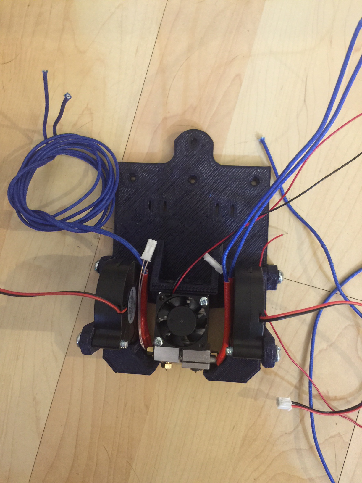

So I’ve begun getting my new E3D Chimera mounted. Not entirely sure how I’m going to mount the extruders, yet. The Wades will be, at least at first, true bowden and mounted to the frame somewhere. I’ve ordered a D3D HPX2MAX, which is a dual extruder that uses only a single stepper, and a servo to switch ‘tools.’ I’m planning for that one to be mounted directly to the x-carriage, though it’ll probably still be ‘bowden’ (just with exceedingly short PTFE tubes).
At some point, when I have more than a day here and there to spend on this, I’ll toy around with making a custom dual-wades (probably also servo-switched) with a hobbed bolt that has spacing identical to the Chimera spacing, for a true direct-drive.
This still needs a couple more iterations - the fan shrouds are mighty close to the heater blocks, and the bottom os the shrouds is EXACTLY in line with the bottom of the nozzles, which is a bit close for my tastes!

Why are you bothering with the 3D3 extruder if it’s going to be in a Bowden setup? I figured you’d just take the extruder rig you already have and mount it on the frame.
You should take some more pictures at some different angles, I’m having a hard time seeing everything.
