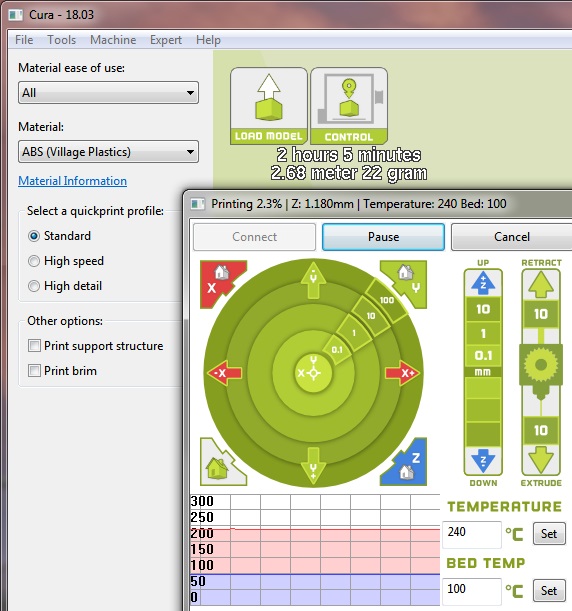

I downloaded the STL file and printed several layers w/o any issues :frowning:
Below is a screen shot of the settings I used. No raft or brim.

I don’t see anything really odd about your settings (a screen shot might be easier to read in the future) but you shouldn’t need any bed adhesion beyond a small brim for this part on a PEI bed.
I would suggest using the quick print settings to see if you still get the same failure within a few layers. If that doesn’t work, suggest you contact customer support. If it does work, you could try tweaking just a couple settings at a time until you find which one is causing the problem.
Alternatively, you can save the gcode file and post it here so we can test your rig’s gcode and examine it for anything that looks odd.

It looks like I’ve resolved the issue (in my scenario at least).
I exported the gcode to provide it to you, and thought I’d have a look through it myself first.
It turns out that there was a plugin command embedded in there - TweakAtZ .
Sure enough, in the plugins tab, I had two loaded (TweakAtZ and one of the Pause ones) - and there were three instances of the Pause plugin created. I deleted the instances, then started the print again - same problem.
Closed and re-opened Cura, re-loaded the model, the instances were back.
Deleted the instances, exported the gcode - TweakAtZ still in the gcode file.
I ended up moving the plugin files from the plugin directory and restarting Cura, loading the stl, saving a new copy, reloading, checking the plugins tab (nothing) export the gcode - no tweakAtZ… and it’s now happily printing away!
So thanks for your pointers. The problem is not fully resolved - I don’t understand stl files fully yet, but it looks like the stl is pulling in the tweak plugin by itself (? maybe?) . But that’s one for later - it’s all going smoothly now :slight_smile:
