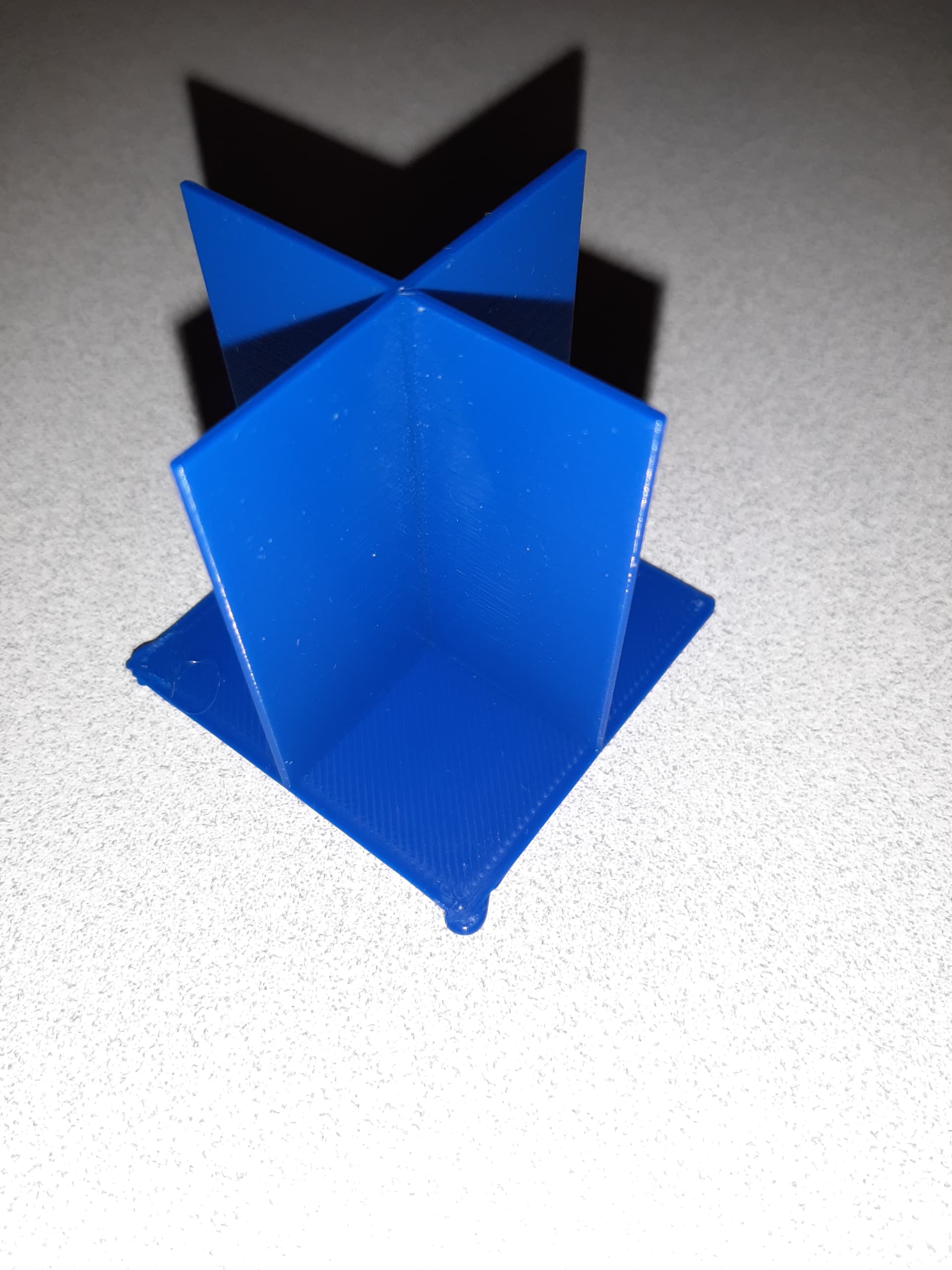

On my lulznot mini 1 with aerostruder head using PLA 205 degrees. Every timei print the skirt looks fine but then when it starts the first layer it puts down a little blob of material before the head starts moving. After that no issues. Any ideas?

Confirned, running latest CuraLE 4.13.8 and firmware 1.1.9.34. Also running default profile.
Just recently cleaned it. Adhesion is very good. Hard to get it loose when done at times. Here is a pic. Always at start of print but before that tge skirt prints fine.
4.13.8 is designed around marlin 2.x, and for some reason they stripped the 2.x firmware from recent releases of Cura LE. If you don’t want to update firmware, you need to find the 3.x version of CuraLE that last supported that 1.1 firmware.
You can find the 2.x versions of Marlin on the Gitlab site - cura/resources/firmware · 3.6 · LulzBot 3D / Cura LE / Cura LE Binary Data · GitLab
Just pick up the Marlin Mini (lcd or not) and your toolhead_2.0.x file and flash that instead.
I installed Firmware Marlin_Mini_Aerostruder_2.0.0.144. Problem fixed. Looks perfect. Thanks for your insight.
