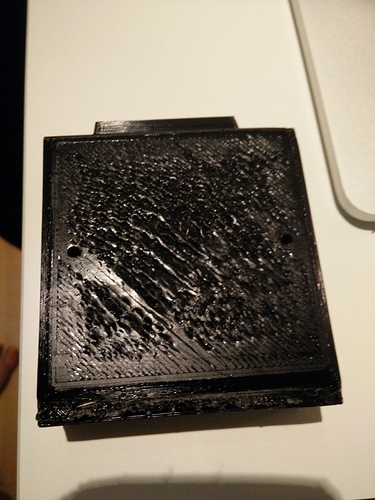

Hi everybody, I have been having quite a good experience with the mini overall (except the few times where it screws up calibration by pressing too hard even in between 2 consecutive prints). However today I have been printing consecutively for quite some hours and the last two prints I noticed that the first layers got what I can only describes as either bubbles or clumps of filament giving a really bad result.
Does anyone know what this is due to? have i printed too much in a row (maybe 12 hours)? Should I turn off the printer for x minutes every couple of prints? How do you solve this? The rest of the print is ok…
PLA: 205 / 60 degrees.

Shiny black stuff is really hard to photograph and so I’m not positive I understand what I’m seeing in the pictures. To my eyes, it looks like there is lots of plastic but it is beading up and not sticking well to itself or to the print bed. Is your print bed oily, maybe from the residue of lots of prints (clean with alcohol)? Have you tried a different filament – maybe there is some contamination in what you have (even if from the same spool, part could be bad). In your first picture, the center looks like it got really molten – have you tried changing bed temperature and hot end temperature? Or, if I’m seeing it wrong, maybe that is the effect from being starved for filament as mentioned above, in which case you might want to check your nozzle: https://www.lulzbot.com/support/unclogging-tips

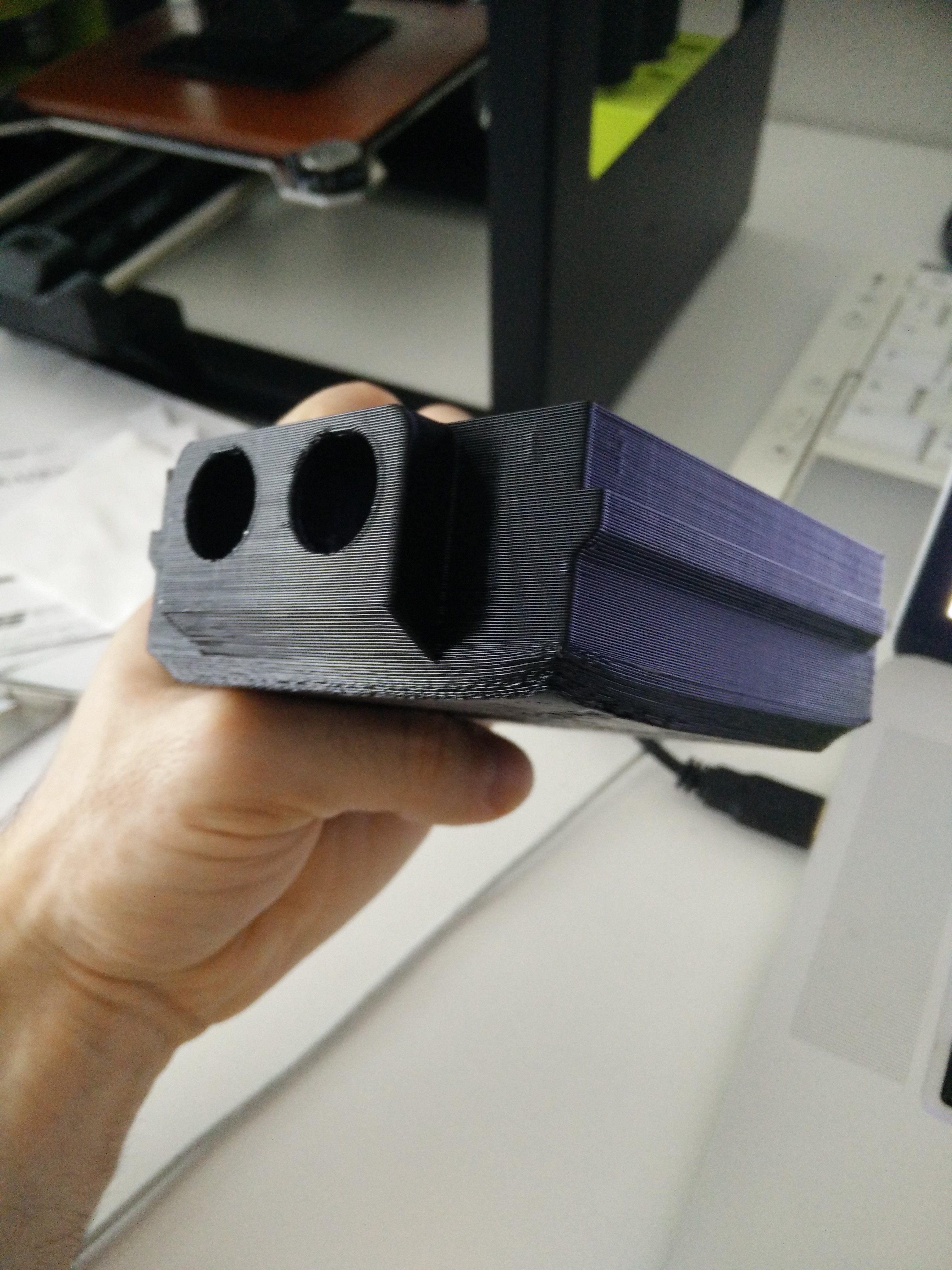

Regarding filament, if this was to be the cause, wouldn’t you say that the whole print should be bad? The issue is only with the first few layers, the rest of the print, details, even overhangs are pretty ok! It’s definitely an issue at start and afterwards is allright I believe. (see attachment)
Im now trying to print with lower temperatures (185 / 60) instead of 205 / 60. Could the bed be too hot? Also the diameter of this filament is 2.85 and in my settings I forgot to change from 3mm (my previous was 3 and never had issue on a whole 1kg spool). I observed the first layer and seemed CONSIDERABLY better although a few “bubbles” still occurred (will put pics when done).

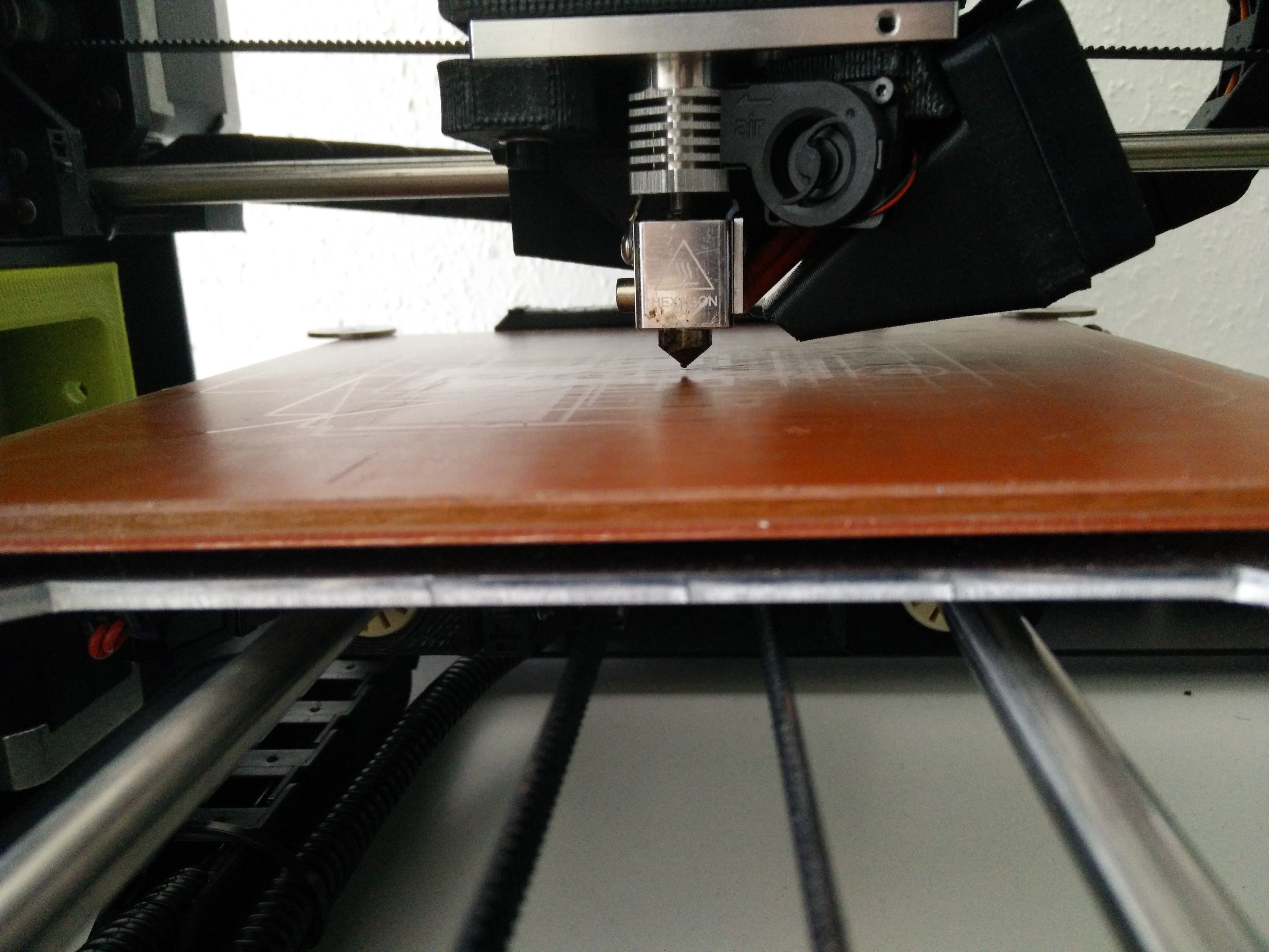

Also sometimes when I do calibration, the mini doesn’t do it right and the nozzle is too far from the plate, resulting in no print which i have to stop (see attachment).

#2 If its not leveling right at times, the nozzle could have material stuck on the face. The electronics has to get signal through the nozzle and then touching the 4 round plates that hold the hotbed down. If there is a little material left on the nozzle or one of those plates then it won’t level right. Is the wiping pad clean? You can turn them over to get a fresh side. Or replace as needed.

The latest print was better although still far from optimal.

From the original picture, it looks like the nozzle height may be too high. So I agree with wmgeorge64 check that the nozzle tip is clean. You described that on some prints, the autolevel procedure wasn’t working properly (bed deflecting during corner touches). Those are symptoms of poor electrical contact between the nozzle and corner washers. Replace or flip the wipe pad. Heat up the hotend and manually wipe the hotend… Try to scrape off any burnt filament from the nozzle tip. Check the bed touch points for any deposited material also.
Just a thought, make sure not to leave the hotend at extrusion temps when not extruding. A few minutes may be fine, but extended periods will just burn the ooze and carbonize the PLA. Which will leave deposits that the wipe pad can’t clean.

You also have a problem with the corners lifting so you might want to rig up some kind of enclosure (even just a big cardboard box).
