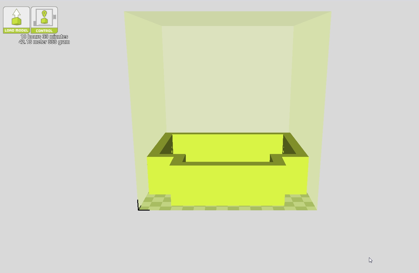

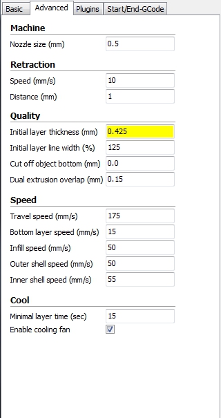

Im getting weird prints that I’ve never seen before! It looks like too much filament is being pushed on to each layer but im not sure. Help? Ideas?
Do you have a 0.5mm nozzle? Most of the TAZ units shipped with a 0.35MM nozzle to my knowledge. You are majorly overextruding there, and I would suspect the nozzle diameter setting is your likely culprit. Also check the diameter of your filament with calipers and make sure that the filament width is set correctly.
