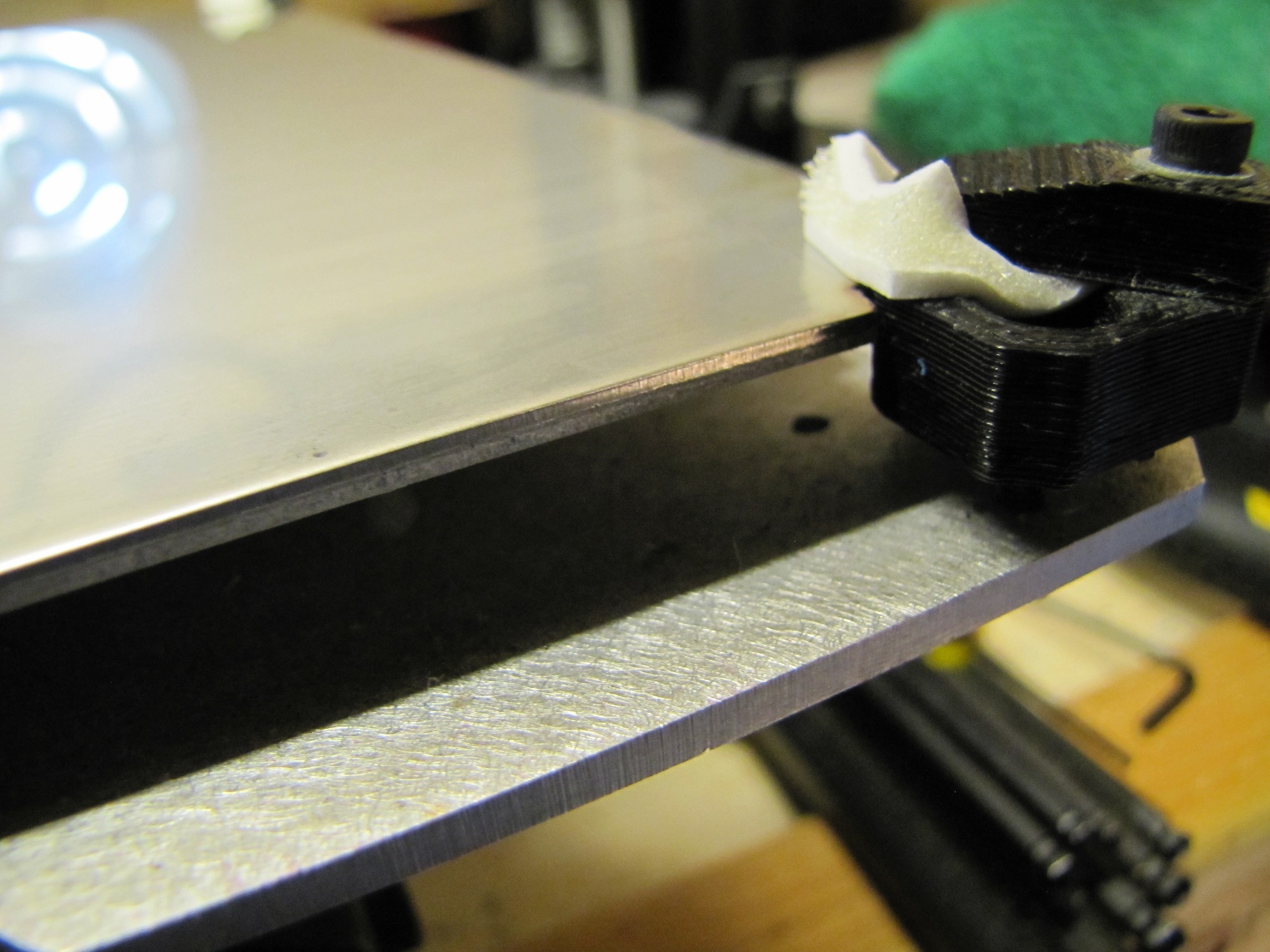

OK my bed cracked after I tried another full sized print (50x done so far). I’m gonna go with Stainless steel due to the prying needed to dislodge large prints, Stainless steel is used on cookware and survives repeated heating and light scraping for-eva.
Glass works just fine with smaller prints but to dislodge larger ones 11.75" x 11.75" you really have to pry on them. That said, I will go with SS or maybe some aircraft grade nickel to get that copper aluminum content as well. Either way- glass go breaky breaky when I pried like I did 50x before and it didn’t shatter, the center of the print held fast and the glass gave with a disheartening crack.

After some experimentation, I went with .09 Inches thick Stainless steel for prying durability, lower weight and thermal properties of a stainless steel pan.
New Stainless Steel 12" x 12" corner trimmed .09 INCH thick build plate installed- first prints commencing.

I am curious to see how flat the metal plate is. Are you going to run the bed level g-code to tune it in?
Looks to be flat like glass after removing the protective plastic liner I took this picture, look at the reflections, very flat.
After spending a few hours leveling the new plate it did have a tiny warp down one edge, likely from the cutting process, but I’m only going to be printing in PLA, no heat needed with painter’s tape, so a few coils of dense foam under the sag edge were ample. I will state that due to weight concerns and the ability to level the plate thinner SS was a good idea, if it had been much thicker I could not have adjusted out the warp so easily.
I could have used springs for a more permanent fix, and I will add them if needed.
There are online services that offer LASER cut polished SS plates, it would be the next step If I have to take it. Minimum $65 one-time setup fee which in hindsight isn’t that bad, would have saved me a few hours of frustration on leveling the build plate.
Btw- the bed leveling mounts and screws & springs could use a rework to make the screws longer the tolerance is kinda tight due to the plastic frame being not precisely square. The screws and springs should be 2x as long IMO.

Update: First print finished, had to slow down the speed to 66% via TAZ console in cura basic, I’m using some high grade PLA which runs at 217C (Form Futura) glossy black.
After slowing it down the print turned out great, I’d say due to the increased weight the machine needs to run a bit slower, there was initial over-lash on layer one then I slowed it down incrementally till the print looked like it was correct, I.E. melt, fill, layer bonding, etc.
In hindsight, I wish I had a digital scale so I could find out the exact weight in grams of the TAZ 4 plate with heater assembly and I would choose a plate thickness that matched it.
The plate did not flex during printing, and I know I could go thinner with it, I’d also opt for the LASER cut plates for exact fit and no warping.
