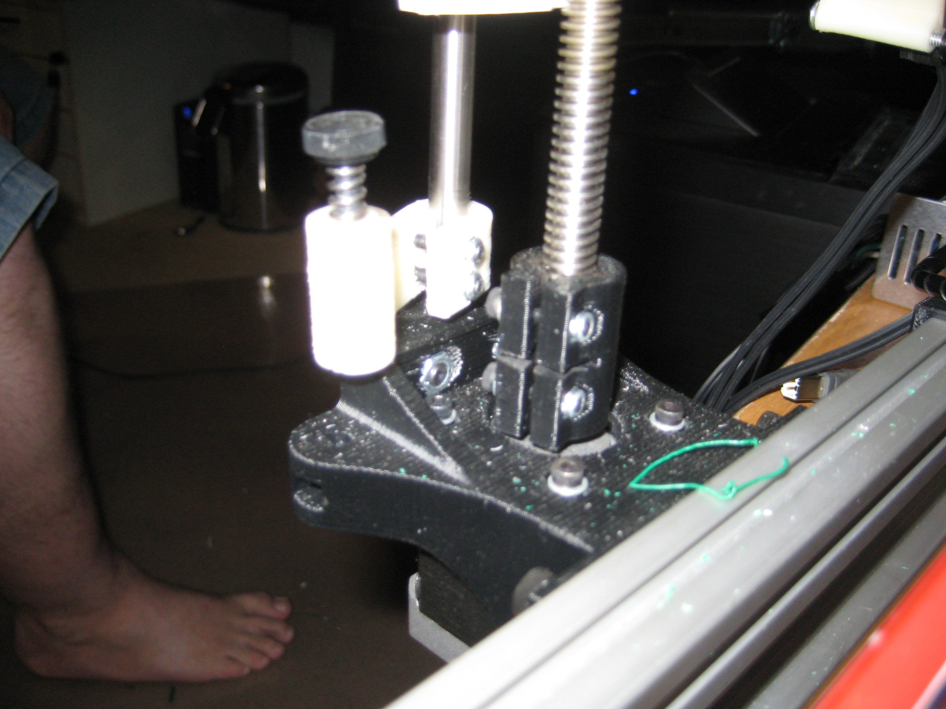

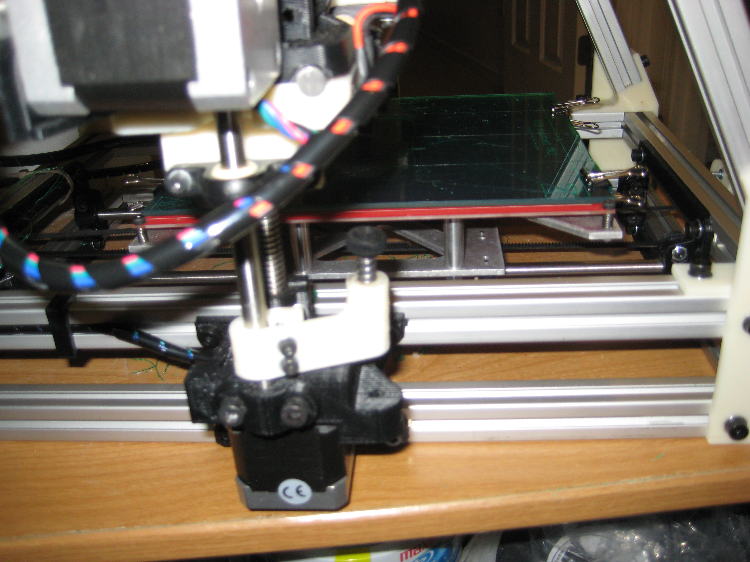

Here’s what the basic layout of the replacement parts for the x end clamp should look like. My printer wasn’t homed in these shots, so ignore that part, but the other pieces of it should give you an idea of how things fit. In particular look at the Nema motor shaft and how far down the coupler is now compared to where it started. You can also see how the replacement Z endstop fits where the original one won’t without surgery
I have upgraded the following from stock:
  • x carriage
  • z axis stepper mounts
  • x endclamps
  • smaller gears (and updated code)
  • filament tube mount
  • Z endstop mount
  • box fan pointing at it.
The difference is considerable. I actually printed a part where the little nut actually fit in the nut shaped hole!
