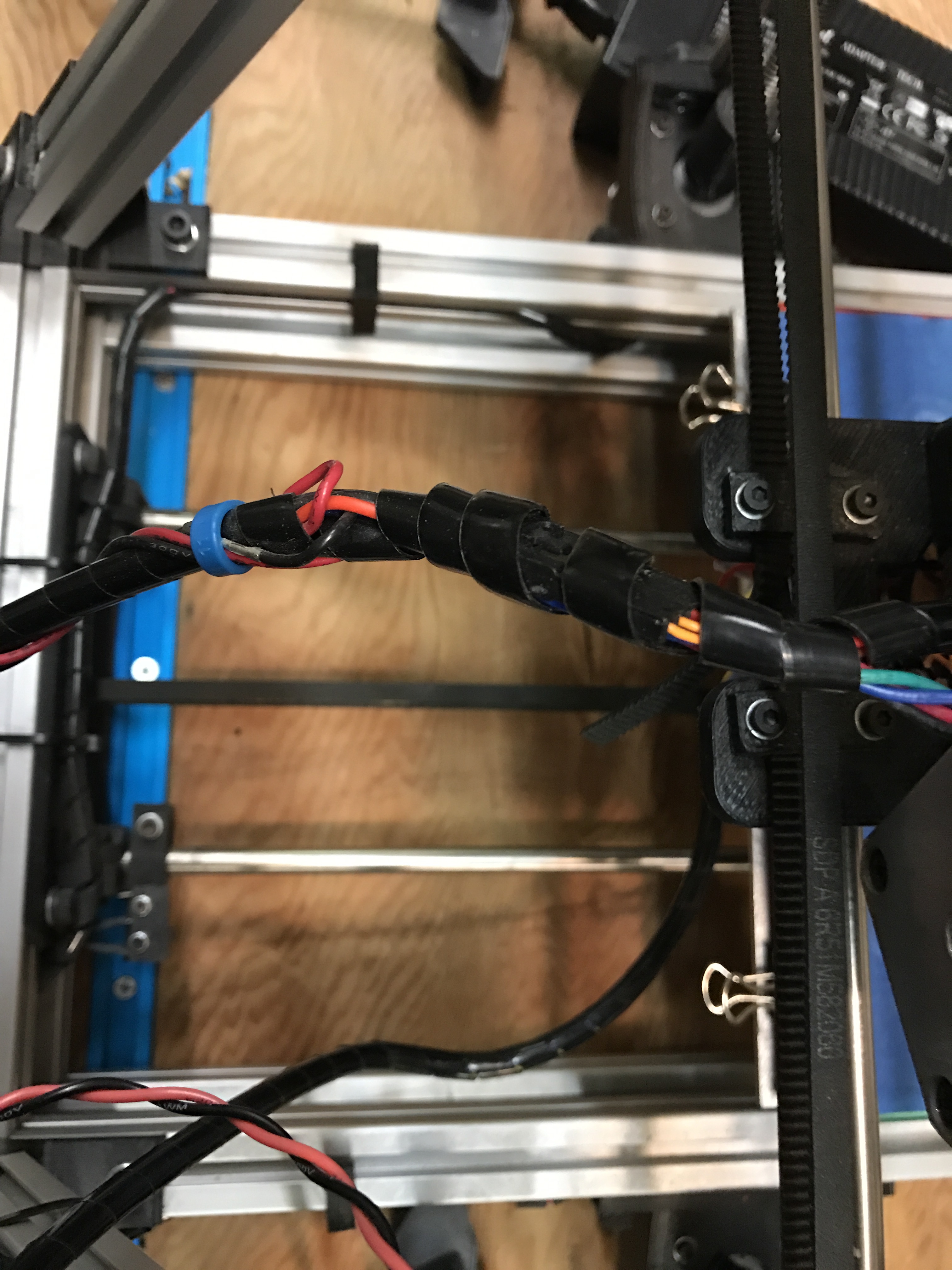

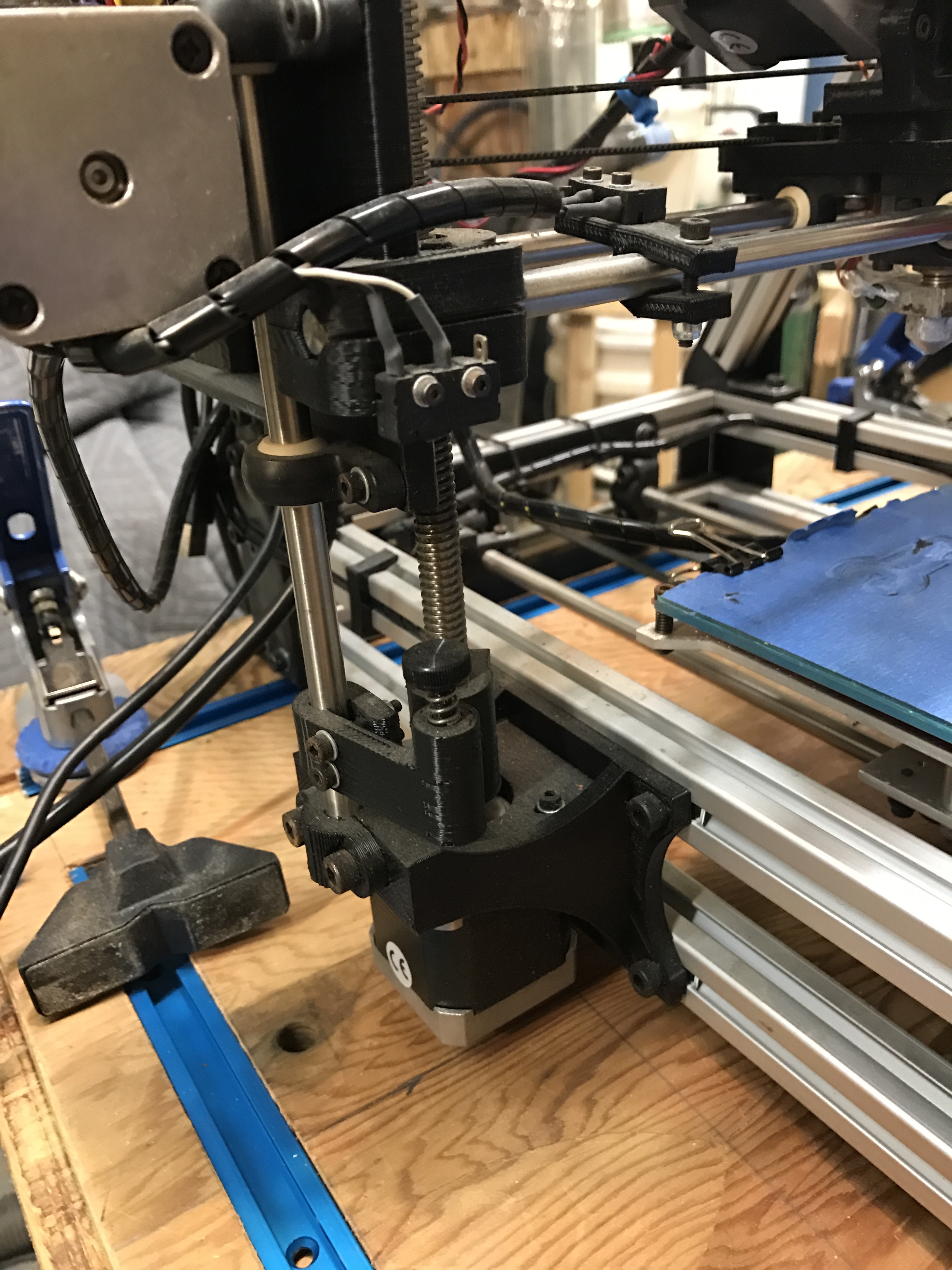

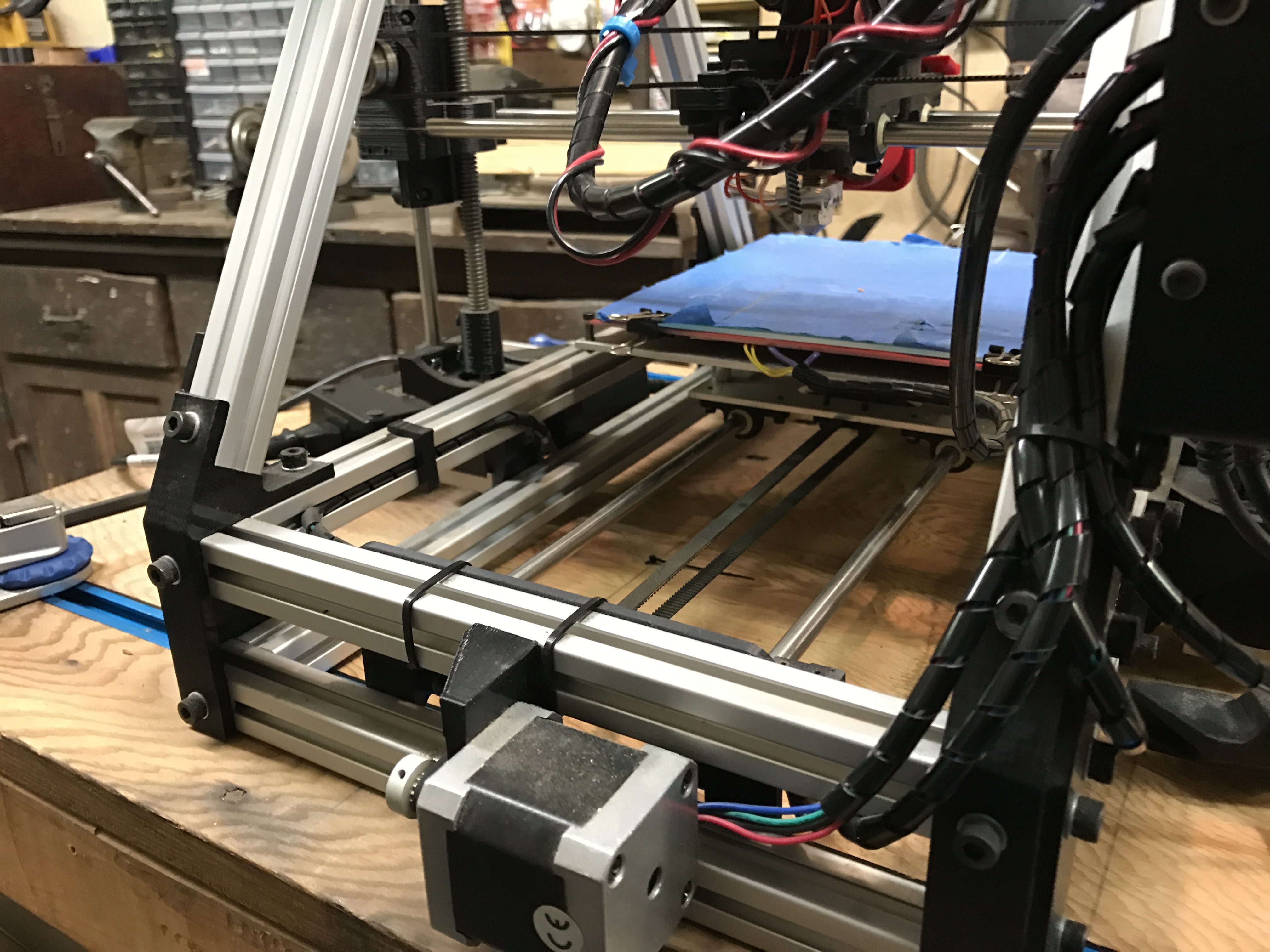

Here are some pics of the printer. I hope this helps!

Ok got the 3 mm PLA loaded and I got it to extrude some. I believe I set the height to the bed correctly and checked all the home buttons and everything seems to go to the proper place. Now I just have to figure out how to get the files to load properly in Printrun. Look at the video link or the pic that shows that above. I found the file to set Slicr and I am trying to go through that to set those parameters because it is a txt file and Slicr doesn’t like those.
