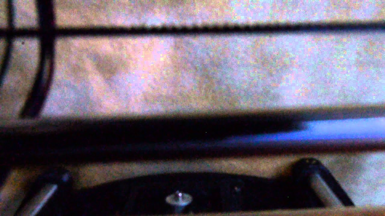

Here is the fan with the new screws and its wiring harness finished:
As you can see, with the 7mm fan and the pan head screws, there is plenty of room. This is fully homed on X:
