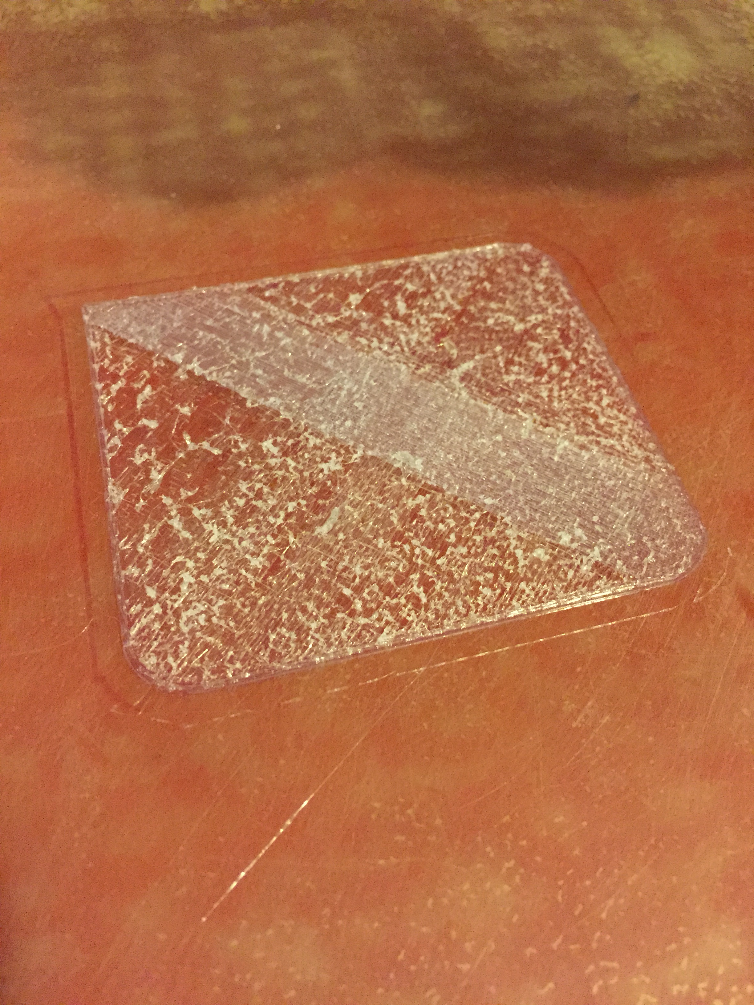

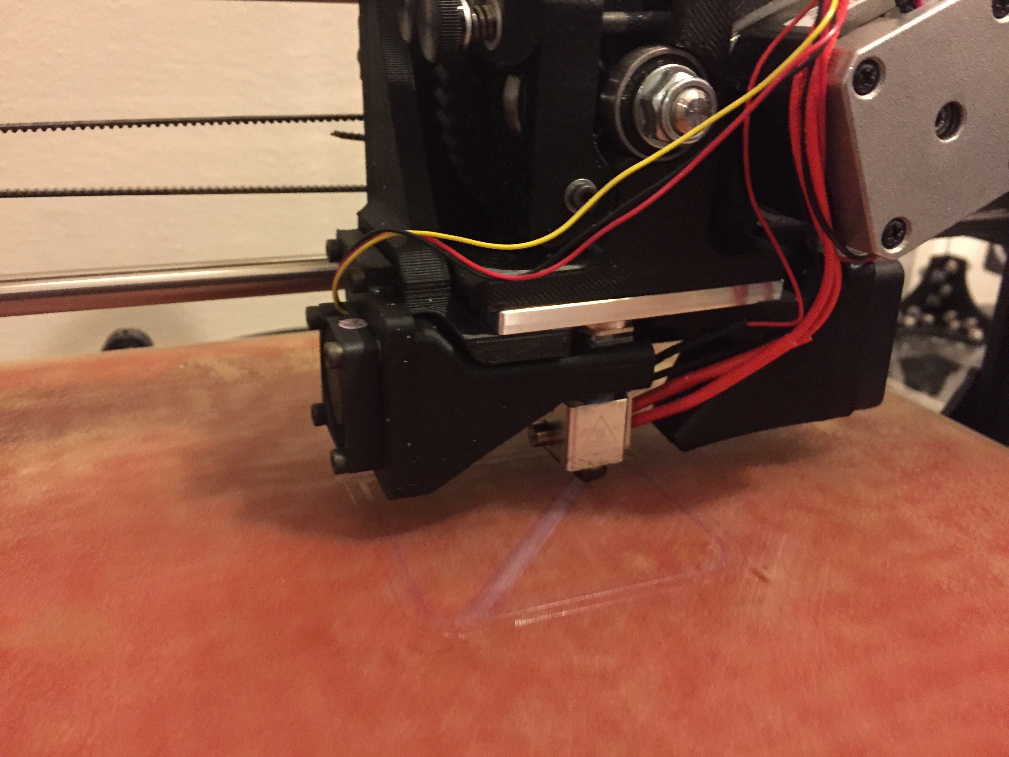

But unfortunately Still no luck with PLA.
I don’t know what else to try. ABS prints are fine. Check this dice tower printed on Black ABS.
:cry: :cry: :cry: :cry: :cry:
Bummer. As I said, I don;t print a lot of PLA but, with one exception, its always printed for me, even with the tiny squirrel fan. I always got way further than you did (in the image, looks ilke it stops on the 2nd layer). My only mess happened about 2" up on a tall build. All other PLA prints went fine. But no really big ones.
Because you can’t vapor smooth PLA safely, I rarely use it.
