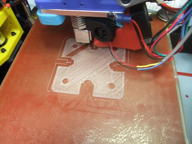

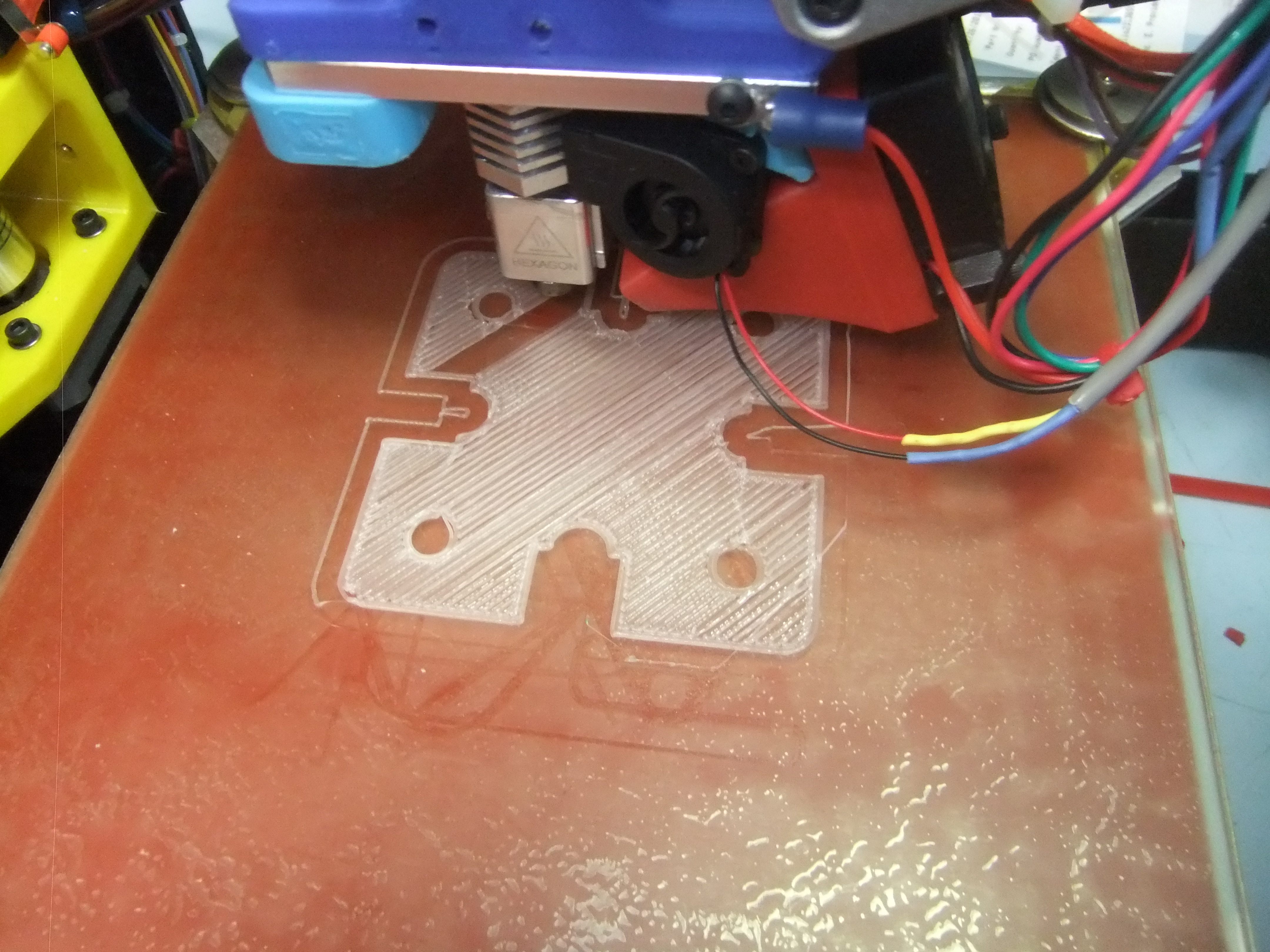

Today i printed out the last set of connectors for my IGUS chain as i mistakenly ordered only two instead of three. So i made my own. The colors clash a bit, but whatever. Right now functionality takes priority over aesthetics. I’ll probably print a black one out at some point when i have black filament.
First printing photos:

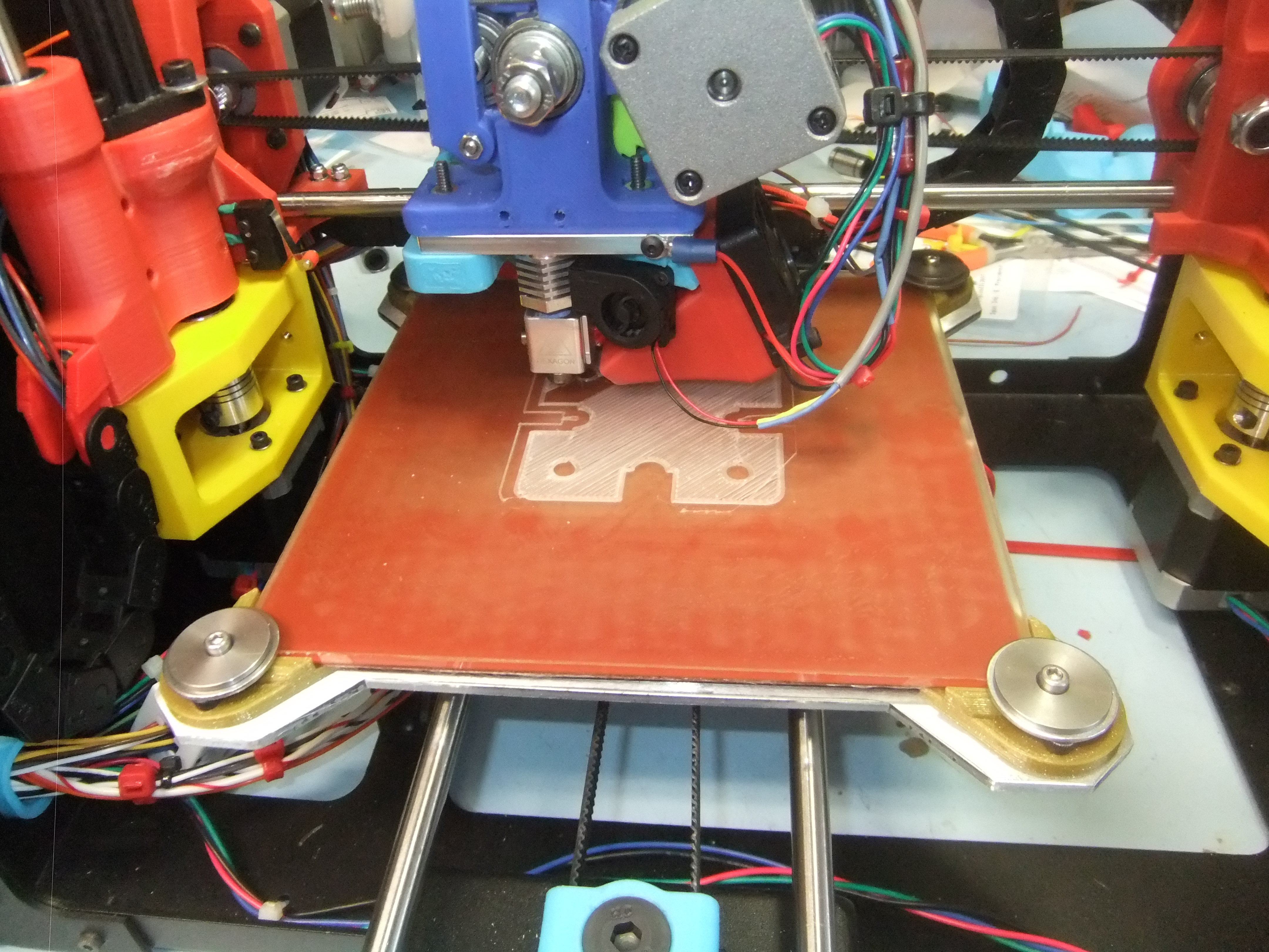

I’ve solved all major issues with my DIY homebuilt Lulzbot Mini. I fixed the bed leveling issue for the most part, although my printer has still been starting too close to the bed when starting and the filament is unable to get out. I “fixed” this issue for now by placing some extra washers to increase space between the washers and the bed. I also fixed that very bizarre geometry issue where nearly every print was printing way off center and off to the left and other crazy skirt behavior. It turns out i needed to connect my ferrite toroids to eliminate electrical interference. I honestly thought i had a bad board, but that was the only thing i hadn’t tried.
This is the first time i’ve used PLA, so i’m not sure if the minor issues are from this printer or if that’s standard PLA fiddling. Printing has a few hiccups. Mostly the PLA coming off the bed mid print, even some warping this last time. Not sure if that means i should try the gluestick method or turn the fan off for the whole print. But anyway those are print issues not related to hardware as far as i know. changing the heat settings to 220 seems to help the PLA come out at a more constant rate. Perhaps the esun filament is just not even diameter?
The good news is that it now works enough that i can now print test pieces! The first object i printed was the example / logo from OpenScad. Once this thing is working better (if that’s possible) i will print out the octopus that the Lulzbot printers ship with just for kicks. Do factory made Lulzbot printers come fine-tuned? Is there a way to fine-tune mine without reflashing some custom firmware?
