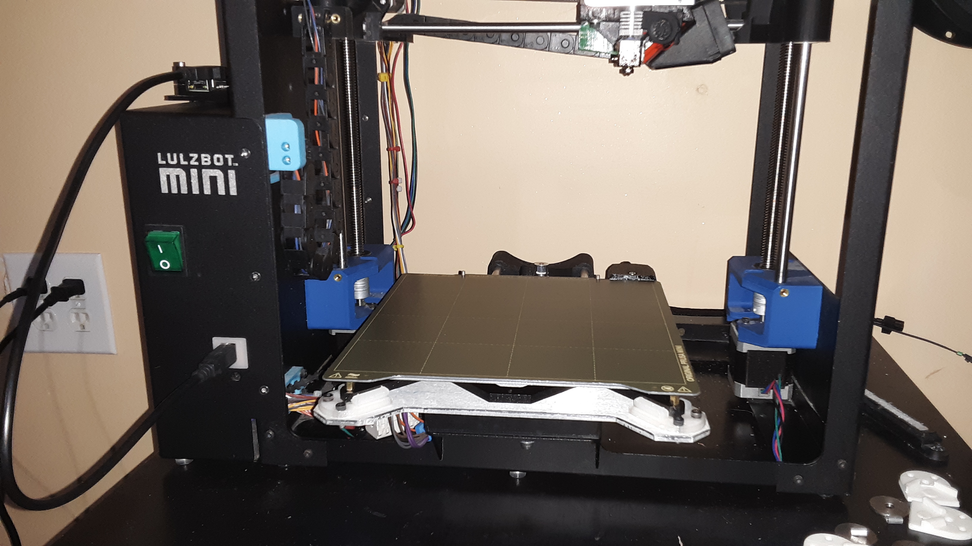

Homebuilt Lulzbot Mini

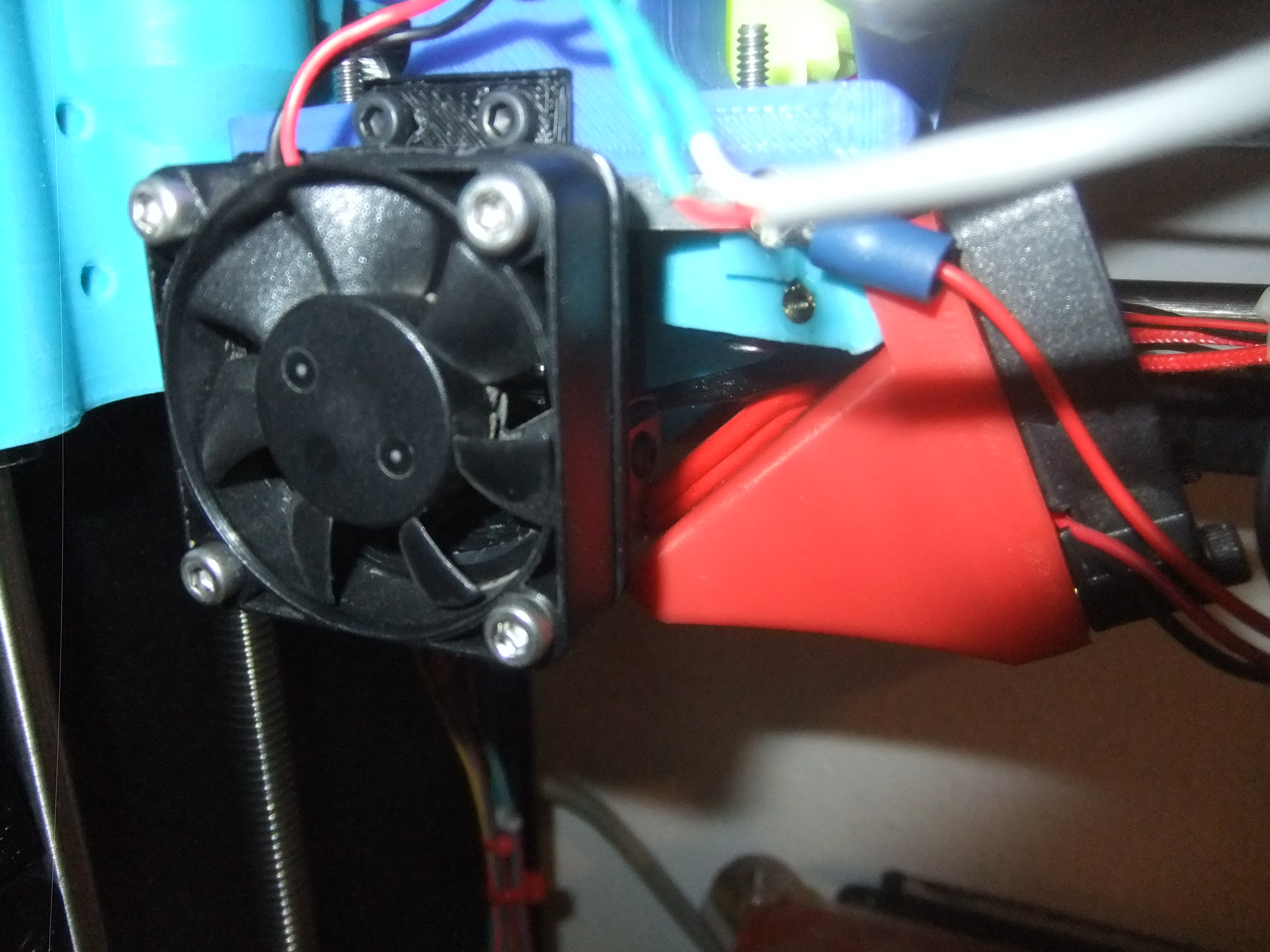

I just modded my mini to have a 40mm fan instead of the mini blower which just isn’t adequate for me as i’ve been having lots of heat creep issues both on PLA, but also on HIPS.
So far it seems to have eliminated the heat creep on my large HIPS prints. Haven’t tried it on PLA yet. I put it on Thingiverse for those who may want to do the same to their mini.

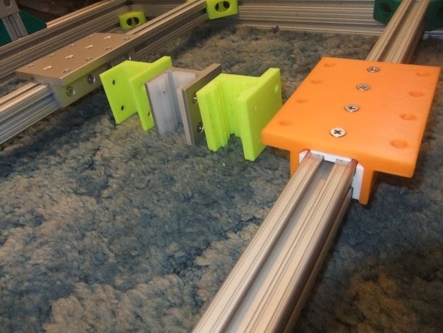

The material is comparable to these i got for my linear t-slot bearings (https://www.amazon.com/80-20-Brake-Ready-Bearing/dp/B01LQW6Z5O/ref=sr_1_1?ie=UTF8&qid=1477010561&sr=8-1&keywords=bearing+Pads+used%3A+80%2F20+Inc.%2C+6490%2C+10+Series%2C+Brake+Ready+Bearing+Pad+White) which are made from self-lubricating UHMW. This stuff looks and feels like the same stuff to me.

I am wanting to upgrade mine to a lulzbot 2. I’m seriously thinking I will upgrade my bed to a prusa mini bed since I’ve already pre ordered a prusa mini and can get spare parts now. Also I crunched the numbers, it’s actually cheaper for me to buy a prusa mini bed that is magnetic and flexible than getting a lulzbot 2 modular bed replacement. Since I have a cracked glass bed at the moment I think that would make a nice upgrade irrespective of any other changes.
Keep us posted on that! I’ve been working on a flex bed myself. Right now I bought a PEI powder coated spring steel bed that I cut, but it’s too think to mount with the glass.
Making some progress on this! Turns out it may be a really easy mod if you don’t care about automatic bed leveling. but I’m planning on upgrading my electronics and switching to a bed leveling probe eventually on mine. More details on my blog.
