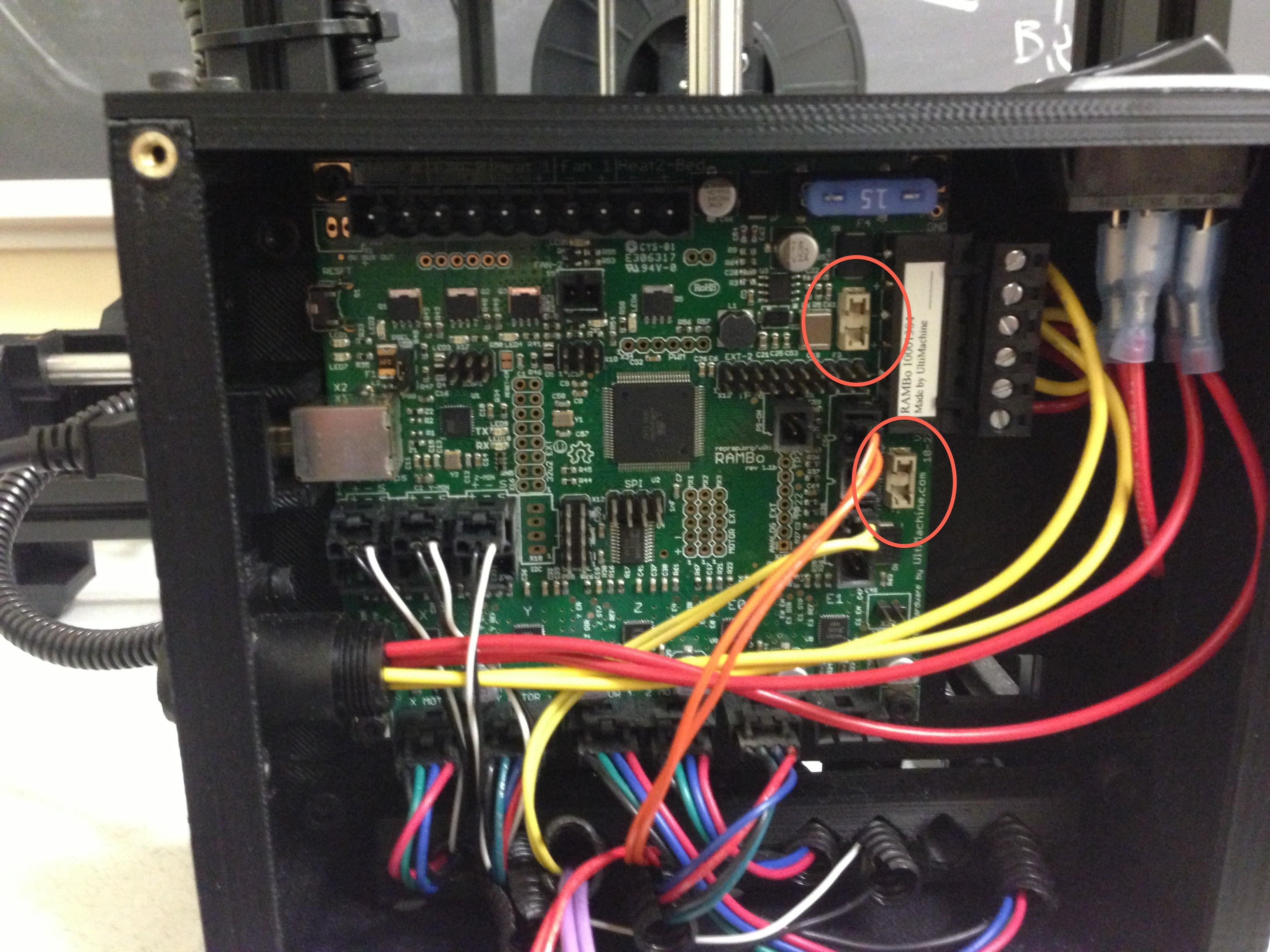

we have been working on the lulzbot TK-0. for quite a while now.! it printed pretty well for the first few prints.! the problem which we are facing now is the hotend/nozzle no longer heats up.! when we checked the thermistor connecting wires (2 orange wires) and the heating wires to the wire wound resistance (2 red wires) they were all fine.!! now, towards the end what we figured out was the “heat-0” slot in the RAMBo board was not supplying any voltage of current.! (checked with the help of a multimeter)…
WHen we followed the schematics of the circuits of RAMBo heat slots we found that none of the devices in the circuit including the resistors and the led had no voltage between their terminals.!
what could be the cause of this malfunction of the heat-0 slot.?

I spent a lot of time tracing the heating issue. I recommend that you test for continuity across the fuses before you spend too much time checking wires - I would have saved myself a bunch of time if I had gone there first. The LulzBot team did a great job assembling the printer and, if you were careful not to damage hot end wiring, the components are very robust, so fuses are a likely culprit.
I think I blew the fuse when changing the nozzle (this is just a hypothesis). The hot end was active when I attempted to remove the nozzle. The temperature was at 230 C. I pulled the filament from the extruder than removed the nozzle using an adjustable wrench to hold the heater block, and the toolkit wrench to remove the nozzle. Both wrenches were at room temperature. I think the resistor could not keep heat in the nozzle and ended up drawing too much current - blowing the fuse. I may be completely wrong about this - if I am, someone please correct me. As a precaution when changing nozzles, you may want to heat the nozzle, then switch the heat off - maybe this is obvious - being a newbie I had no idea.
So, after finding the problem - I was a little dejected to learn I was out of commission until my digi-key fuse order arrived. Order some of the fuses so that you don’t have downtime.
So, here’s the worst part - I went to put the fuse back in the holder and I found that I had damaged the holder by accidentally grabbing the metal of the holder with my needle nose pliers when I initially removed the fuse. I added the fuse holders to my digi-key order!
See the fuse holders in the picture below -
If you have a blown fuse - take your time, grab a flashlight and a thin pair of pliers and make sure you only grab the fuse. I sheared some of the metal off and trashed the holder. I am lucky enough to have a hot-air rework station available to me that I can use to correct issues like this. The fuse holder is a surface mount part that has very little room to apply heat. I have ordered the fuse holders, and additional fuses.

Note - the fuses included with the fuse holder are slightly different than the recommended 448 series fuses. The 451 series fuses may be newer. Both are fast acting 5 A fuses. I will try both and let you know how it goes when I repair the board.
I repaired my RAMBo - replacing the fuse holders was difficult, but I managed. Back in business. As far as I can tell, the differences between the two fuses (part numbers listed above) is minimal.

4. Does the board output voltage to the bed and/or nozzle heating element? There are 2 LEDs near the output pins that should light up when voltage is applied. You can also set your multimeter to DC voltage and measure the output.
If the board does not output voltage, you may have a blown fuse. The fuse is there as a fail-safe, so if it has blown and it’s not a faulty fuse, chances are there is some other issue that needs addressing or it will just blow the fuse again.
