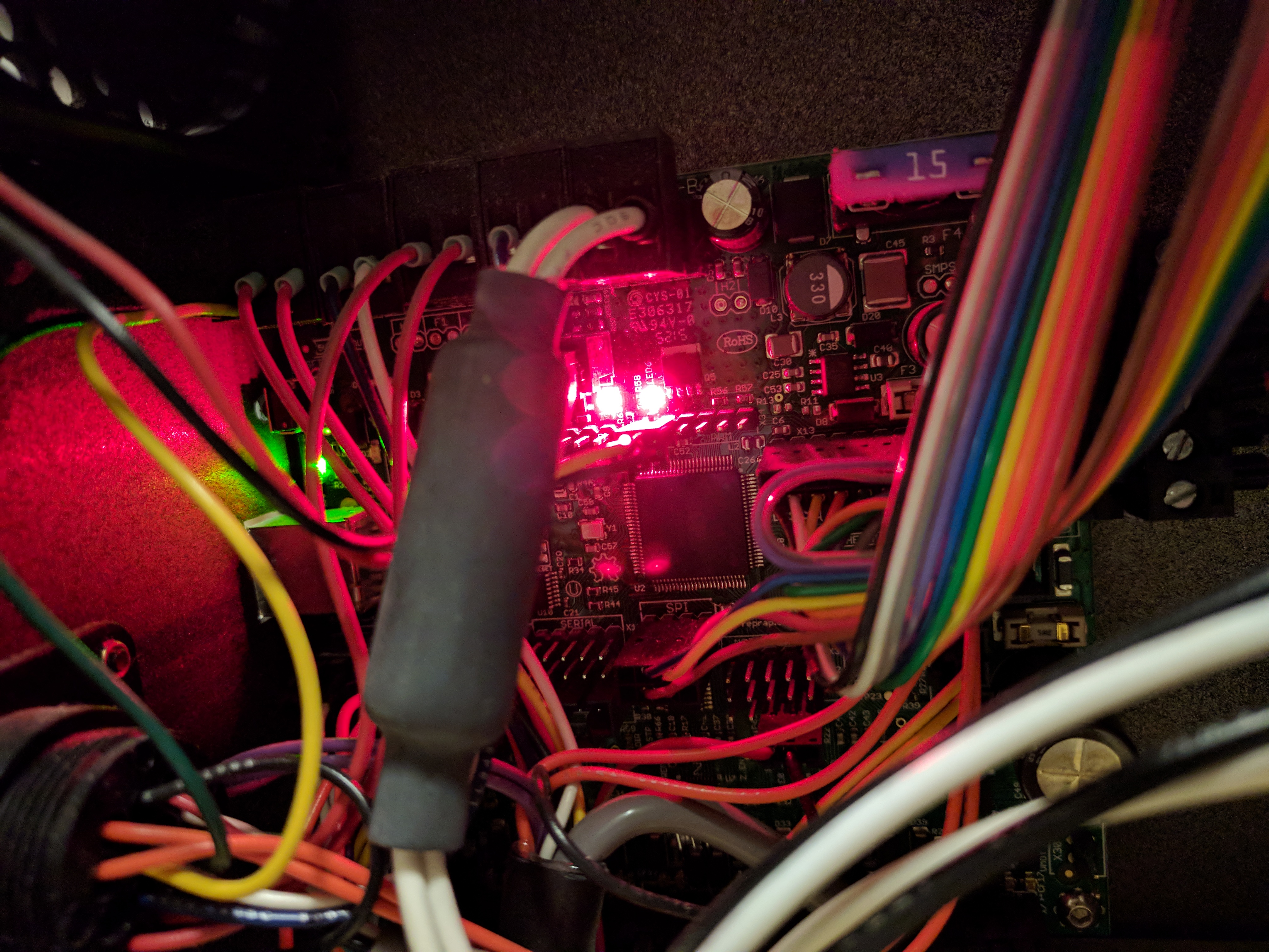

Blinky Heater LED:

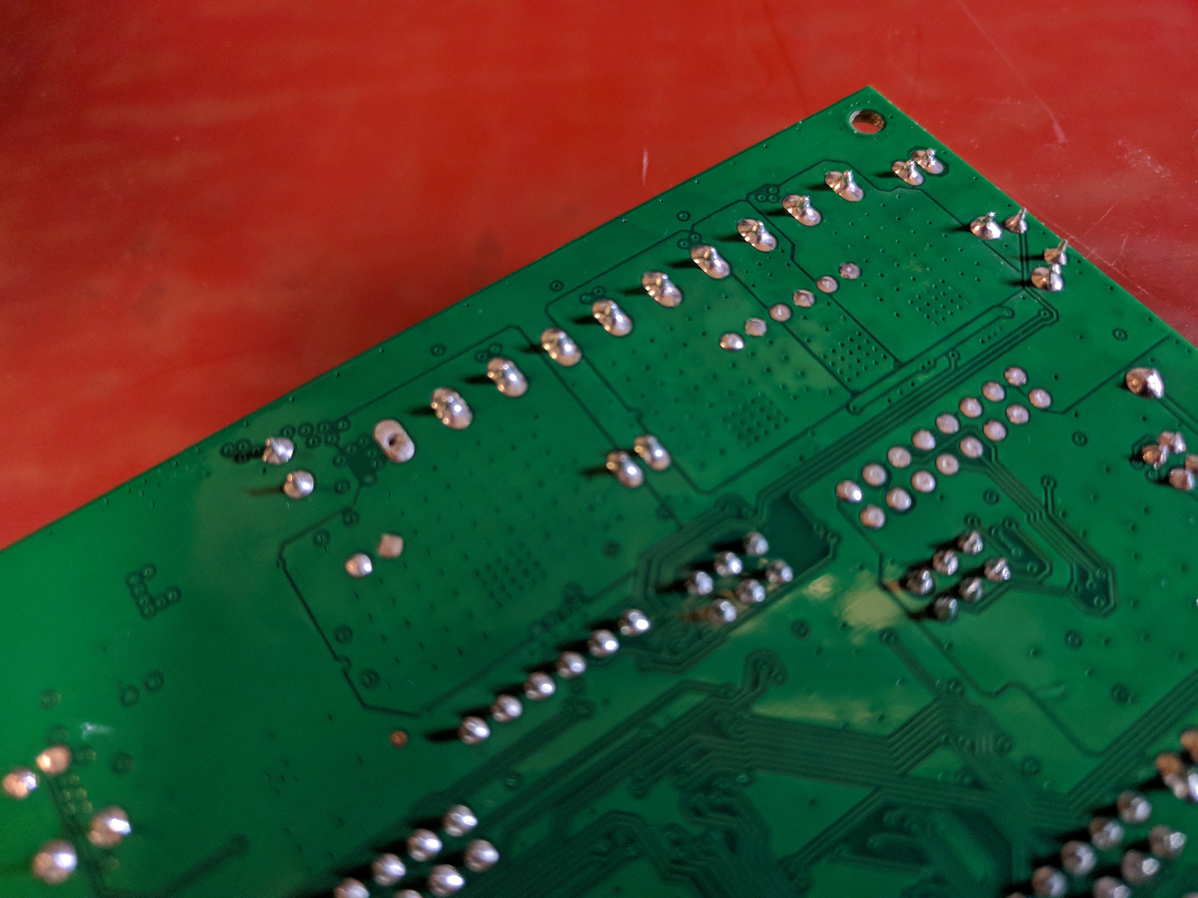

I replaced the RAMBo and after examining the old one, I found that the right pin for the heater wire was melted off of the RAMBo. Pretty scary/surprising stuff. It’s possible to fix, but just wanted to add this info for those of you looking for solutions at home.
Thank you for all of your help. Pictures below for the curious.
Note the long pin on the right of the long black connector - it is marginally melted off the board. :unamused:
From the back you can see the solder has been melted on the leftmost solder pad in the line of through-hole connectors for the black connector. Crazy that those pins get that hot. Perhard the connection was just not quite good enough and heating up with all of that current passing through? :open_mouth:
If the blinking L.E.D. goes out when you plug in the heat bed then the F.E.T. if not then your wiring to the bed. The ~0 volts when plugged in says the ground side of the bed wiring is working, but the 24 volt side is not.

Thanks for the quick reply, kmanley57!
The light keeps blinking when when the bed is plugged in, so i guess the mosfet is okay.

But it sounds like you just are not getting the power to the bed. (Wires) The L.E.D. would go out if the F.E.T. was not working right. The L.E.D. is across the output of the FET, so if you connect the bed and read ~0 volts and the L.E.D. is still lit then you have a bad bed wire somewhere between the control board and the bed. If you read ~0 volts that would say the ground side of the bed maybe OK. You will read voltage with a high resistance wire(AKA - broken wire that just touches enough) but get no current flow(AKA - no heating). which is what you are describing.
