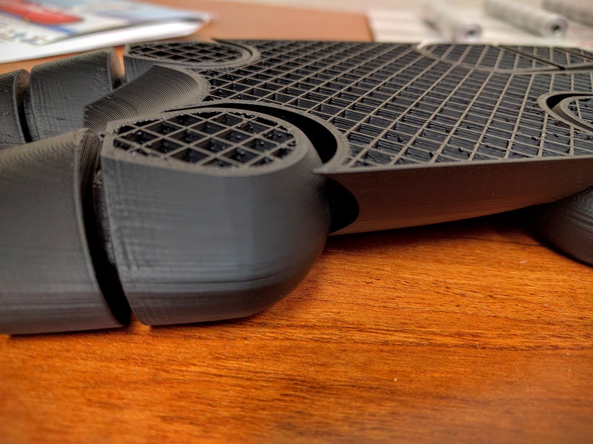

The big one is a max scale TAZ 5 .5mm print done in a sample of PLA we received. The internal structure is cleaner with ABS. Here’s a LFS “Geant” Elephant print that got killed by a power glitch (I thought it was plugged into the UPS…)
how much space do you need to leave between the parts in the joint?
I find .7 for perimeters (XY) and 1mm for top and bottom spacing works well for “print-in-place” axle / post designs… like the maker faire robot above. You can get tighter tolerances, but they may not work universally on all machines… for instance if you’re planning to share on thingiverse.
If you are designing for just yourself, try using a multiple of your extrusion width X/Y gap, and a constant .75 to 1mm for Z gap. Start with 1. If its too tight (axle is frozen) try reducing your flow rate / flow multiplier to 5% lower. If joints are still frozen, try going to a multiple of 2 times the extrusion width for the X/Y gap… for Z gap stick with .75 to 1mm.
The Z is a larger gap, because it will be printed without supports. So a single layer height for gap may stick too well with the last layer. Using a multiple of 2 should prevent the layers from sticking together or freezing.
Here’s a print-in-place camera mount that swivels that I made for my TAZ: https://www.thingiverse.com/thing:949219
For round joints like the elephant figurine above, you’ll want a consistant gap all the way around… .75 to 1mm would probably be universally good.
