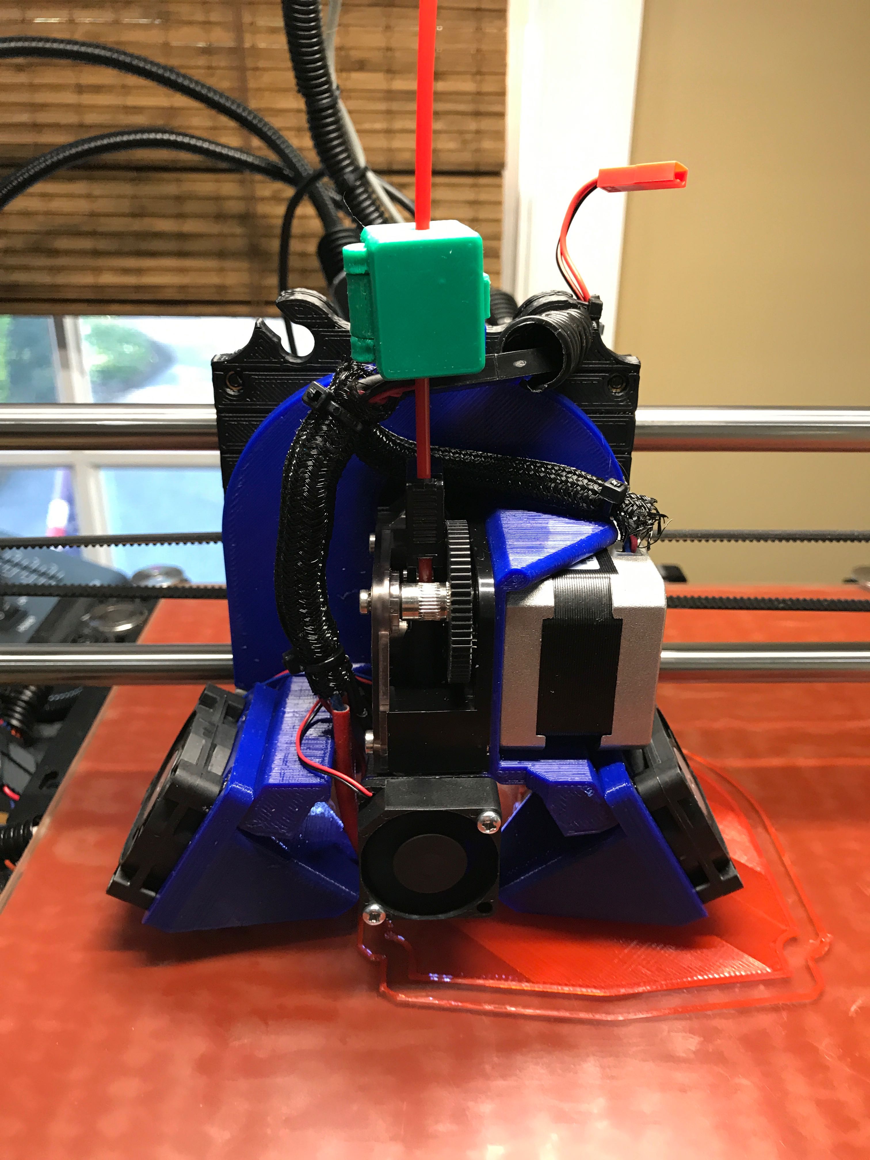

I designed a E3D V6/Volcano toolhead
Untested, still wiring mine up.
http://www.thingiverse.com/thing:2197238
For the smaller stepper motor, let me know what current you end up using. I have problems with mine overheating.

I haven’t messed with the current yet, although I do run @ 1.5A on my Smoothieboard i3 E3D setup with a pancake. Whatever is stock in the Single Extruder firmware skips/stalls easily. As for overheating, it comes down to if your mounts will melt. I heard most steppers run hot in industrial settings, too hot to touch. YMMV.
Got mine running too…
