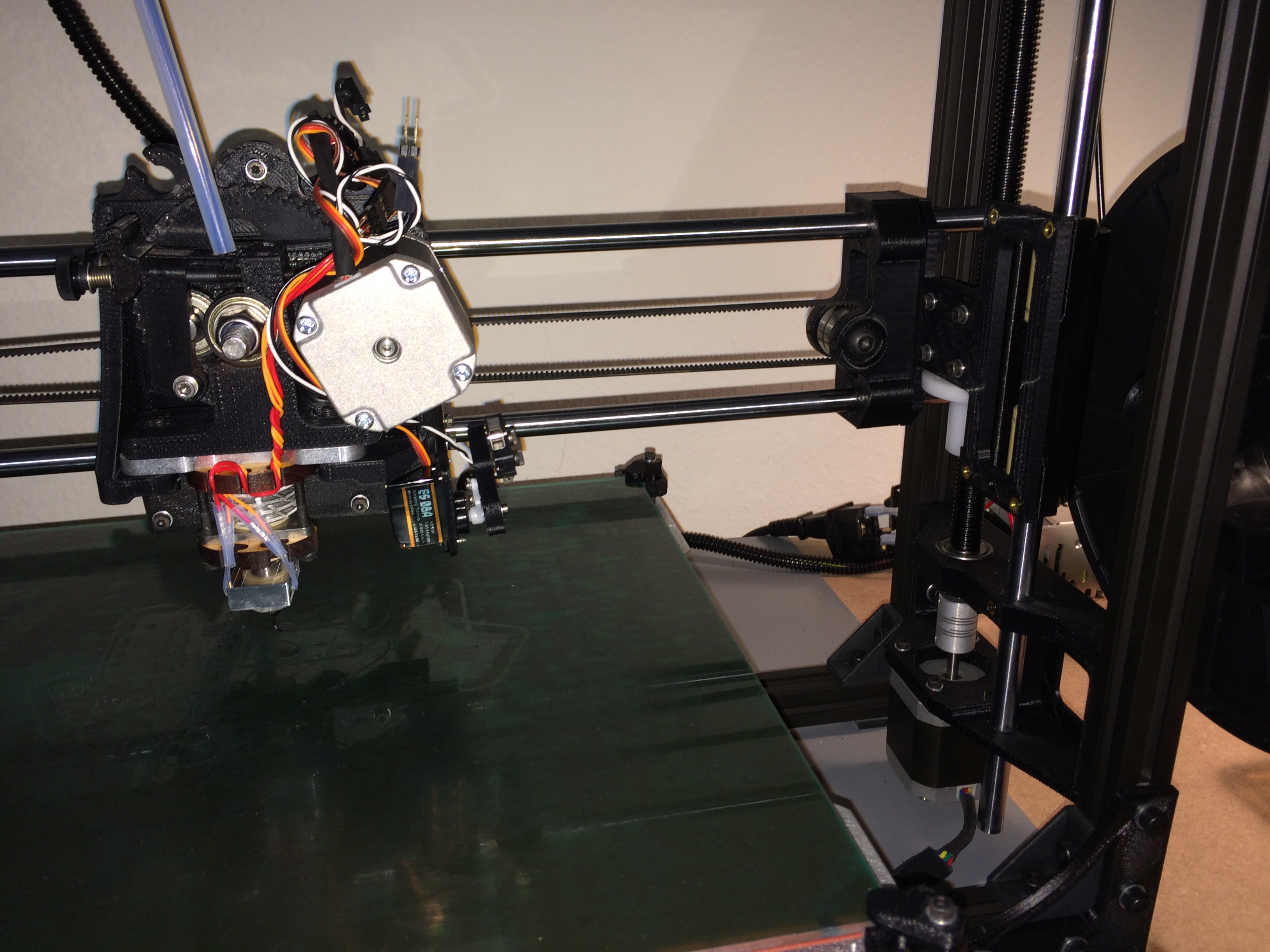

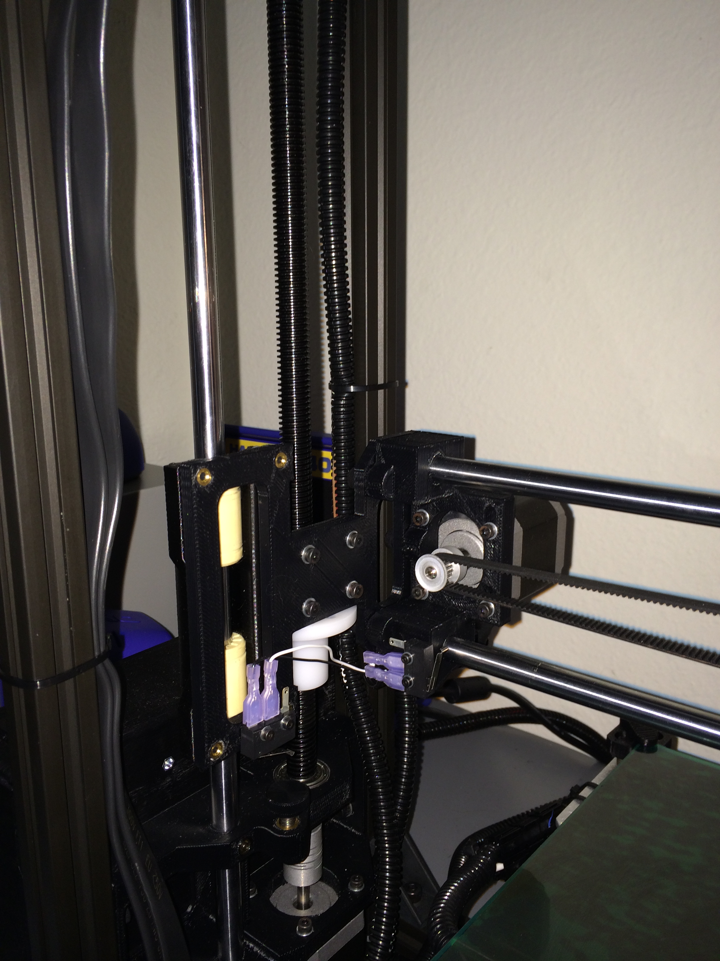

Lead screws and a change log!! I will be updating to this Z axis configuration.
Haha couldn’t have said it better myself…
I have already updated my custom built Taz 3 to the new Z axis config. I think the upgrade is definitely worth it. Here’s some pics of my z axis.
That looks great! Did you get these from Misumi? I went to look at buying the parts from the BOM and while I found the leadscrews and resin nuts, it looked like the GSASL16-5-5 couplers were discontinued. Is CPSX16-5-5 the correct replacement? These parts definitely aren’t cheap in small batches and I don’t want to get the wrong ones. ![]()
I’ve got my upgrade parts printed, but I haven’t figured out where to go buy the leadscrews from yet. It’s on my list.
Yes I purchased my parts from misumi. The CPSX16-5-5 couplers should work fine.
