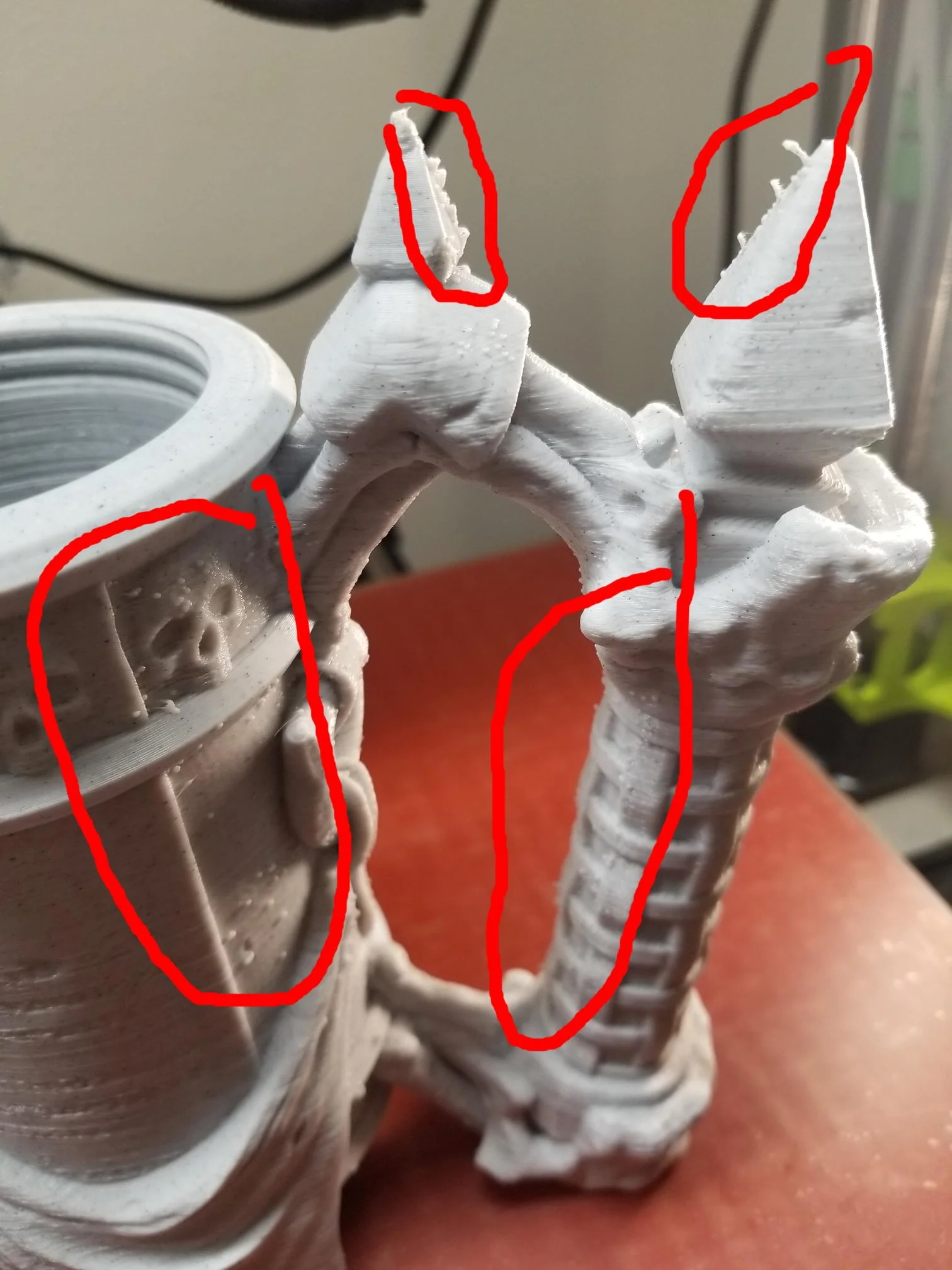

Issues with "zits" when the printer goes over open areas
Printing a few mugs with handles and I can’t seem to keep these “zits” from showing up.
They seem to originate when the extruder moves from one area to the other across an opening. It seems
to ooze out after leaving one side and deposits the “zit” on the side it returns to. The issue is more apparent in this image on the left side but both sides are equally zitty. The top section is even more pronounced between the two pyramid like structures.
I’ve got the same issue printing with PetG or PLA. In this example it was marble PLA.
I tried reducing the retraction and reducing the temp down to 195. This changes made no difference.
Printer is a Taz6 Lulzbot.
0.5 mm nozzle.
I am using the CURA LE version by Lulzbot
20% infill
0.2 mm layer height
wall thickness 1.0 mm
wall line count 2
Printing temp 205 C
Build plate temp 60 C
Print speed 50 mm/s
Retraction distance 8 mm
Retraction speed 15 mm/s
z hop when retracted disabled
regular fan speed 80%
No support
Would enabling the z hop help with this issue?

Usually it seemed like it oozed out during the travel across open areas which it then deposited on the leading edge of the other side. Looking at the top pyramids though, that looks like it was left as the extruder left that section.
“What is your non-printing move speed set to?” Is that the travel speed? I don’t see a non printing speed. The travel speed is set to 175 mm/s. This is using CURA LE (not standard Cura)

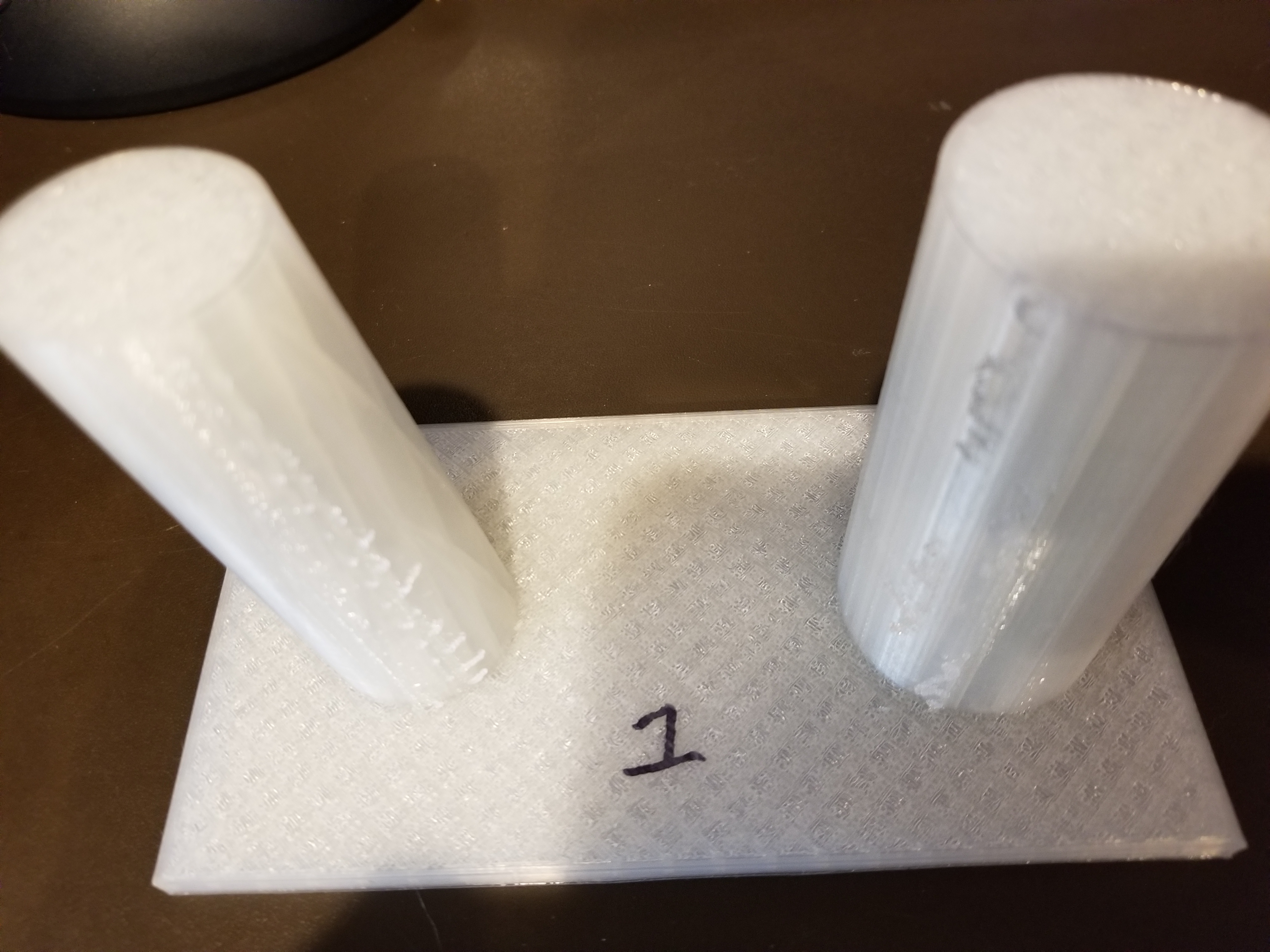

It’s PLA. I printed a test to replicate the issue which did result in the zits and other issues. I am going to print the next example with the settings recommended above and I will post the results. The PLA could have had moisture too. I have a filament dryer that I will try after if the next print doesn’t show improvement.
Print #1 (hopefully shows the issue) This was made with the original settings I used before

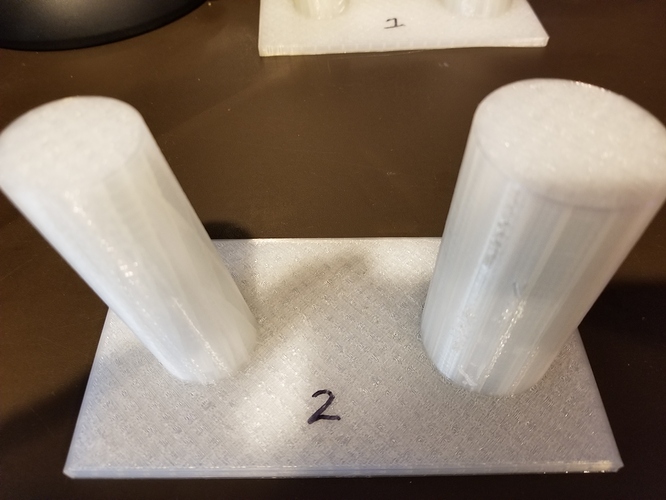

Print #2 Issues much improved again maybe hard to see. One small booger on the right but no zits at all on the left side.
One thing I noticed with this filament (transparent PLA) was the filament kept breaking and showed fractures. I assume this might be due to moisture so I am going to dry it overnight and make a third print.

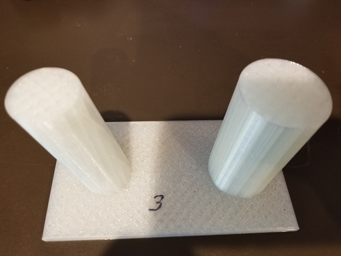

Third and final print. This was after the drying overnight and the settings recommended above.
Not a single zit, string, booger, nothing. Just nice and clean.
Thank you for the advice it really made the difference!
