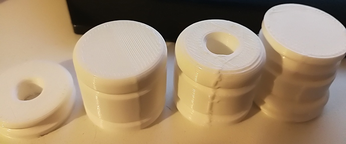

Heres a picture of some of my cylinder prints,
i noticed it doesn’t really extrude good when it starts printing the outside brim? test round around the thing im gonna print, it drops a tube like line instead of a flat line. it drops a blob and takes it with it to the original print so that’s really annoying.
and it seems that my head extruder is making almost a full circle and then bumbs and goes backwards again leaving a ridge on the outside of my prints.
i have used the standard setting in cura for the verbatim, polymaker and village plastics that give me various printing temp. but they all don’t give me a good result.

Your prints dont look bad at all actually.
You just need some info…
When I look at your pic, it looks like your esteps (830) for your extruder look like the stock settings for new uncalibrated firmware. At the factory the extruder was calibrated. The correct esteps for your extruder is on a sticker on the back of your extruder, or in the paper work that came with printer. Find it and enter it in firmware. If you can’t find your original paper work, you can calibrate your extruder yourself. I bet your zoffset is also stock. So your nozzle is probably to far away from your bed.
(Seems like when you upgraded firmware you didnt copy over extruder esteps and zoffset. Tip -> reset firmware/upgraded firmware means you’ll also have to find new good zoffset)
As for the nozzle hitting prints you can change a few settings in your slicer:
Avoid Printed Parts When Traveling = checked
Z Hop Height = 0.3 ~ 1mm (experiment)
For the seams try experimenting with:
Z Seam Alignment = Random or shortest
Retract before Outer wall = checked
enable coasting = checked

Ok my experience has been different. My extruder came from the factory with a estep sticker (846), factory offset of -1.361. If I restore firmware failsafes or upgrade firmware, I must enter these values in new firmware. (sometimes if firmware has a really big jump - i need to find a new zoffset) Coincidentally 830 was always the number I saw for a new stock uncalibrated firmware.
But the bigger picture I was trying to express and help you with was 100mm’s requested, 100mm’s printed. Until you verify and test that you will chase your tail endlessly.

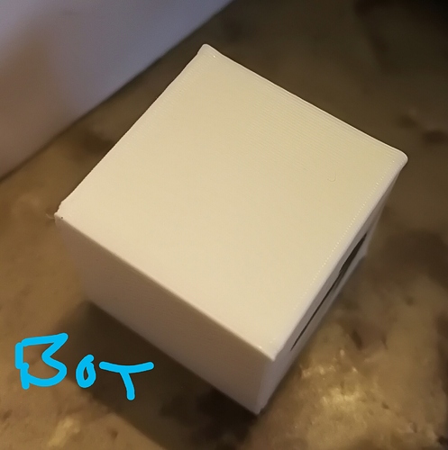

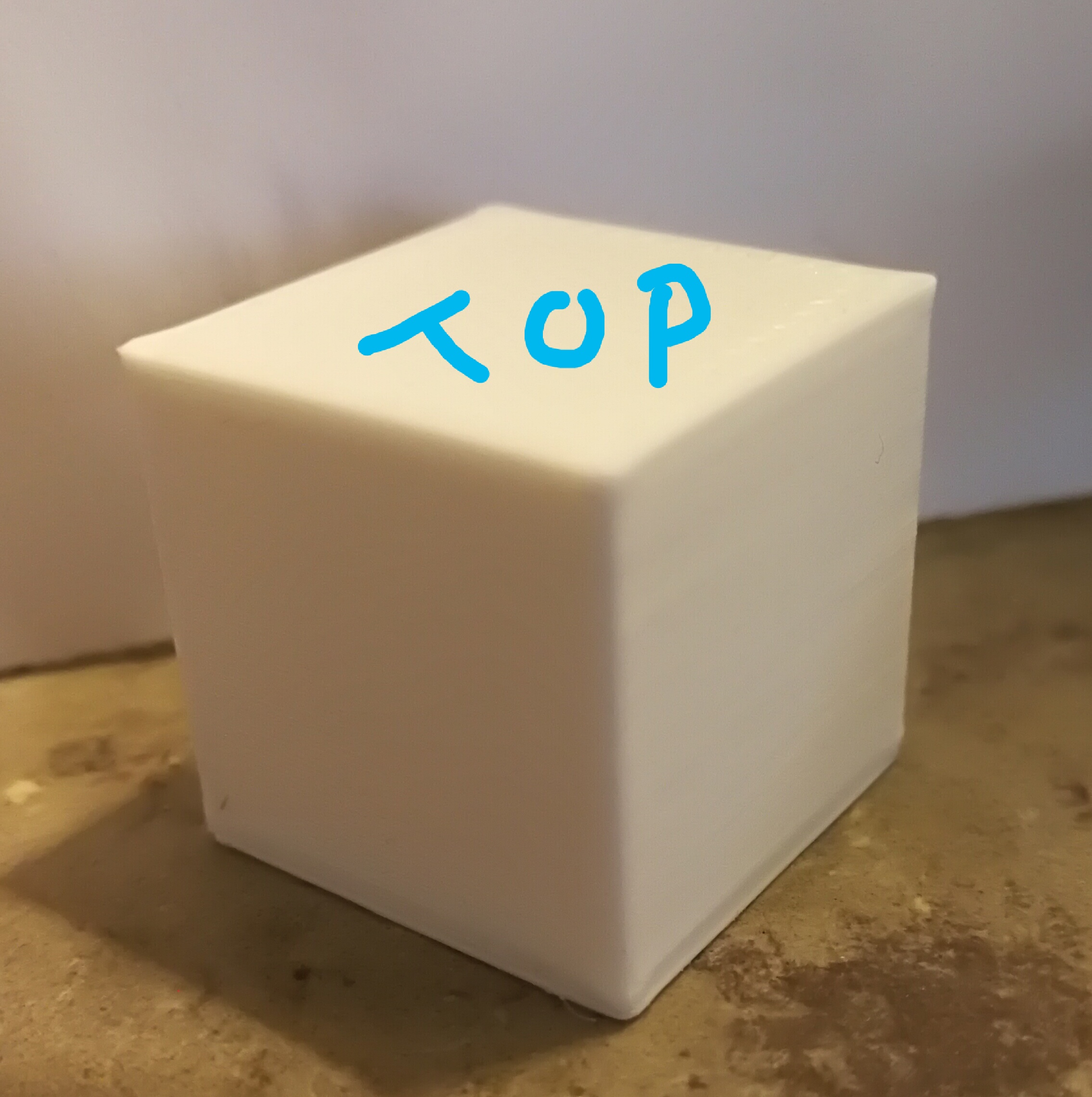

Yes, This has been a problem because my 2cm cube is 20.08 x 20.05 where the height is 20.05
you are right i need to find out those steps because for me it’s important that a cylinder will fit in a cylinder hehe

I did some tests and the print quality of the print is actually really good but i still have the Z scar or seam on the outside of my cylinder type object.
