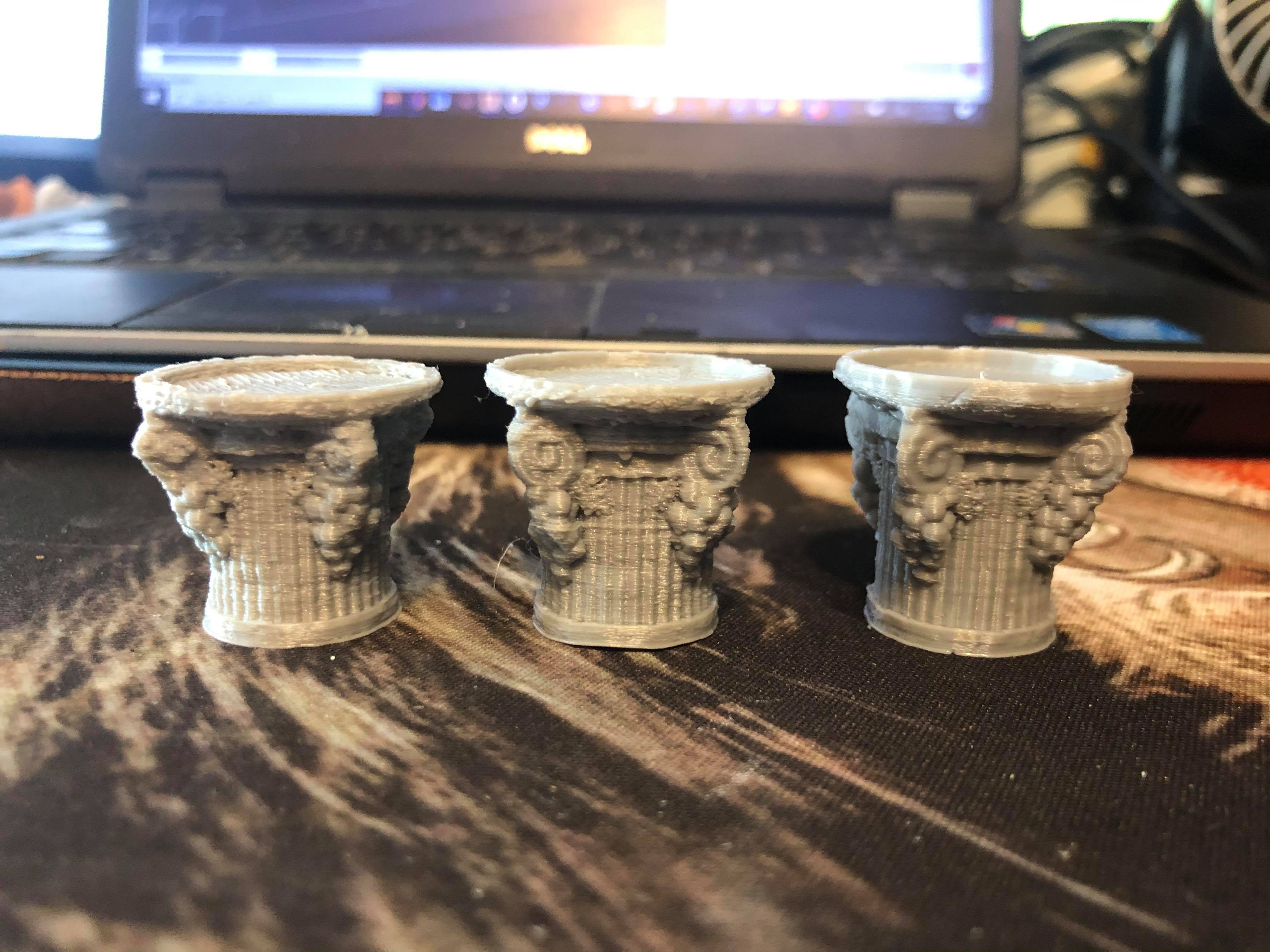

Thank you for your response. In the last couple weeks since it began to happen, I have been able to resolve the issue. However, now there is another issue. When I try to print more than one instance of the same model, I get an odd z-axis layer squish. I am linking a picture, in it are some examples. The result on the left was with 8 instances of a model, center is 4 instances, and right is only 1 instance of the model. Any idea what is going on?

The more instances you print, the longer the time between layers (on each instance). The temperature of the previous layer is also lower (more time to cool). Not sure if this explains all of the layer squish, but it may explain some of it. Providing us with more information (as @rhenderson detailed) may help us find additional things to check.

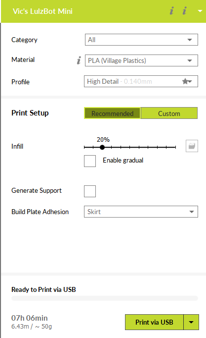

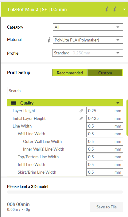

Can we get more info on what settings you are using? Some screenshots of your print set up will help. For Reference i am including a screenshot of the area im most interested in.
Pick the smallest object that demonstrates the problem and upload the .stl and the .gcode files for one, four, and eight (you can zip them together and upload that instead).
Here are the two screen shots for you. I spoke with customer support and they wanted me to print 3DBenchy in batches. So, I first printed 3, then 2, then 1, then 4. The first print of 3 models showed the binding I was typically expecting. The print of two models was much worse than any I had experienced so far. The single benchy displayed some z-lay squish, but not as bad as the set of 3 models. Last, the set of 4 models printed almost perfectly, with little to no binding. I have also attached those photos. I can also attach a zip of the gcode, but I am not sure how to do that. I am not sure where to go from here.
