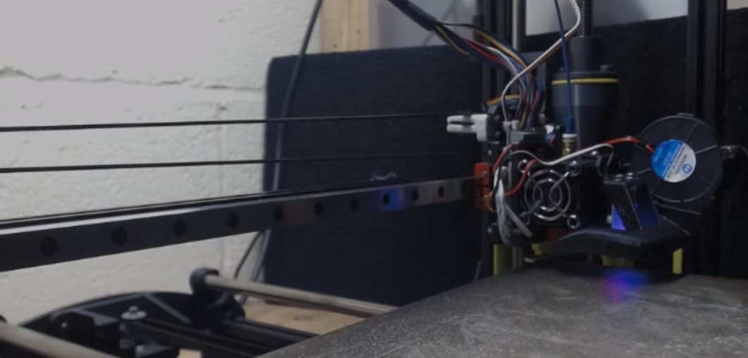

I’d highly recommend swapping the X rods for linear rail. I did it and was amazed at the quality improvement, let alone the reduction in weight. I’ve got 1515 aluminum profile extrusion holding it, and have the BTT Hermit Crab quick change plate system bolted directly to the linear rail.
I’d love to measure the weight difference one of these days.
