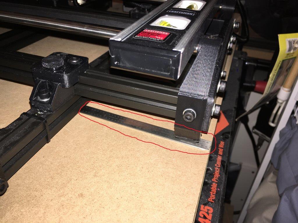

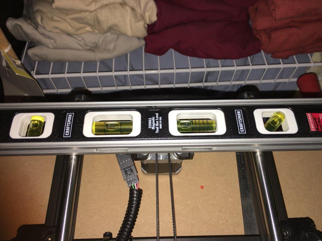

Now I was onto something. I checked the levelness of the two y smooth rods against each other (see pic 3 and pic 5) and found that the back of the right smooth rod was low. I unscrewed the four Y axis idler installation screws (circled in pic 3) and four Y axis motor assembly installation screws (opposite side of pic 3). Next I unscrewed the thumb screws that secure the Y axis to the TAZ frame (pic 4). Now the Y axis was relaxed enough for me to try to level it properly.
I had to stack two metal rulers under the back right foot of the Y axis to level the two Y rods to each other (see pic 6). The two metal rulers raised the back right side of the Y axis 0.96 mm.
Now I tightened everything back up. Alas, this did the trick. I finally leveled my bed. The first layer is now going down beautifully in all four corners and in the center of the bed. As an example Pic 7 in my post below shows the front left corner and Pic 8 shows the front right corner after performing the Y rod leveling trick. Only 6 pics are allowed per post; hence the reason for these pics going to a second post. I measured the first layer across the entire calibration print and found only a 0.06 mm difference which means the entire print bed is now level to within 0.06 mm. This is plenty good for the 0.2 mm layer heights I typically print.
